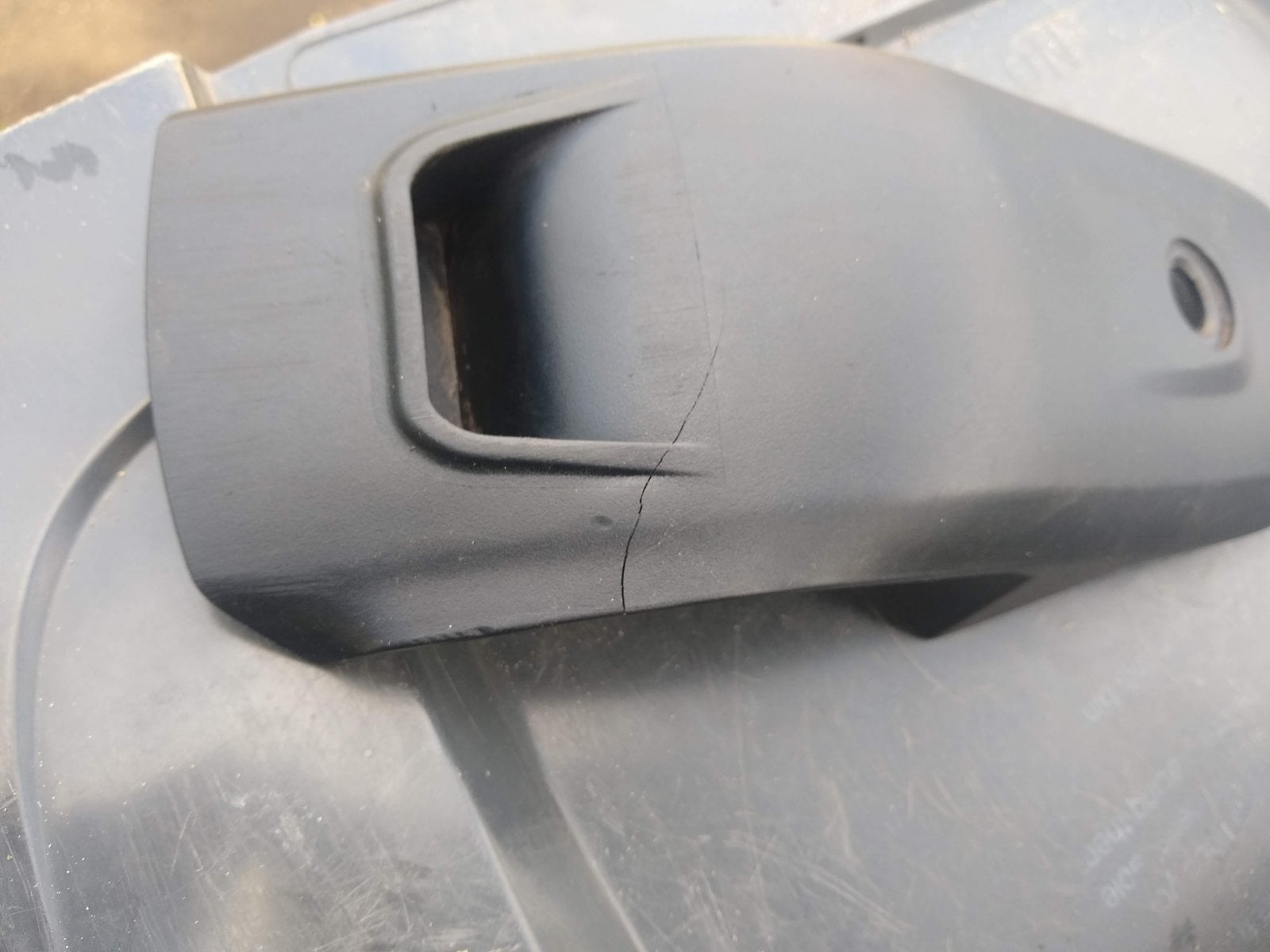

I've broken 2 battery rock guards on my 2020 Levo Comp.

Has anyone else had this issue? I think my sag was way too low and I am not careful enough but this is expensive. I've only put a couple hundred miles on the bike so far. has anyone come up with a hardening device for this area?

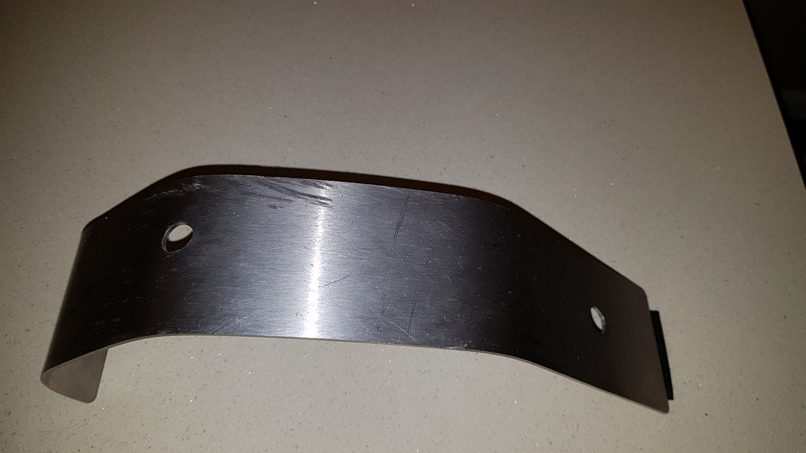

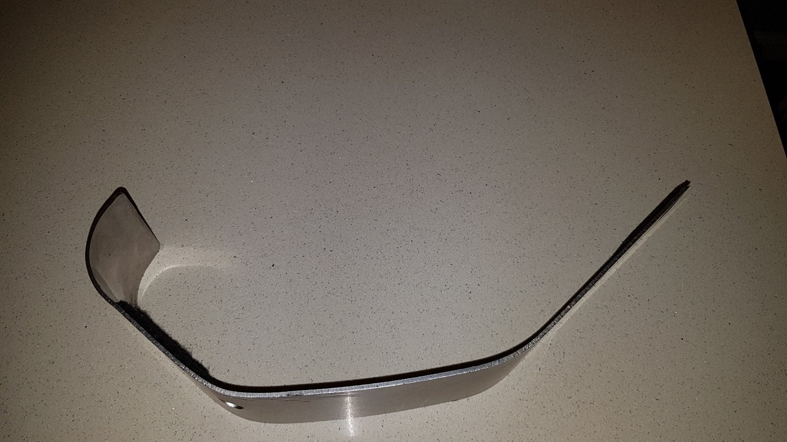

This is what I have it bolts on using the battery bolt but needs a longer bolt. Also heavy duty Velcro works as well.

I look after a friend's 2019 Levo and on yesterday's ride she went over a log or something with a resulting 'crack' and on inspection I see the battery guard is cracked, Just been told by Berkshire Cycles that a replacement costs £55! So I'm thinking the best thing to do would be to seal the crack with some adhesive, and then fit a further guard, such as the one shown by @Binhill1 above - which I'm assuming is the one sold by Berkshire Cycles for £40?
Unless anyone's got any better ideas?

Only one bolt hole you can attach other end with industrial Velcro only trouble I find is if I remove battery the glued bit comes off as it's always rainy here's so use another piece of Velcrco I used it with bolt only for 800miles and it was ok but not enough thread in my opinion . Still look for bolt M12 x 1.25 pitch 19mm the one for battery but I would get another 5mm and cut if needed. Other hole lines up with drain hole .

I made one out of aluminium.... Cost me 2 quid...gets a fairly regular bashing hopping up onto logs etc.... Was really easy to make... Can send a photo if you want.

I went over a log in my first 2 km of trail riding on my new Giant Stance-E and cracked the motor guard. It seems like it is made of ABS plastic and is about 1.5mm thick. IMHO, way underbuilt. I ended up JB Welding it back together and reinforcing the area with a 2mm thick strip of ABS heated and formed to match the OEM guard. I haven't ridden the bike since so I have no idea if it's strong enough. Good luck with yours.
Rcoley, could you upload a sketch or drawing of the guard's/bike's contour line?
thanks

Fused mine with an old soldering iron. Looks like frankensteins monster but an effective repair. Lots of generic how to's on the tube.
