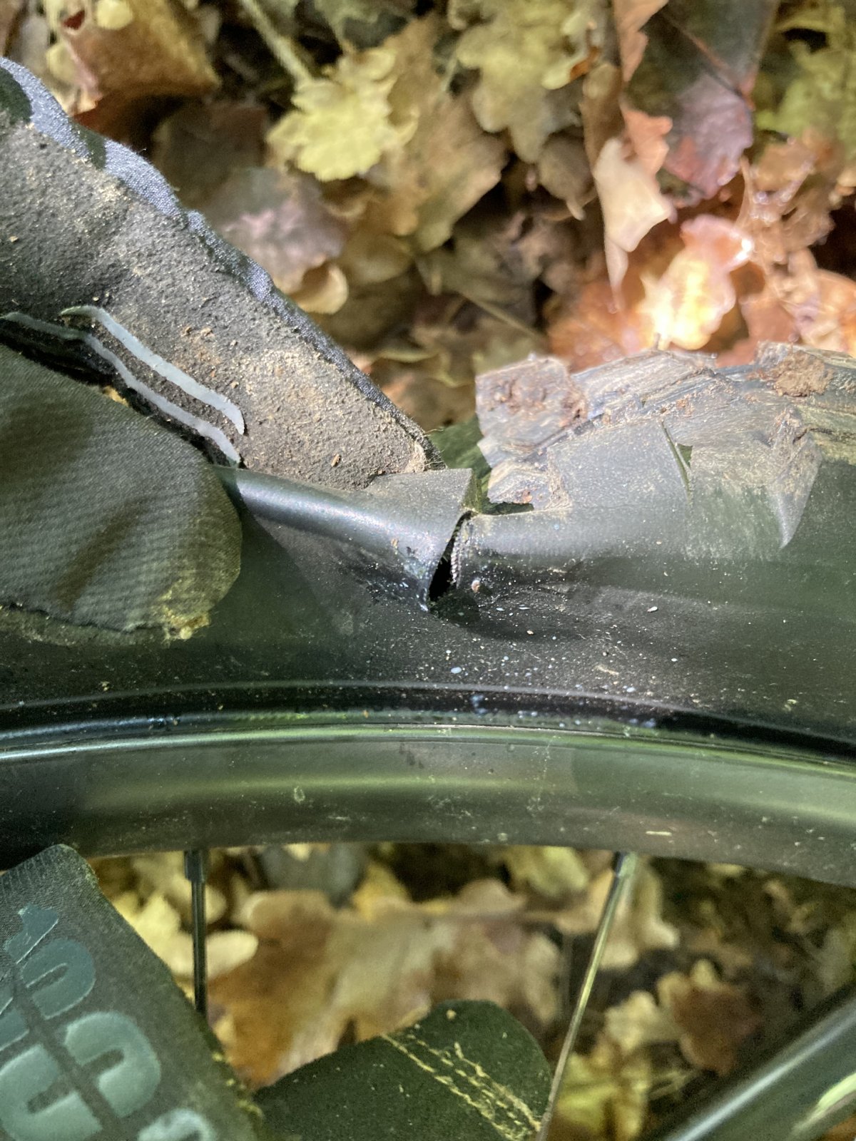

I always use soapy water to seat the tubless tyres. Just had a bad time with a Minion DHF 29X2.5 fitted on rear of my Levo SL. I know its supposed to be a front only tyre but I didnt have a Highroller II to fit and was desperate to get out for a ride. Split the sidewall on its first ride. Very unhappy :mad: Maxxis aint what they used to be!
