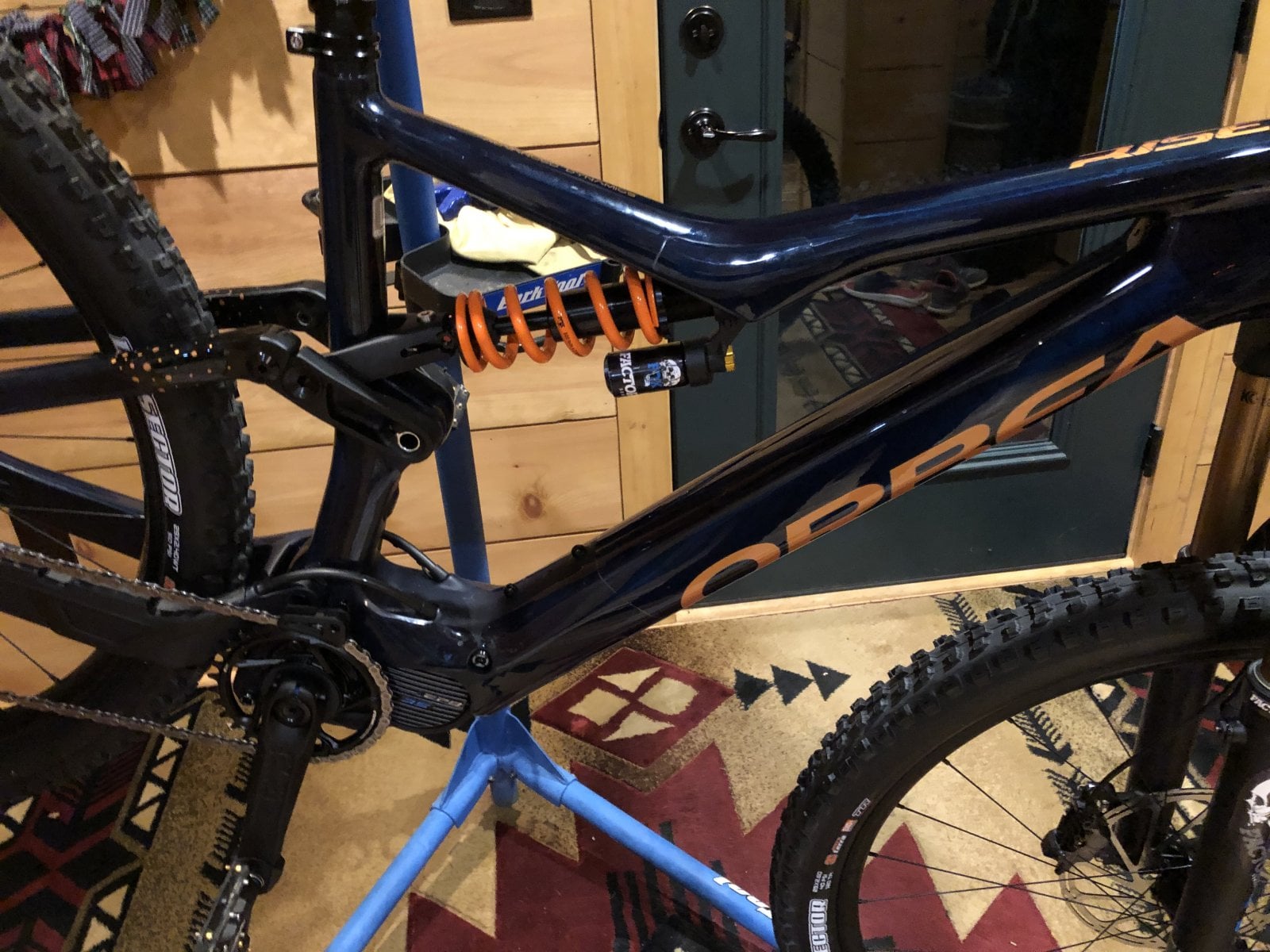

Actually the Orbea is very progressive with anti-squat characteristics which is ideal for a coil. I’ve had a top rated suspension service company look into the adaptability of the coil on the Rise and with the correct spring size it should be awesome.

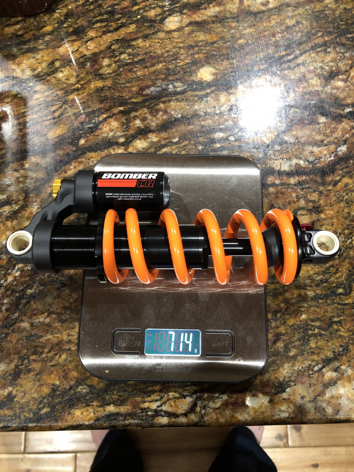

Marzochi CR w/Fox SLS spring. I put a 2.6 front tire on, 220 front rotor and cushcore XC F&R. 42.5#, my decoy was 52.5. So just setting my bike up for what I ride. I’m not sure what point I’m missing, should I just go complete weight weenie? Most probably will, but idc if I can lose 10# off my current ebike, get more modern geo , and update my motor- it’s a win. I bought the M10. Which model do you own?

Wow. That is light!
I stand corrected on what I estimated the added weight to be.
Still doesn't mean a coil shock will be the best choice for this bike though.
What weight SLS spring is that? And how did you calculate the weight for your weight and riding style? ie. Did you go up a spring weight for support and to resist bottoming or just go with a spring calc recommendation (ignoring frame progression)?

Good question, so I’m 200# in my birthday suite. Trail labs figured I’d need 600# spring to compensate for the ebike. I’ll let you know once I shred!
