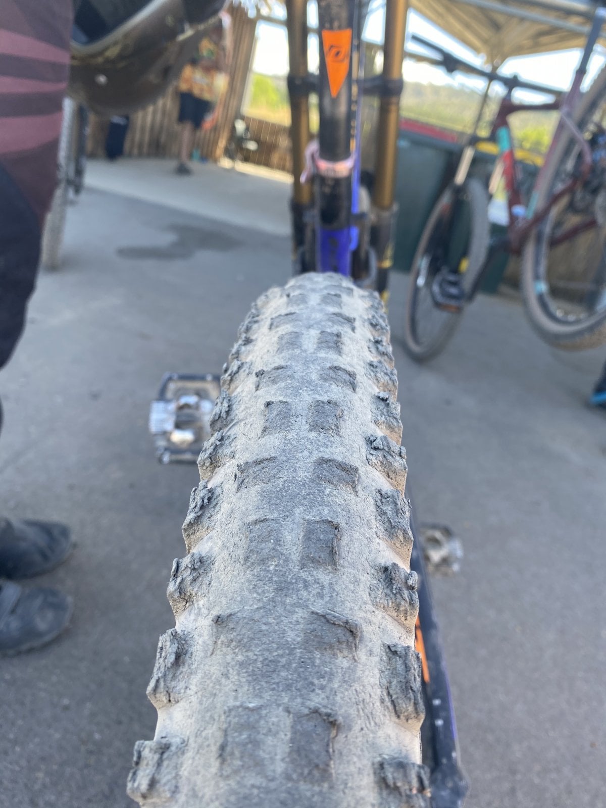

Is my rear tire shot????
That tyre does not look badly worn to me, it looks faulty!
Take it back to the shop! The knobs should not tear off like that.
It might be a batch problem that the maker knows all about.
I have twice successfully claimed for tyres tearing on the bead. All I had to do was to show a photo of the tread and one of the tear (all four fingers were poking through). I had zero difficulty in claiming.
Agree. I had some Nobby Nic's from Chain Reaction that looked just like that with outers breaking away. I sent photos and they gave me an immediate refund. The identical replacement looked far better quality. If it is still in warranty take it up with your dealer with photos. They shouldn't be like that - nothing to do with riding or pressures.
He is my mates tyre, I rode with him couple of days ago, he rekons still has a few more kms left in it.
