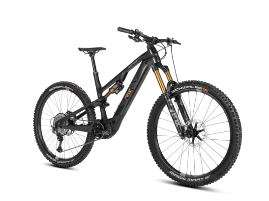

Surely the bike isn’t t aimed at people wanting to get rowdy on the trails - I look at this think as some of the older locals I know who like to ride out from Reigate where I live along the north downs way over towards Leith hill etc.
Probably a 40mile ride there and back of gentle Singletrack, and the bike would be perfect for that. I see it as more of tool for that kind of riding.
the majority of ebikers I see local to me are older ladies and gentlemen whereby the EMTB has given their riding ability a new lease of life, and it’s definitely a lucrative market.

I’m looking at several bikes at the moment, one of which is the Patron. Apparently, the top of the range carbon model weighs 24k. I agree with others the lock out is a waste of time on an ebike, but price wise this bike is on a par with similar spec bikes from Specialized and Trek, so one can just get rid of the extra levers and gubbins and the weight could come very close to the Trek 9.8 XT which costs the same. I currently ride a 2018 Kenevo which is heavier than all of these bikes and I find it very easy to change direction (as did other testers at the time). One feature of the Patron is that they have managed to get the battery lower than most (by tilting the motor upwards) and a low centre of gravity can make a relatively heavy bike feel much lighter. Thus a bike may weigh a bit more but if it has a shorter wheelbase, is not too slack, and has a low centre of gravity, it may well be more “flickable“ than something heavier. A Levo at the same price weighs just under 23k, so I wonder how much one would notice the extra half a kilo of the trek or a kilo of the Patron. I think all three bikes are superb, so choosing between them is going to come down to quite subtle differences and maybe weight is not the most important of these.
