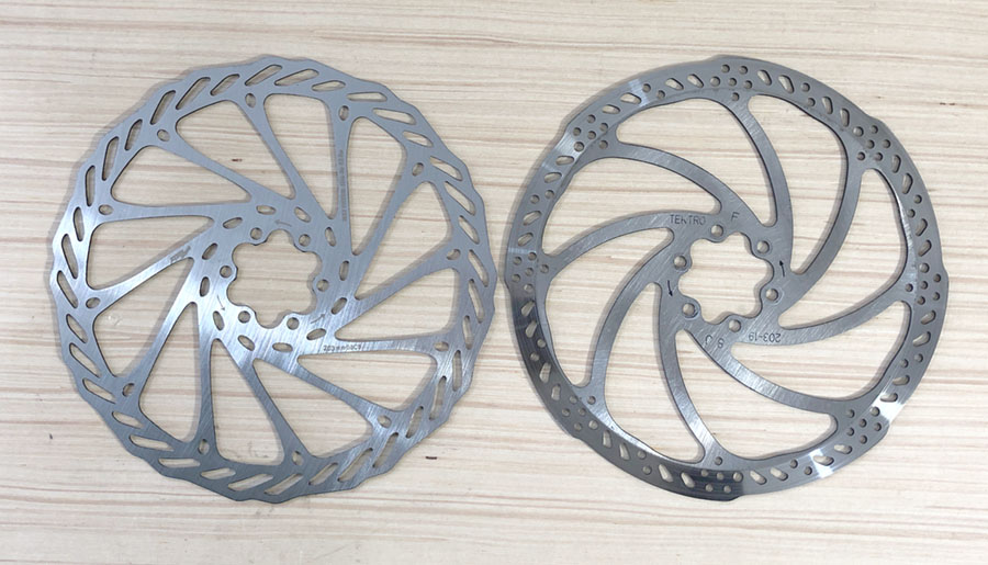

Well not quite... this saga continued some more, but hopefully I've nailed it on the head - finally!
Everything was fine, but then after a 10km ride the zinging started again! That was when I suspected that the rotors could be the culprit.
Just so happen I had a pair of brand new 203mm Avid rotors - spares from a previous bike build project. So I tried it on the front first... no zing! I could somewhat vaguely hear the rotor lightly rub against the pads every now and then - BUT it was near silent and didn't sound like two scimitar sabres glancing against each other in an epic sword fight. :rolleyes:
So what gives? I only spotted the difference when I compared the two rotors. The stock rotors that came with my bike are Tektro 203s on the right (pic below). They only have 8 spokes whereas the Avid rotors on the left have 12 spokes. That may have something to do with the Tektro rotors having the tendency to 'ping and rattle' easily. There's not enough spokes to arrest any resonance.
As far as the rotor randomly changing positions within the gap between the brake pads, the only thing I can think of is that besides only being 8, those spokes have a curved shape making them longer and susceptible to flexing. I suspect that when the outer ring gets real hot from braking it expands - and then contracts when it cools down. The whole rotor could then be warping in and out of a 'dished' shape. I'm just guessing, but smaller 180mm or 165mm equivalents of this same rotor design may not have this issue.
Thought I'd write my findings for other Tektro brake owners out there who may be experiencing this same problem.
