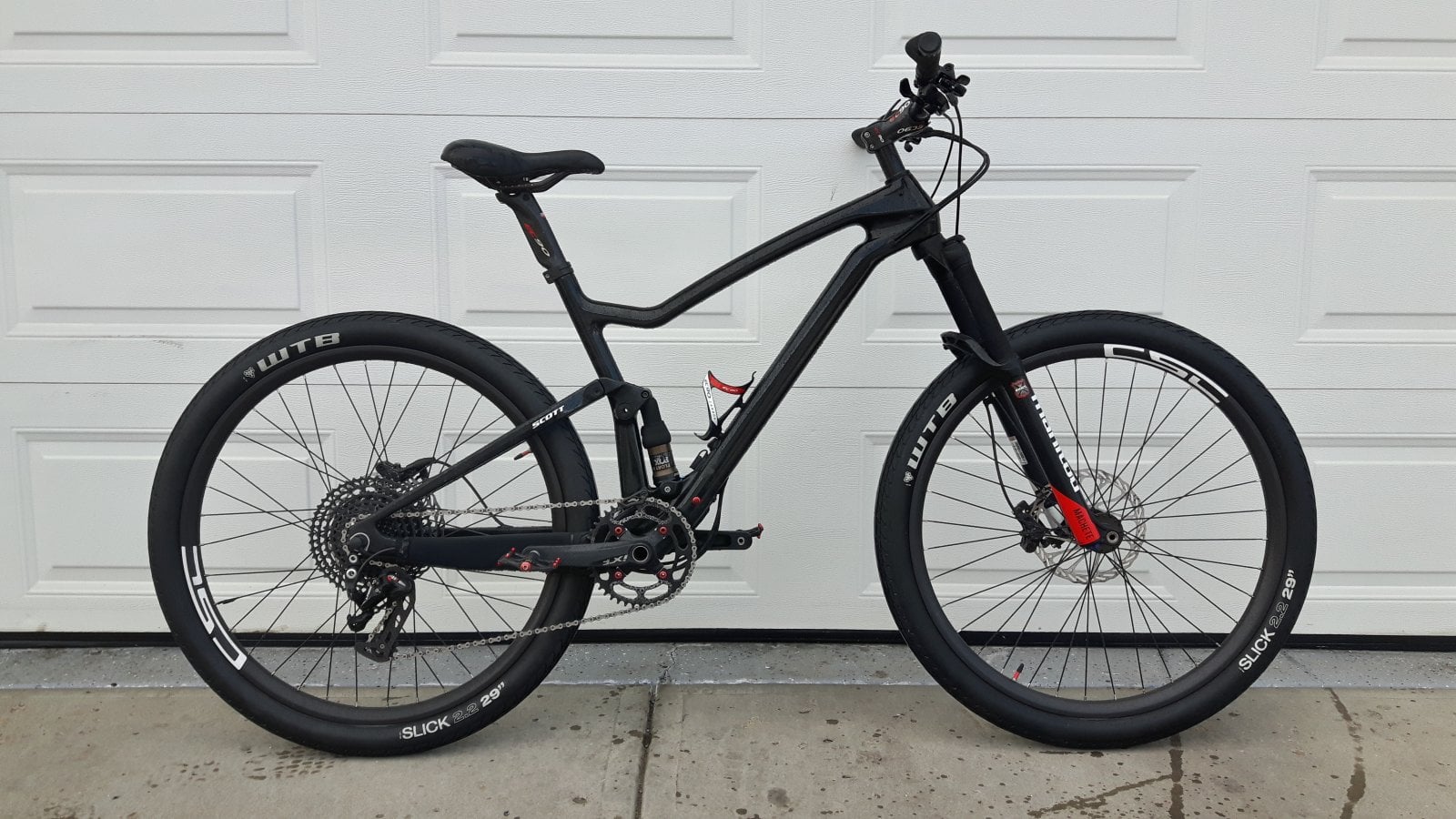

My longest ebike that I've used is approaching 60,000km. Original battery that I custom built. Using LG mj1 3.5ah. 700wh. 58v. Battery has degraded less then 5% In that time.

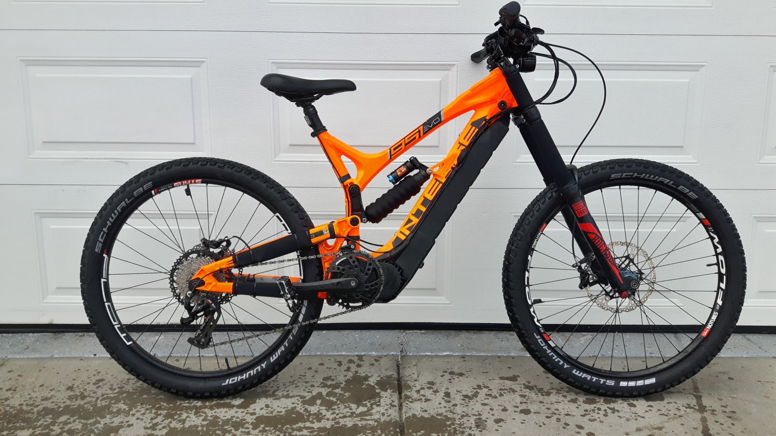

My other dh ebike is right at 25,000km . It also is custom 58v and uses samsung 35e cells. 1600wh and a measured loss of less then 2%
However. I've been very diligent with my battery care. Never charged when hot. Rarely went below 20%. Stored at 70% and never over heated
