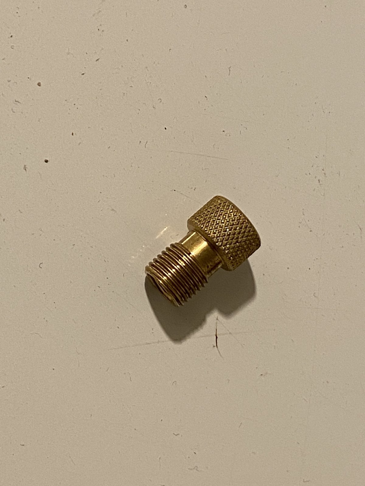

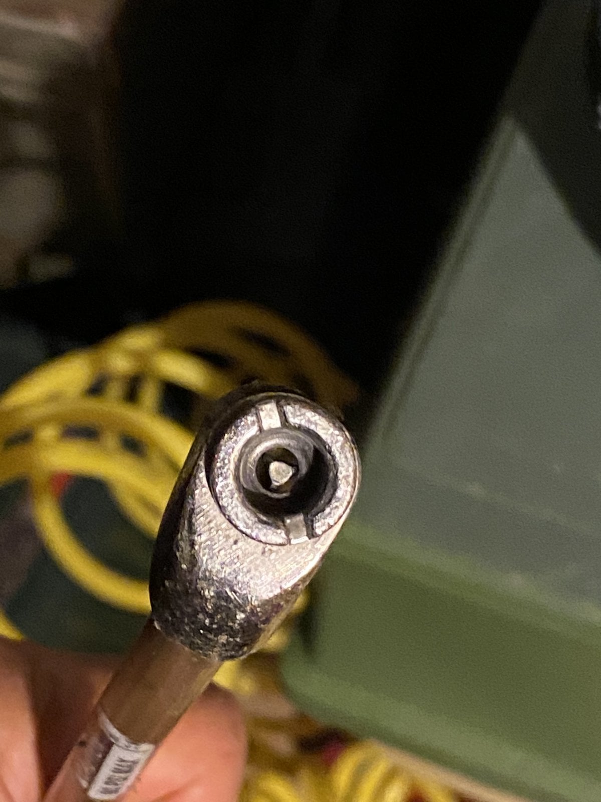

I had this problem, with a park tools pump, I live just above a petrol station, so I went down, and blasted them on there, with the adapter you have. I sprayed some bike cleaner onto the tire, to help it slip in, it took a few attempts.
The damn adapter kept on screwing the valve core out though, had to screw the cores up really tight, and put the adapter on to the absolute minimum.

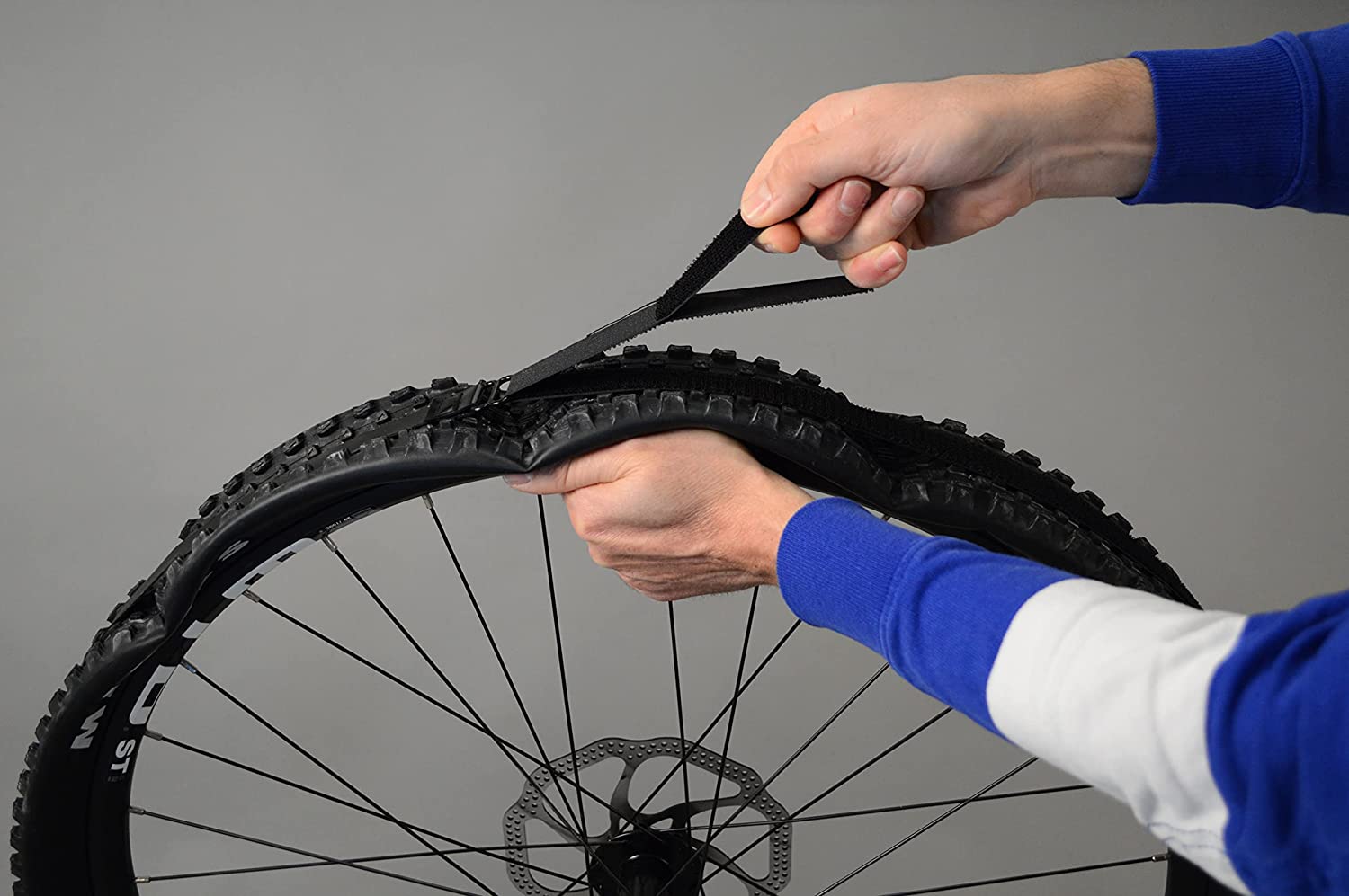

When I worked in a gas station/auto repair shop . . . on the tire machine I would wrap the thin hose around the middle of the tire before inflating and seating the beads. Yo inflated the hose first and it squeezed the tire in the middle and both sides would press against the rim as your were filling the tire with air. I wonder if they make similar for narrow ETMB tires? When I watch a Youtube ETMB tire installation vid they use a jig that allows them to spin the wheel while a high pressure air hose is attached to the valve pumping air in and then they can coax the beads to seat while using two hands.

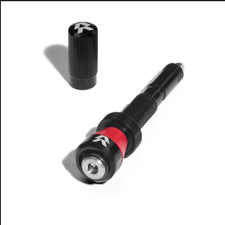

Next time you want to spend money, buy some better valve stems. The ones shown below use a poppet valve instead of those old fashioned presta valve. These stems allow for a higher volume of air to get in per pump stroke.

Wow $50 bucks a set. Their description is exactly my issue. I don't plan to be removing the tires all that often after I get these seated. 3 times the air flow from these poppets is very good. I bet they come down in price as soon as the Chinese copy them.

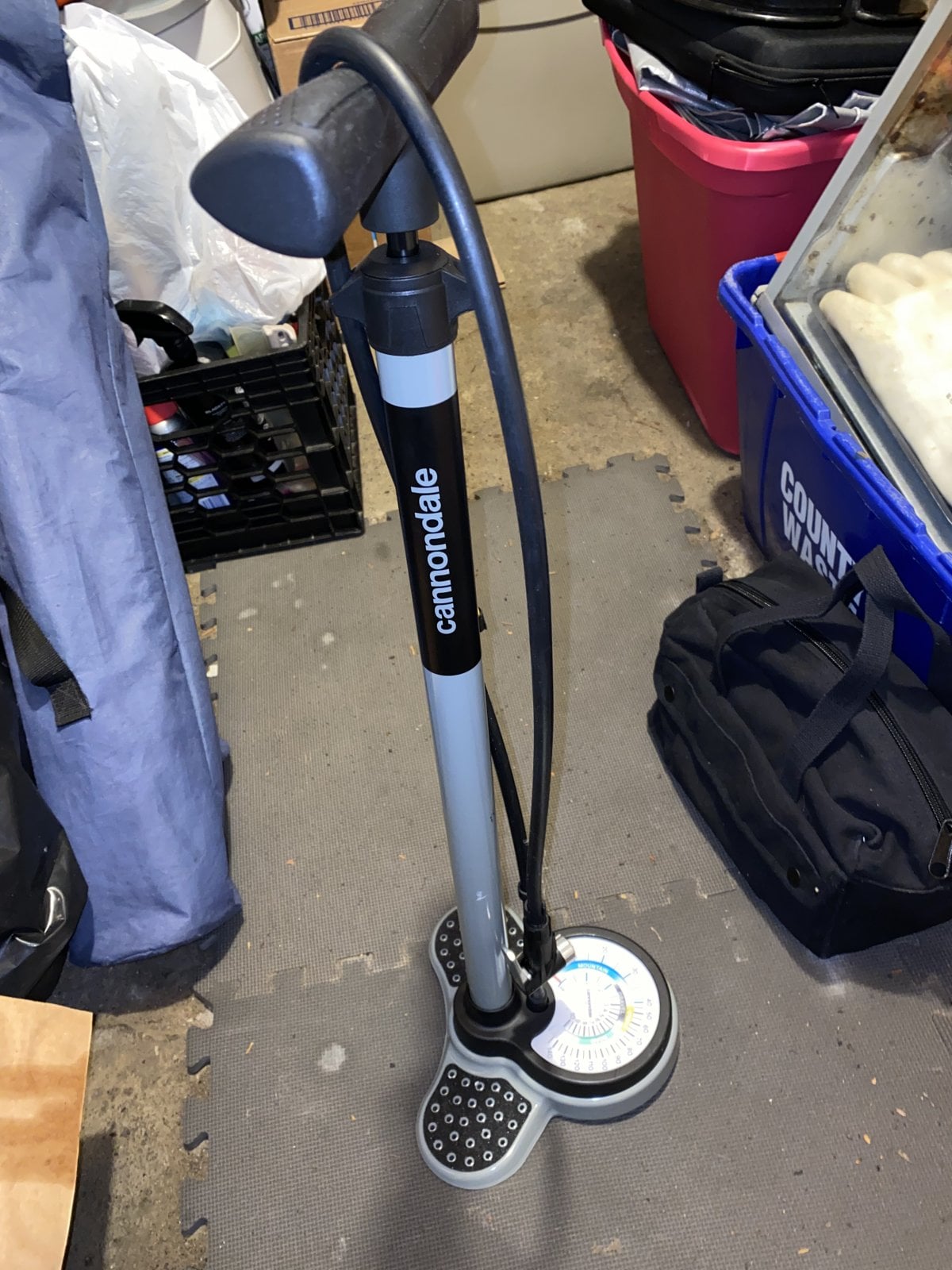

I would need a blast with at least 160 psi. My compressor on does 100 psi. I don't know how how petrol stations compressors go. That adapter I had screwed onto the Presta valve, but the tip of the valve does not raise inside the adapter enough to press against the wand's actuator of the petrol station to release the air. Same thing for my electric compressor as the wand is the same. Maybe the adapter has to be screwed on more so the tip can press the air release?

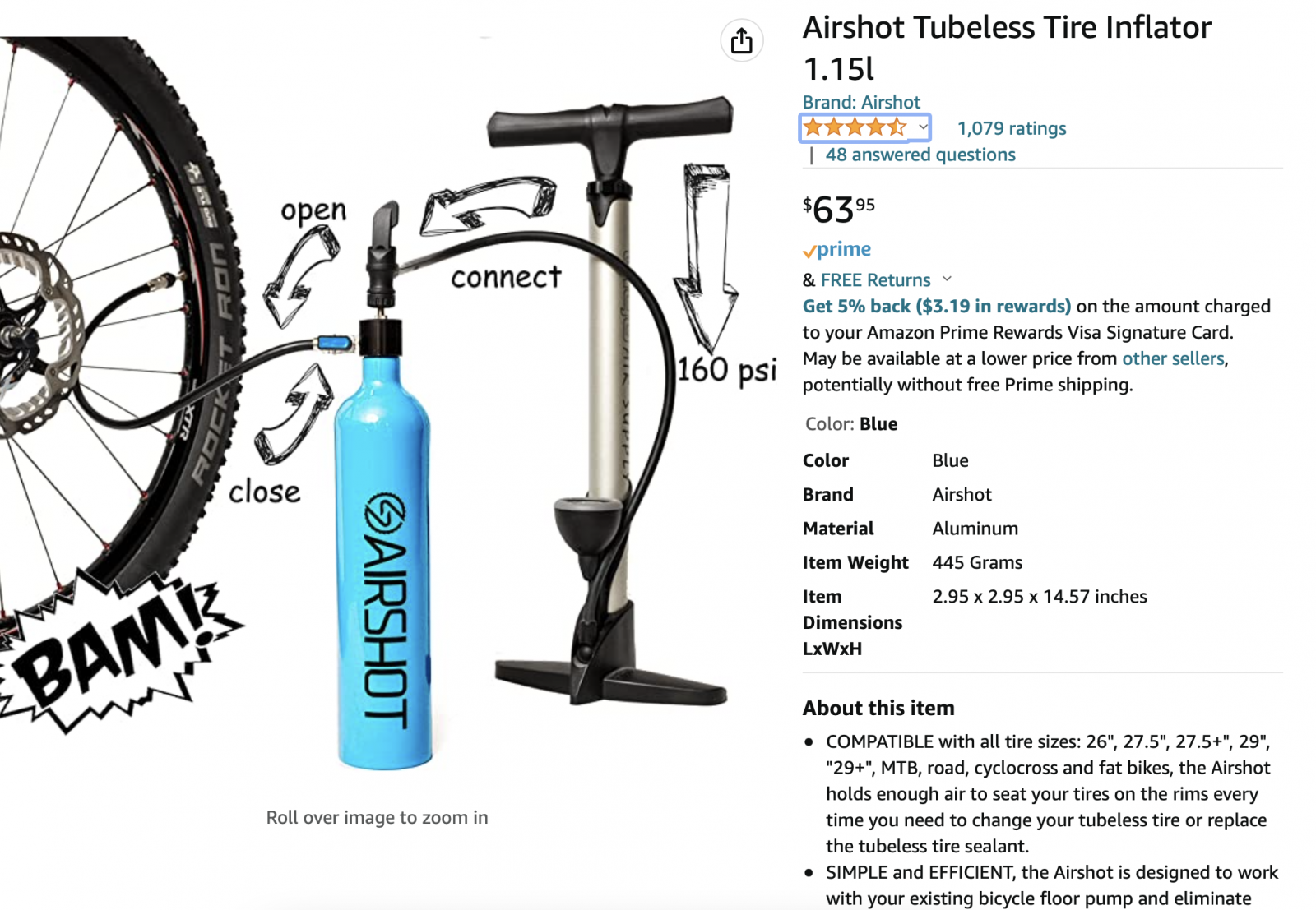

I've got one of these , always seats the bead first time 👍

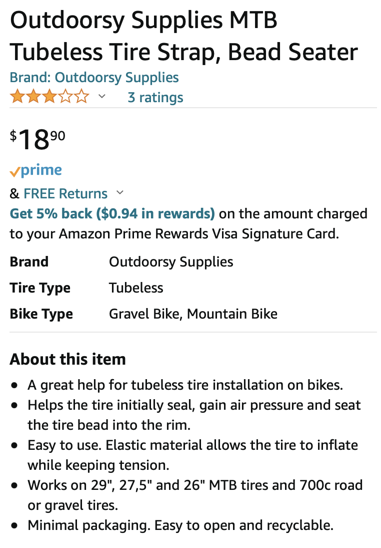

Thanks, I already posted that in #45 above. It looked like a good idea but too many 1,2,3 star reviews that say it didn't work for them. Canister too small to hold enough volume of air. Maybe works better for narrow road tires. But I'll ask my LBS's opinion when I bring him my two mounted tires for him to seat with his shops stronger compressor.

Update: after I switched back to the OEM Trek tires and brought the tires on the wheels to have my LBS inflate them using his high volume air compressor. I took out the sealant as I did not want to splash him as he set the beads. He charged me $20 and added sealant too. But when I got home the front was losing air. He did say to spin the wheel horizontally for 20 min to allow the sealant to circulate and seal the system. And he said to ride it which is even better. Went home again and that didn't work as it was still oozing sealant in two places. Couldn't ride it as it was losing air too fast. Back again to the LBS this time with the bike and I said if you can't stop it form leaking just put the tubes back. When I go back to pick it up when it's ready, this will be 8 legs back an forth to the LBS just for converting the tires to tubeless. I only live 3 miles away, but this going tubeless debacle SUCKS!
Of note, when I watched him popping the beads one tire he was having trouble getting it to pop so he pulled out the strap and circled the center of the tire then snugged it up to push out the beads to the rim. I knew it! Above in another post I had said I used to use a strap to pop auto tire beads when I worked in a gas station as a kid ans wondered why they don't make them for bike tires.
Well, they do and I just ordered one off Amazon.

I sure learned a lot from this thread and watching YouTubes. Thanks to all that responded. One thing I did not realize is I thought the sealant is used to seal up small punctures. But it is also used for sealing the bead. Hence the reason the LBS spins the wheel horizontally for a few minutes after popping the beads in place.
* I just ordered this bead strap:
