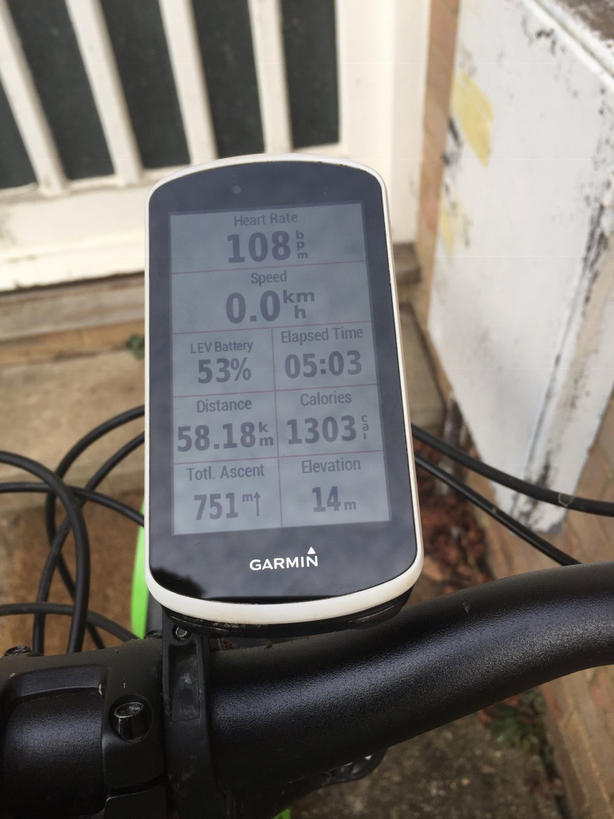

Last Sunday’s ride, TL Expert, 53% left at the end, 58Km of mostly off road muddy singletrack, 751m of climbing:

I don’t use Mission Control to record the ride so I don’t record that, but mostly Eco, some Trail, and a couple of bursts of Turbo. At the end of the day, rider weight, age, fitness, willingness to push on the pedals, battery temperature, and the types of trail all have an effect on the range. I know I can do 60Km/1500m climbing around Afan mostly in Trail and still have plenty of battery left. And it climbs fast!
