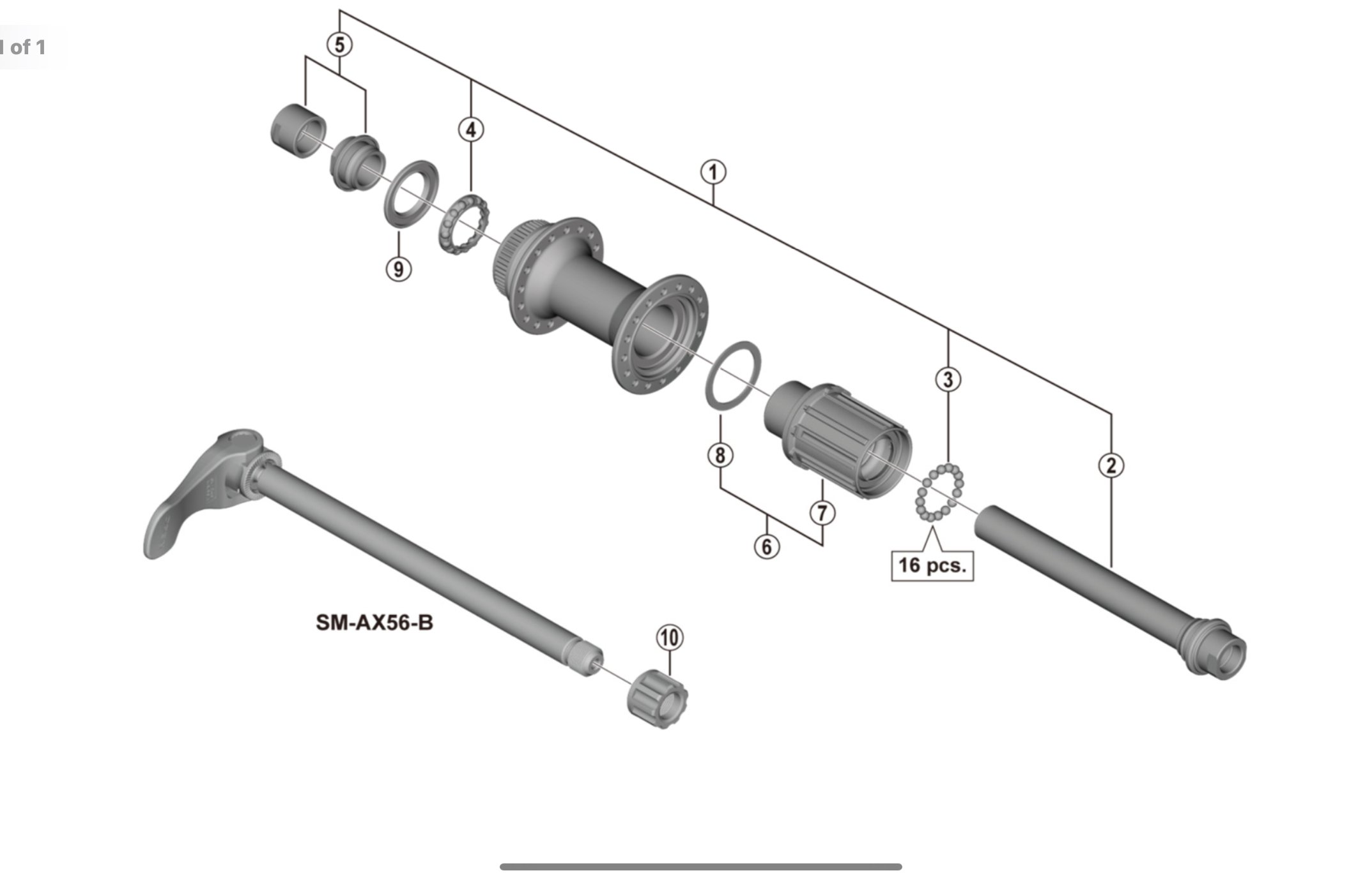

Front wheel has Shimano mt400-B hubs with open bearings
Rear wheel has Shimano Mt 510- B hubs with open bearings
In my opinion, both are Junk and inadequate

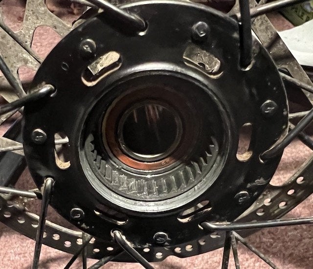

The Bearing cone seals are “ in my opinion“ inadequate & prone to water ingress and pitting
Below picture of rear hub albeit the front has similar bearing design
these bearings don’t take axial or side loading well
Better quality hubs use closed sealed bearing offering better lubrication, easier servicability & longevity
I removed my wheelset after Front hub failure

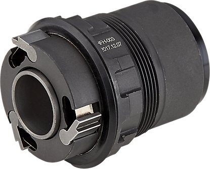

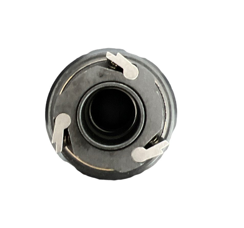

Took a look at the rear wheel. The problem turned out to be the ring gear which is a threaded install into the hub. The ring gear is not supposed to spin! Alas, the hub is almost certainly a total loss. The ring gear may be removed using a special tool. For the curious, this video shows the removal of a ring gear for a 3-pawl system and the installation of a ring gear for the more robust ratchet system.
A picture of the part that spins inside my hub making the wheel useless is attached.
Part numbers? I do not wish to ride a rear wheel with pawls. In other words, another wheel like this one will surely fail. This conversion kit is something I am looking into now.
Edit: The ring gear will surely spin whether the freehub engagement is via pawls or ratchets. Prob. best to get a new, different rear wheel.
SERVICE KIT RATchet LN W. FB MTB Hybrid SRAm XD Steel HXYXXX00N5971S
The 3-pawl freehub the Ratchet LN upgrade kit will replace (along with a few other parts) is is p/n HFH-0003 , which, I think is Specialized p/n S202100005. HFH-0003 seems to be one part number for two different designs. Images attached. My TL Comp Gen 3 came with coil springs for the pawls.
How bad are these wheels? Specialized clearly cut corners. Licensed DT Swiss technology but used the low-end, low-cost system associated with less interesting bikes. Makes no sense at all.
IMG_0130 copy.jpeg s202100005.jpg specialized-specialized-fhb-bear-pawls-ta-sram-xd-steel-3-pawl-hfh-0003-bmb-00412o1c_4733253.jpg
