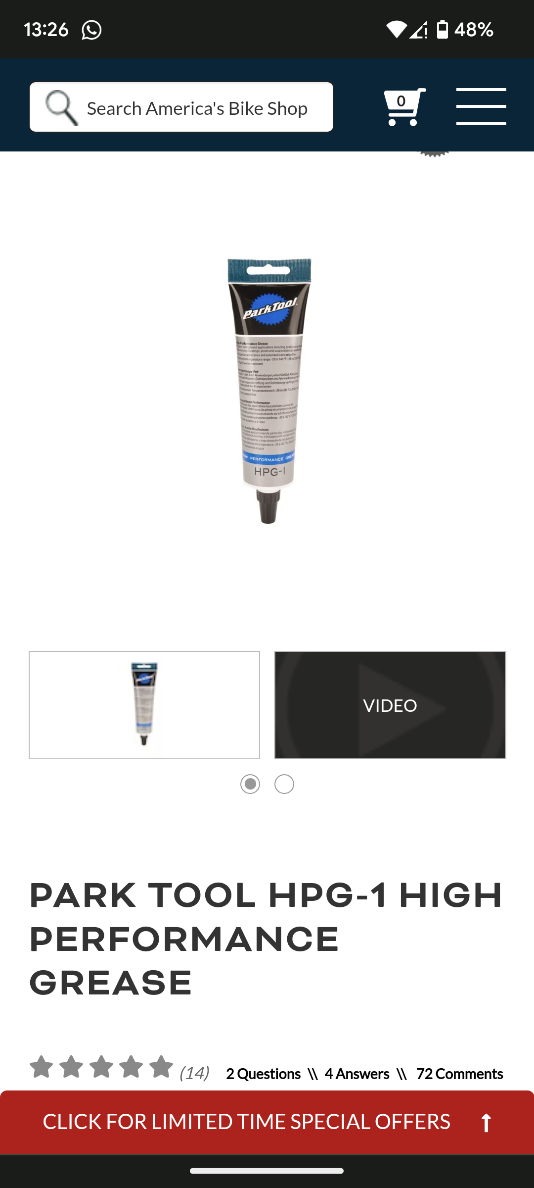

You guys just don’t disappoint, many thanks indeed for the recommendation of the marine grease, I will look at both that and the park tool grease too.

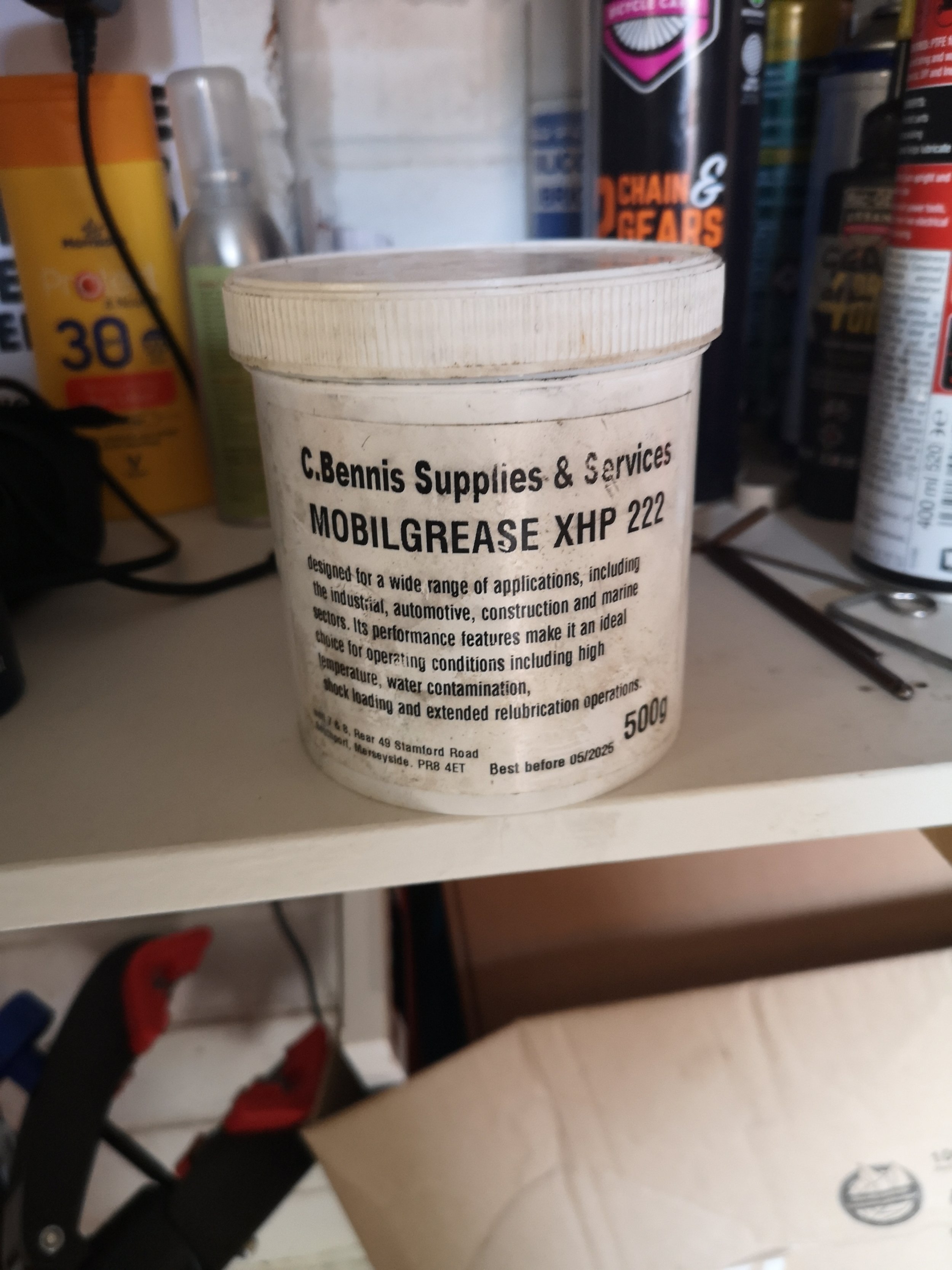

It looks like I might have to suck up the hub noise, I had a bit of a brain storm and I contacted Hope, they use the Mobile grease XHP222 recommended by Bones 🙏 but they don’t recommend using any more than what’s already in there as it could effect the pawl engagement as has already been mentioned, I’ve found some at a good price so I’m gonna get some for when I need to do anything else on my bike, cheers guys 🙏
