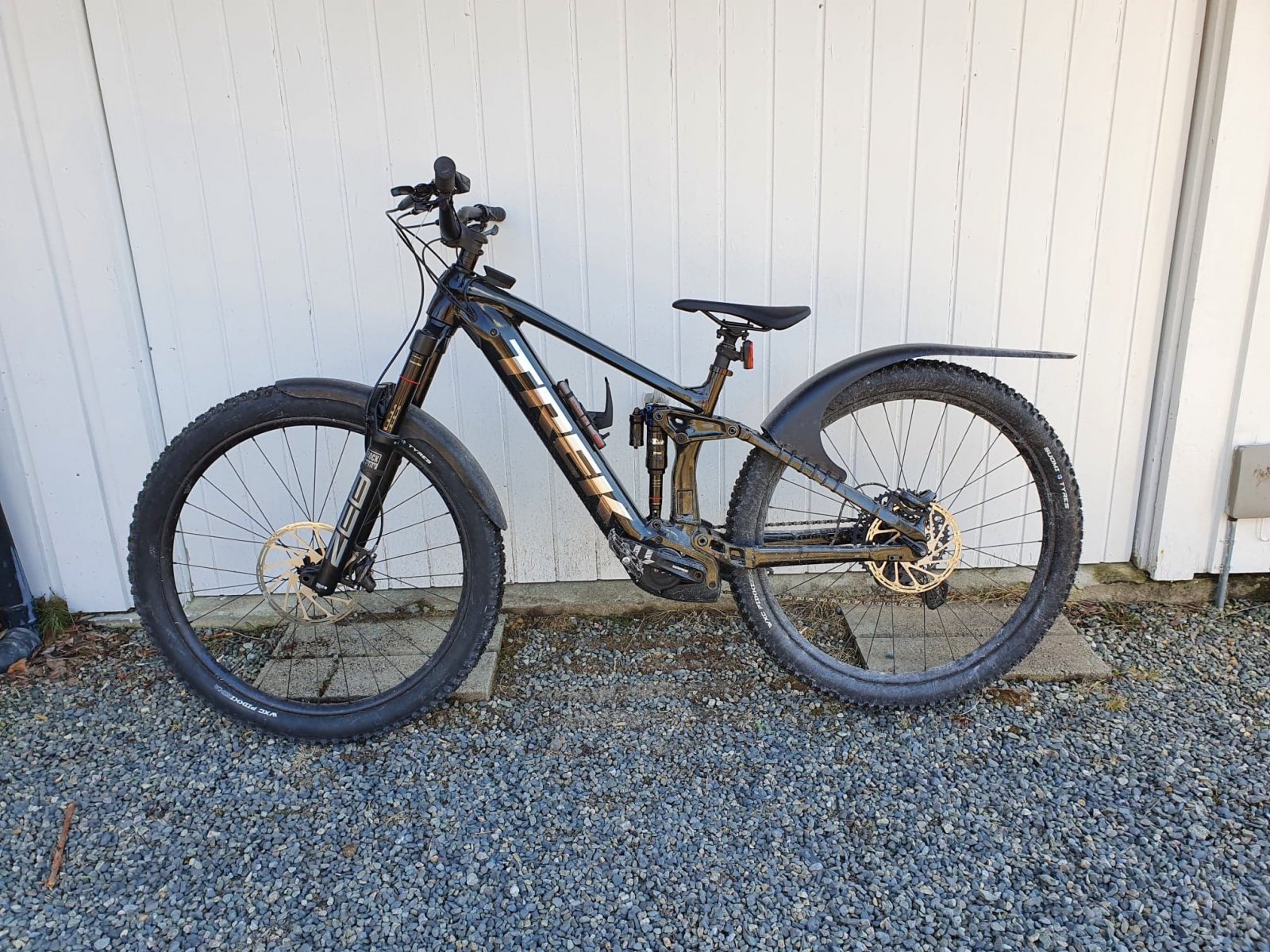

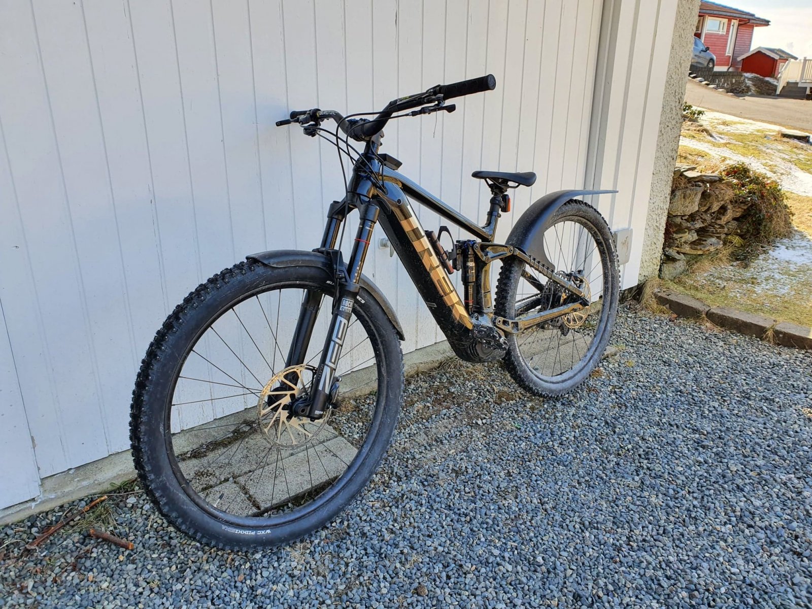

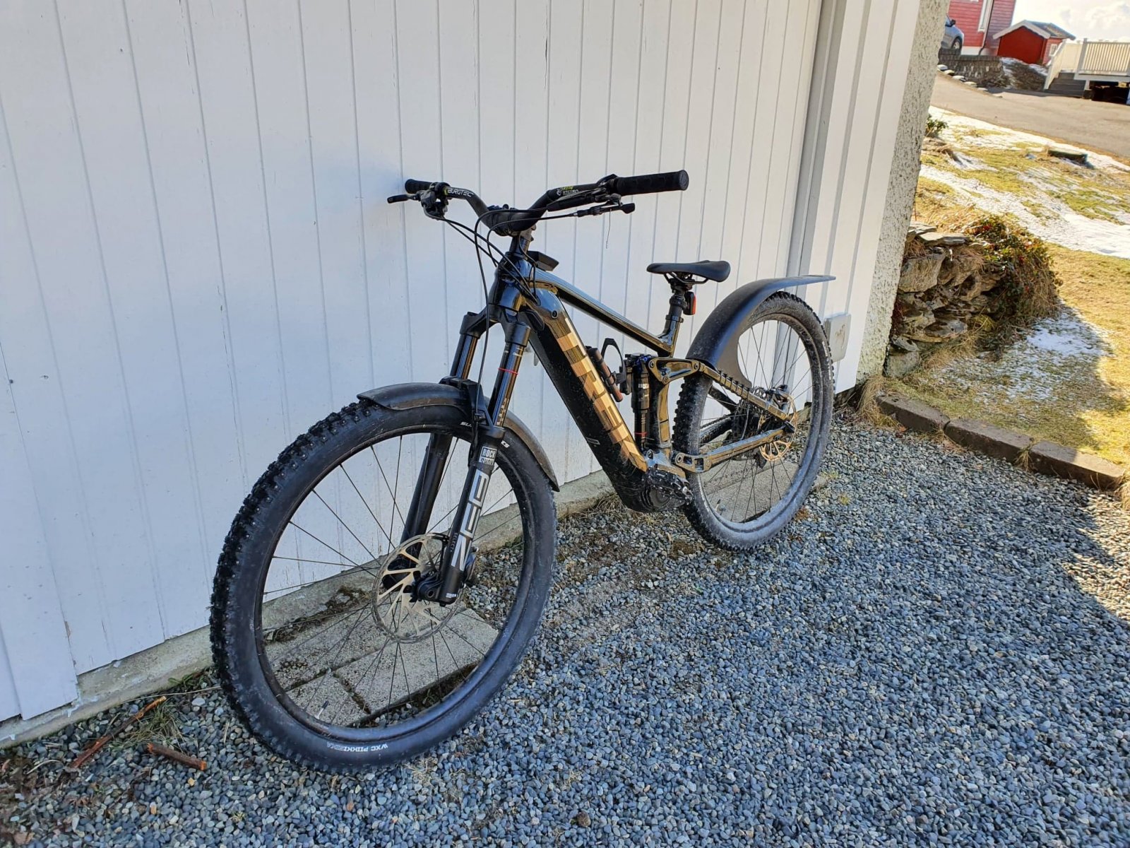

Thanks to Rob for sharing his Rail upgrades, such a big help that he have the opportunity to try so many bikes and share his experiences with us πŸ˜ŠπŸ‘, so that we can use them as an idea/start point for upgrades. I upgraded the same after I saw his video, same suspension as the bike comes with, just longer 170/160 as Trek Slash use, and Burgtec high rise 50. Such a lovely bike has become. Sad that Trek doesn't let us choose travel suspension when we order πŸ˜”. Not everyone needs shorter travel suspension and of course not everyone needs longer either, it should be optional.

Wow, almost impossible to find a 2022 Rail here. The LBS in California are saying either mid April or July/Aug. some into next year! I’m waiting on a Rail 9.9 XX1 and have had the delivery pushed back twice. Enjoy your ride it looks great, I like the rear fender you added, what brand is that?
Mudhugger Large 29/27.5'' - back ( LARGE Rear Mudhugger )
Mucky Nutz MugGuard Long - front ( https://muckynutz.com/MugGuard_Long )

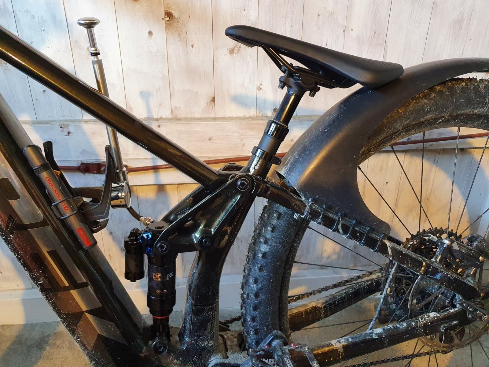

How much clearance do you have between seat stay and post at full compression?

Tks man πŸ‘ It's Medium size, Mino Link is still in low, it feels good and comfortable like this for me even on flat or soft climbings, I didn't try it yet out in the woods on hardcore terrain, we still have snow here in Norway, I am very curios/excited to, to see how will ride/perform there :unsure: and if I need to go for High. I bought the fork from someone who upgraded his fork to, and is exactly the same ZEB Select + as Rail comes with, but it's 170/180 mm instead of 150/160 that Rail comes with, it just has a smaller crown than the original but it's just a small aesthetic difference not functional which for me doesn't really matter. Same for the rear shock 230x62.5 instead of 230x57.5 found it on eBay RockShox Rear Shock Super DLX Thru Shaft RCT Progressive, MREB/MCOMP- 230 X 62.5 | eBay

Good call! Make sure you check it as it could be a tight clearance especially in the "low" position on a size M.

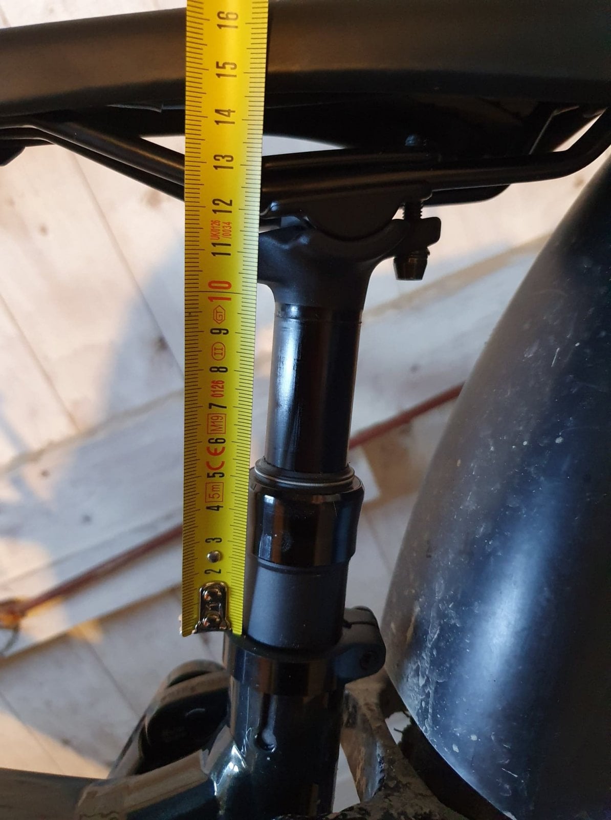

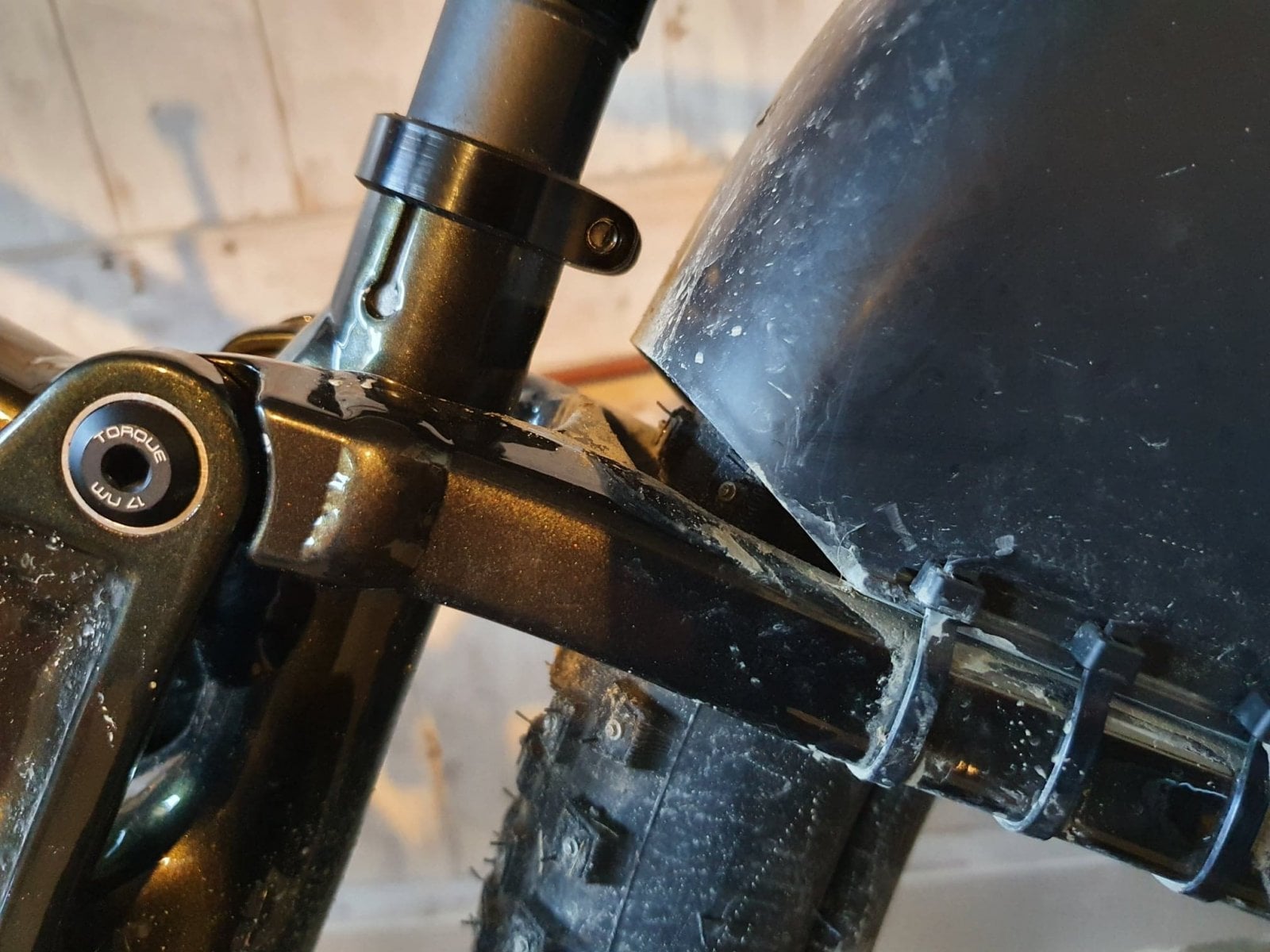

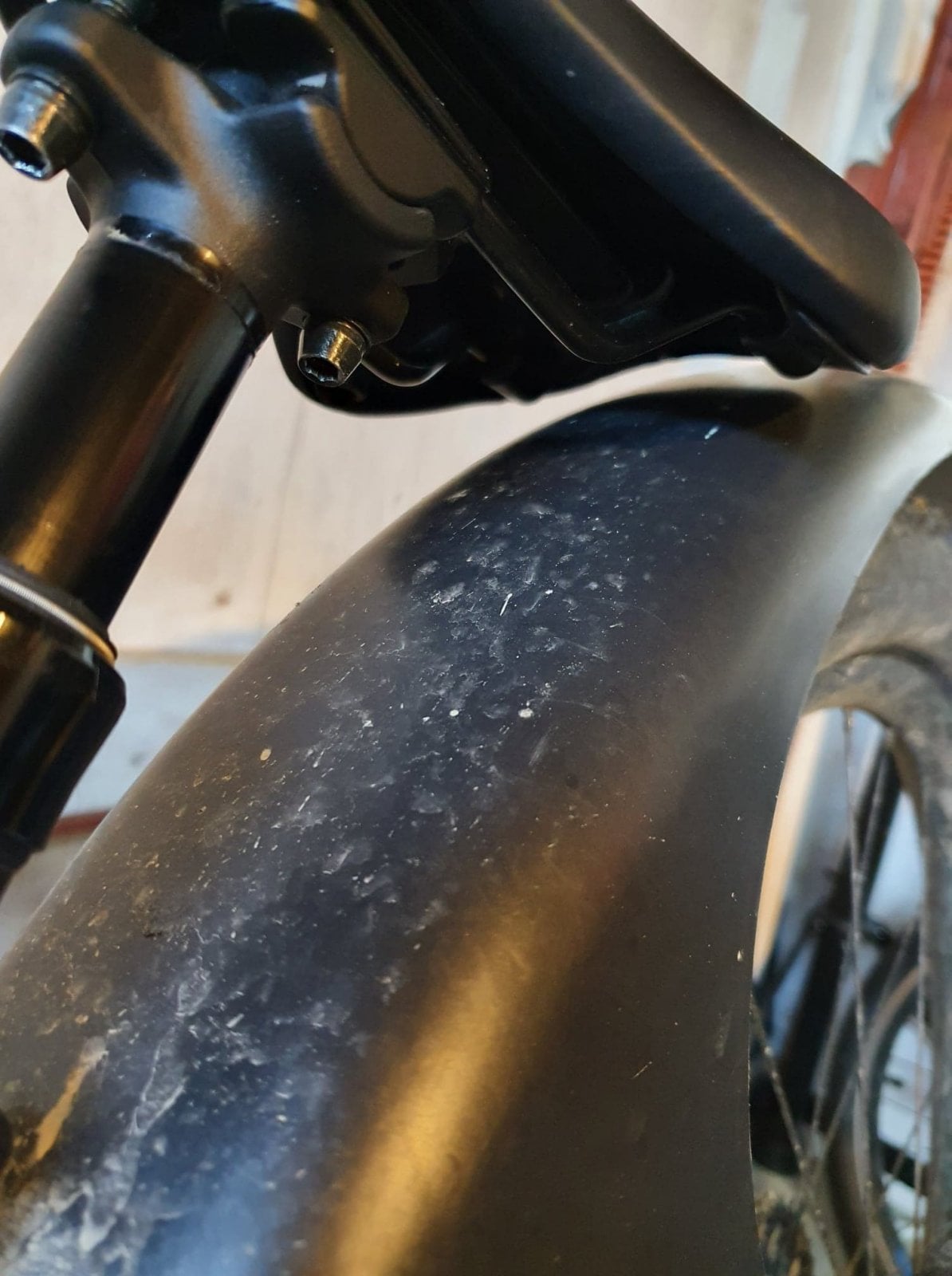

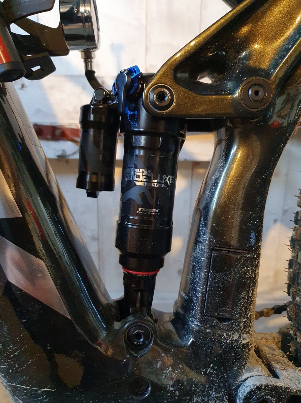

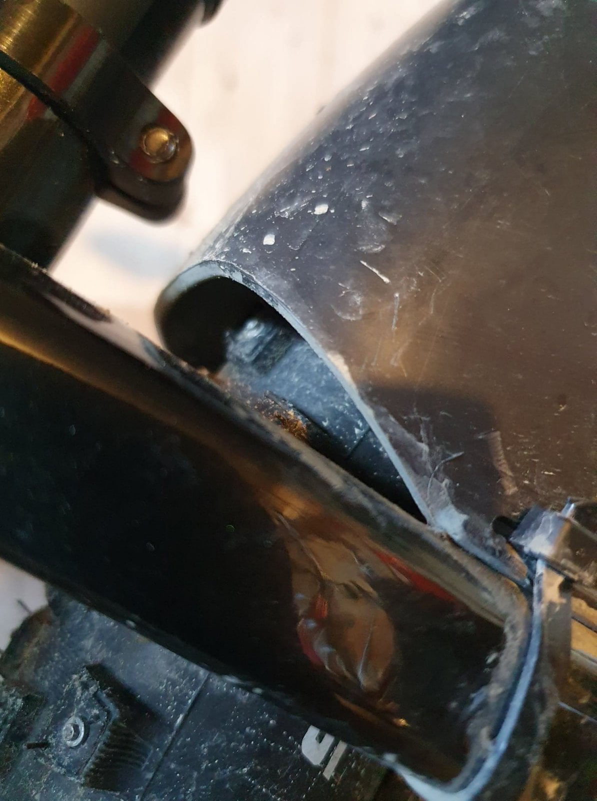

I was curious to, so I just took a quick check just to make an idea. I took the air out and it seems like I have to go in high, not sure yet, I will see when I take out the rear fender, but like this, the seat it's to high, it's stays in the way for me, I need it completely down, it's to early to know,I have to ride it in the woods later to be sure.
Still some space.... 1 and 3'rd picture
Seat stay clearance looks good
Shock reservoir clearance looks good
Seat will be an issue - could try removing the mudguard and moving it forward in the rails a bit.
Possibly have to go into the 'High' Mino link position i think, as a bonus i believe you will get an extra 5-6mm of travel in the rear when you do so.
Is that at full compression btw Tartam? 4th Pic looks like there might be some travel left in the shock
I will get another/proper one with full compression/seat in the middle and without rear fender, later πŸ‘. But as you say it's possible that it is a must to go in High.
