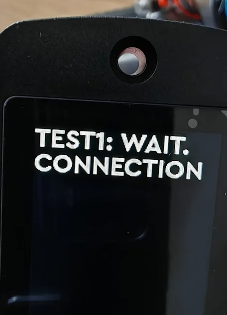

"TEST1: WAIT. CONNECTION" TQ App cn not connect to the display. So, anyone here done the swop from V1 Blk/White TQ display to the TQ V4 Colour display and had the same issue happen. YT video seems to show that it should be a straight swop and just work.

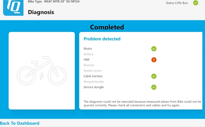

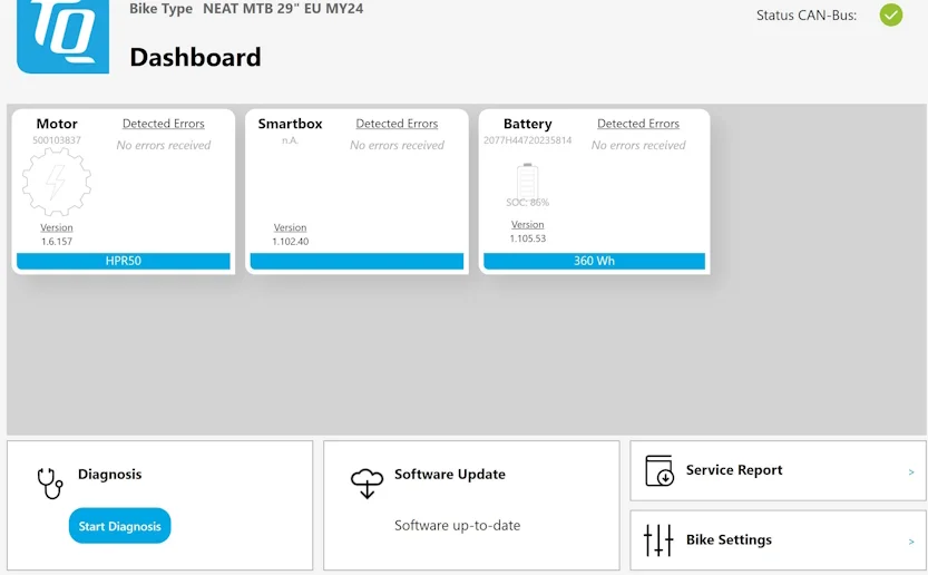

Hi, Thanks for reply. Shop Connected bike to TQ dealer tool and here what it showed. No option to update new display, tool can not evenfind or connect to display.

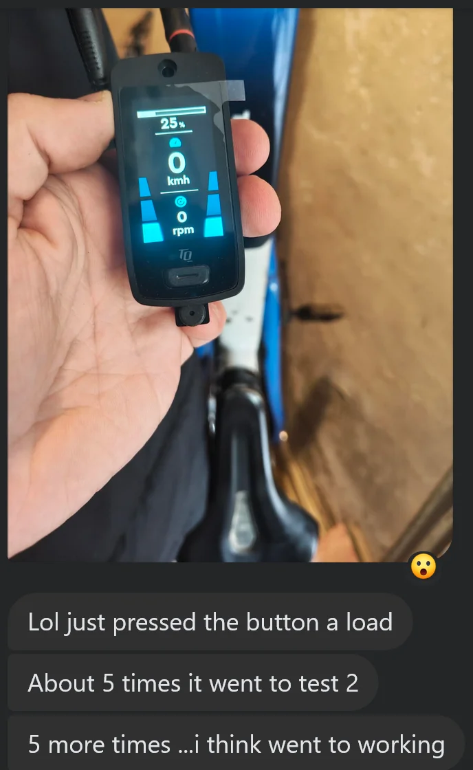

I Posted the New TQ V4 Display to a mate who also owns a neat rr sl. He plugged it in this afternoon, no tool or update needed.
