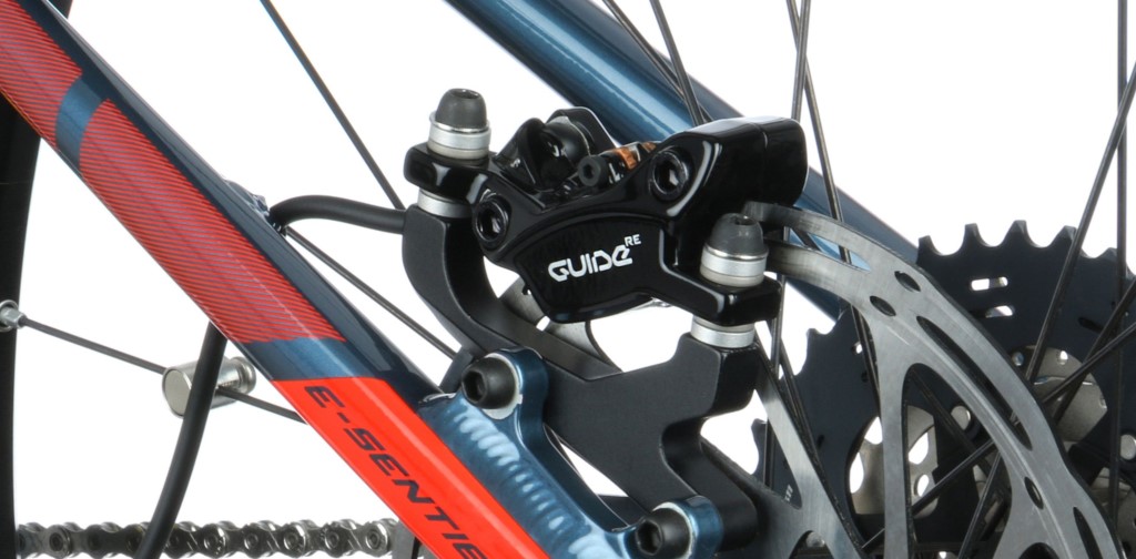

it's ok. There's a mega close up on CRC.
I just wanted to see what adapter set-up it uses and if there is a beefier option.
Having just seen it's IS to Post mount. There should be.
Now trying to remember which mounts were hte beefiest is the difficult bit

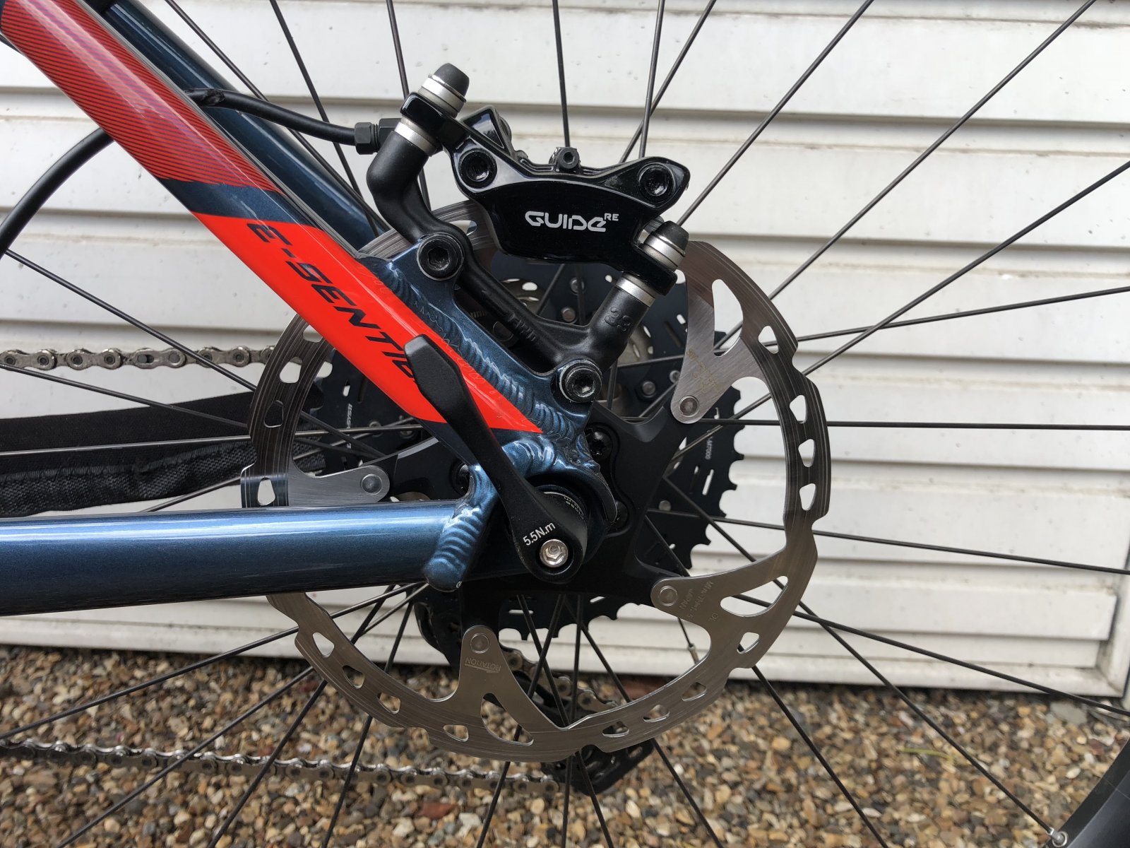

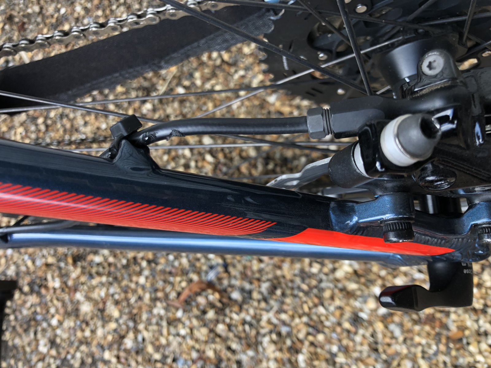

So here is a video of the noise it was originally making - doesn't really do it justice as filmed on an iPhone.

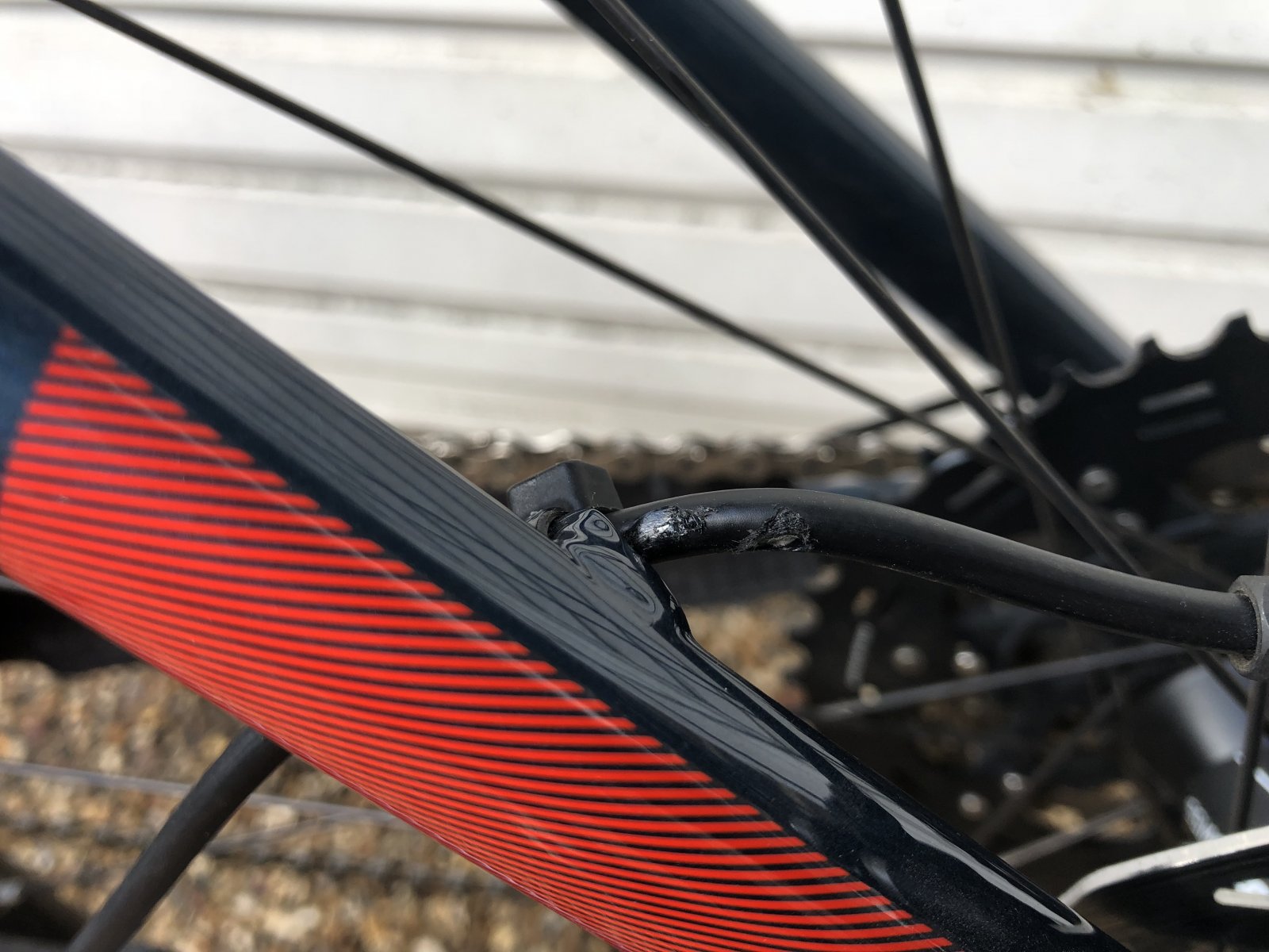

I have also attached picture of the new 180mm rotor. There is also a picture of the rear brake hose, you can see from the marks on it where it was being "pulled" against the tie mount by the movement of the calliper mount.
So it was flex in the 200mm mount?
Has the 180mm mount/disc solved it?
I think a number of factors involved ( as already mentioned) but IMO the adaptor was part of the problem.
Ny situation, fittings a 160mm disc sorted it
Patreon’s situation, fitting 180mm disc sorted it
Summary, 200mm disc is a no no on the Sentier.
Sorted :)
