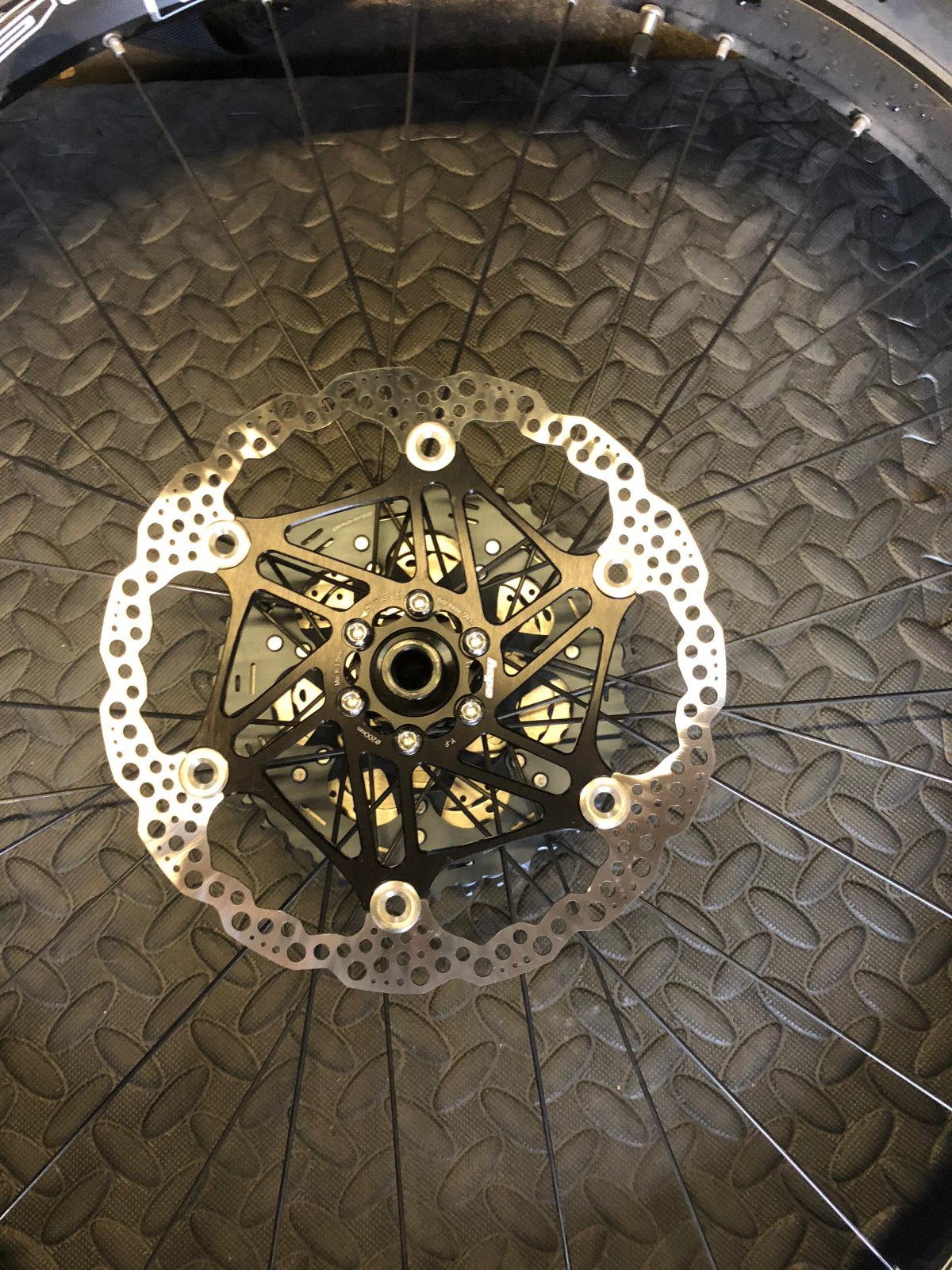

So a long day today
Went to Evans first thing to get some new pads, and a new rotor.
They didn't have a Sram rotor but did have a Hope Floating one, which the assured me would work with the Guide RE's - looked the nuts so i thought why not.
Get back home, and lo and behold they have given me the wrong pads, but i did mount the rotor, but couldn't put the wheel back on till i got the right pads.
Back to Evans to return the wrong pads and get the right ones (turns out their computer has the wrong info listed).
Back home, do the pads, mount the wheel with Hope rotor, and lo and behold its rubbing - specifically the bolts/rivets connecting the inner and outer parts of the disc, hitting the calliper body as they are just a tad to close to the outer of the disc and run the bottom of the caliper.
Much swearing ensures. Get the Sram rotor out the bin, and decide to sand the hell out of it again, clean it all up, and put it back on. Doubly gutted by then as was loving the look of the hope, only to be denied!
Finally all back together, took the calliper off, put it back on, checked the wheel and nothing loose etc etc.
Now trying to decide if i want to take it out in the pouring rain to see if the issue still persists.

Hope parts have always been this way
, you really need a hope hub, hope caliper and hope rotor from the same range to guarantee fit.
I always make sure that on new pads I don't drag the brakes but stop hard to get the new material onto the disc seems to work
