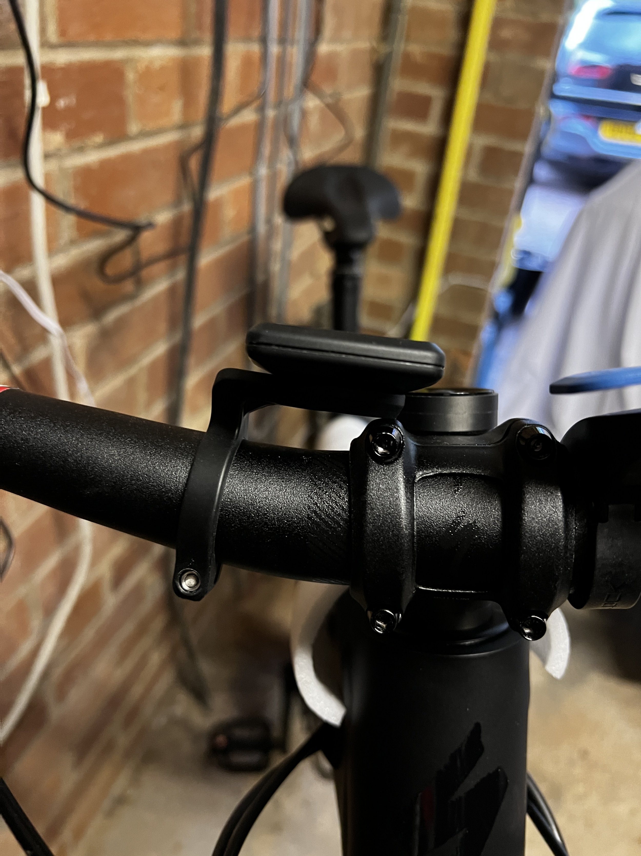

I wonder if you can help me with my Specialized Turbo Levo Alloy 2023 ebike and my new Turbo Connect Display that I purchased today.
I’ve tried to fit the display to the handlebars but find that the diameter of the display’s bracket isn’t big enough to get the bracket to reach the middle of the bars next to the stem. I have managed to fit the display to the handlebars but because it won’t reach the stem, the display ends up being slightly cockeyed. The handbars aren’t straight until they level out next to the stem.
See the photo. My OCD is getting the better of me haha
Is there a bracket that fits a larger handlebar? And what size would that be?
My handlebars are:
Specialized, 6061 alloy, 6-degree upsweep, 8-degree backsweep, 30mm rise, 780mm width
What diameter are my bars and is there an option to purchase a bigger bracket?
This website seems to offer a bigger bracket? do you know if this will fit my bars?
Cheers
Lee
Welcome!
You have 35mm bars (that's the diameter of the bar tube at and around the stem attachment area). It's likely that your existing mount is made for 31.8mm bars. Yes, the 35mm mount you referenced will work. However, you may still run into clearance issues with your stem or your stem spacers and cap.
