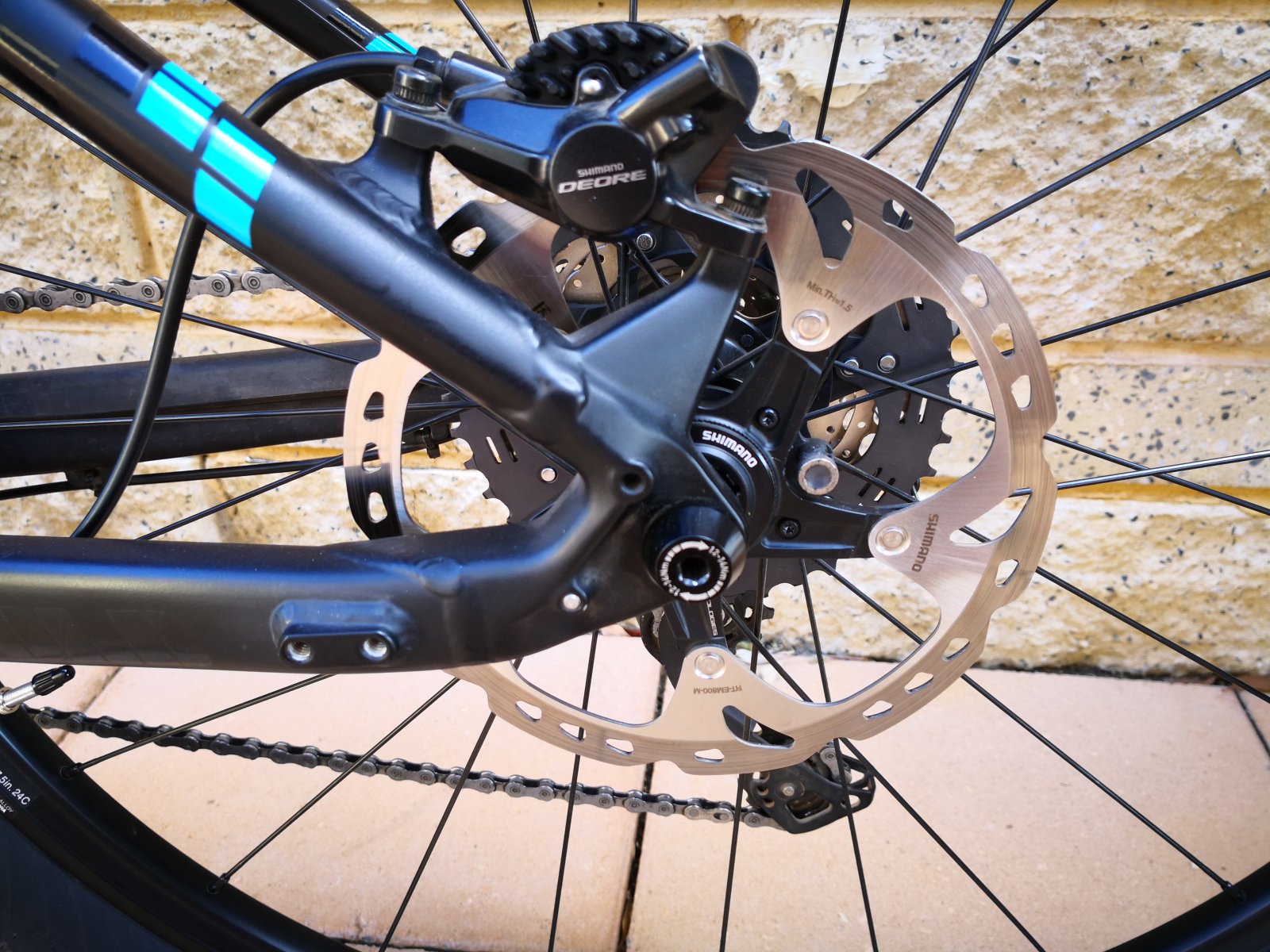

Here is the RT-EM900 overlayed on the levo rotor. The magnet is further out but it does like it will still work.
what about height of the magnet. the specialized magnet bolts onto the 6 bolt, ending up about 3/4” proud of the rotor surface. this EM rotor appears to have the magnet tucked flush with the spokes.
also they are using ferrite magnet. why cut costs like that? beats me.

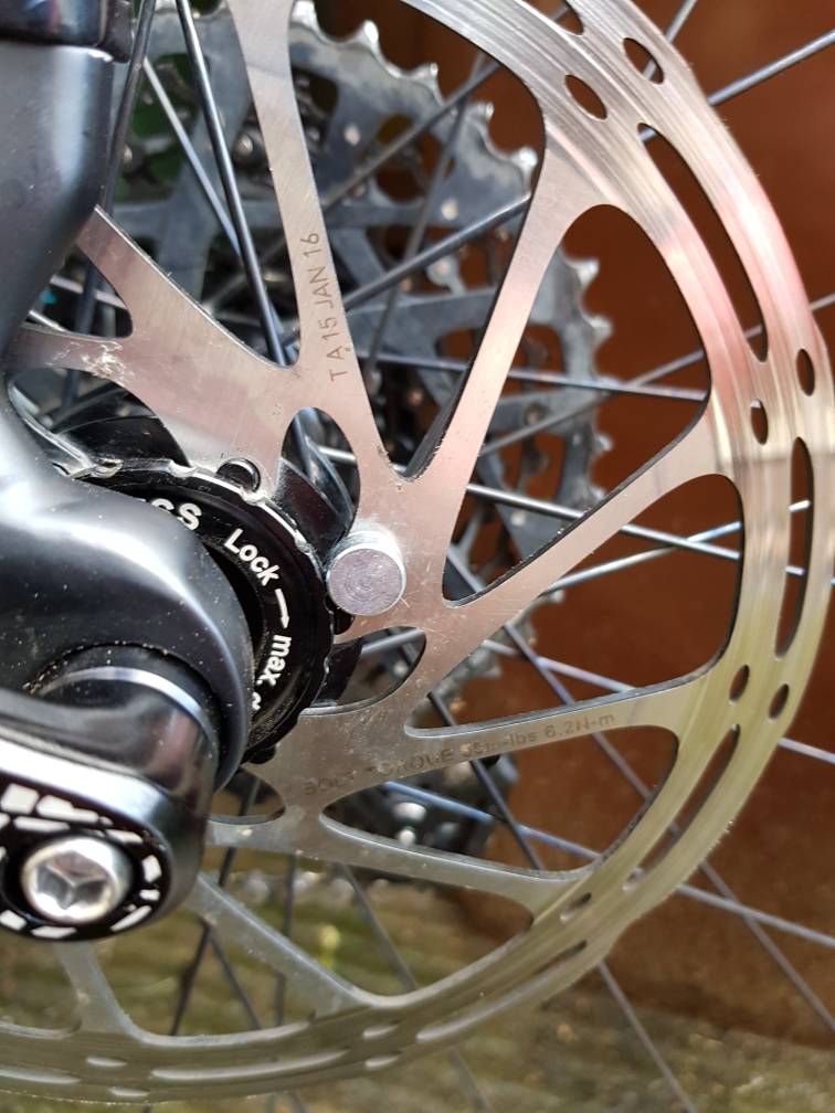

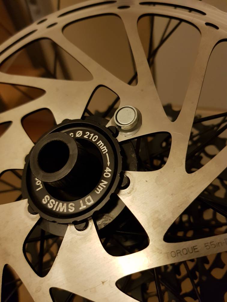

Ok so the magnets arrived. Put one on in the below position, closest to the centre and next to an original bolt.
And set off. Power for 5 seconds then a red and blue light and power loss. Gutted!View attachment 6761View attachment 6762

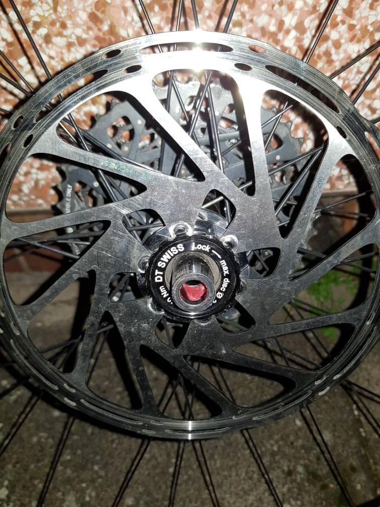

So I did, or think I did, a factory reset just in case all these tests screwed something and put the magnet, totally out of position, but most secure (pic1). Fail. Same thing.
Then I put it in the most insecure place, it's barely contacting a 1/3rd of the magnet, but replicating pretty much where it would be using the OEM bracket and magnet. Fail.

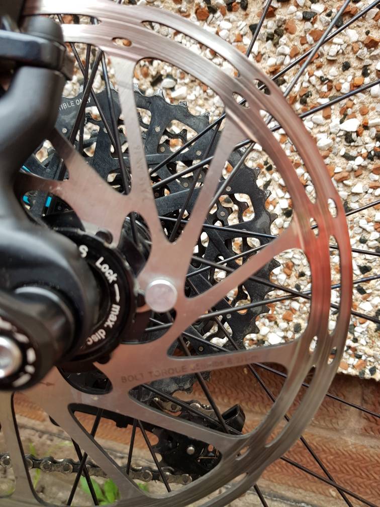

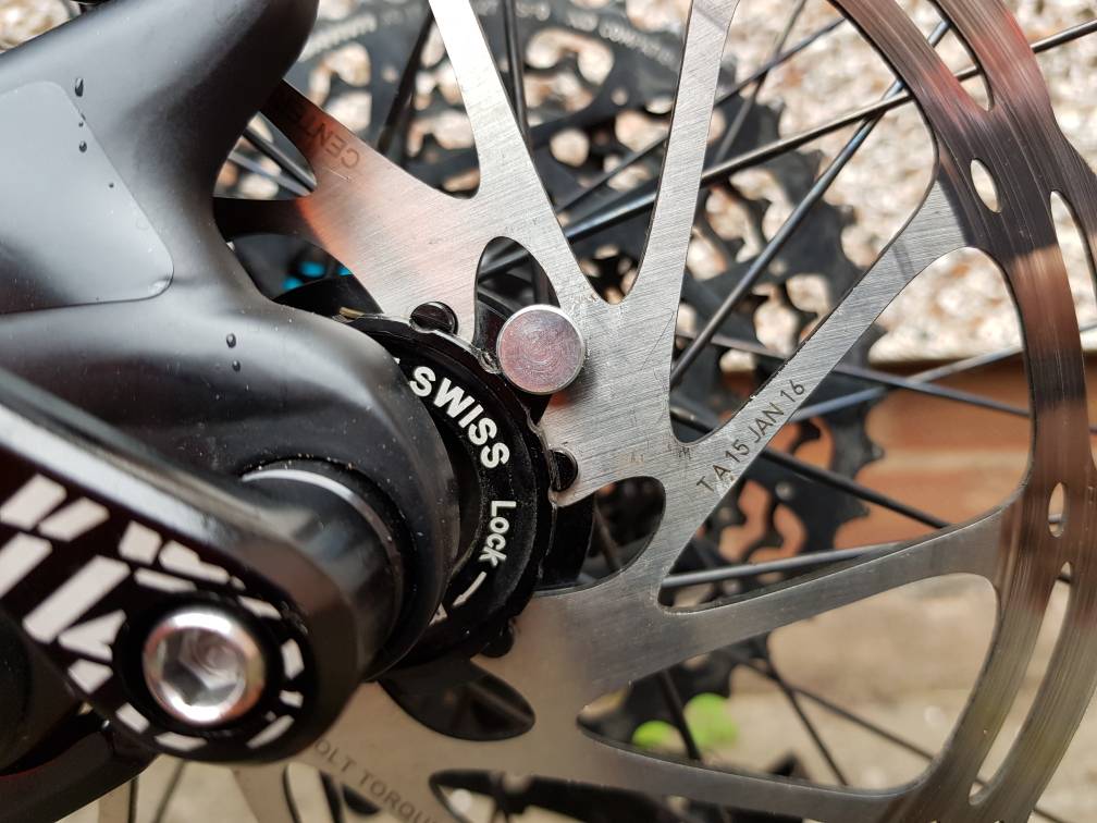

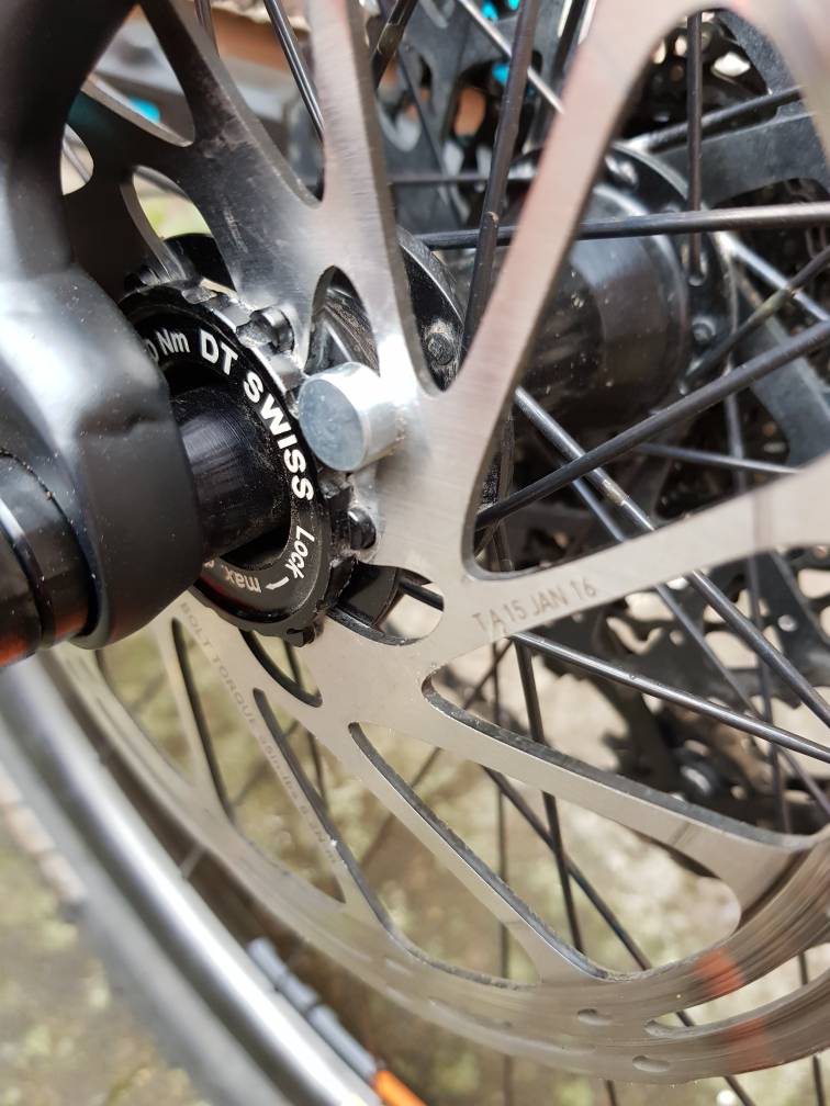

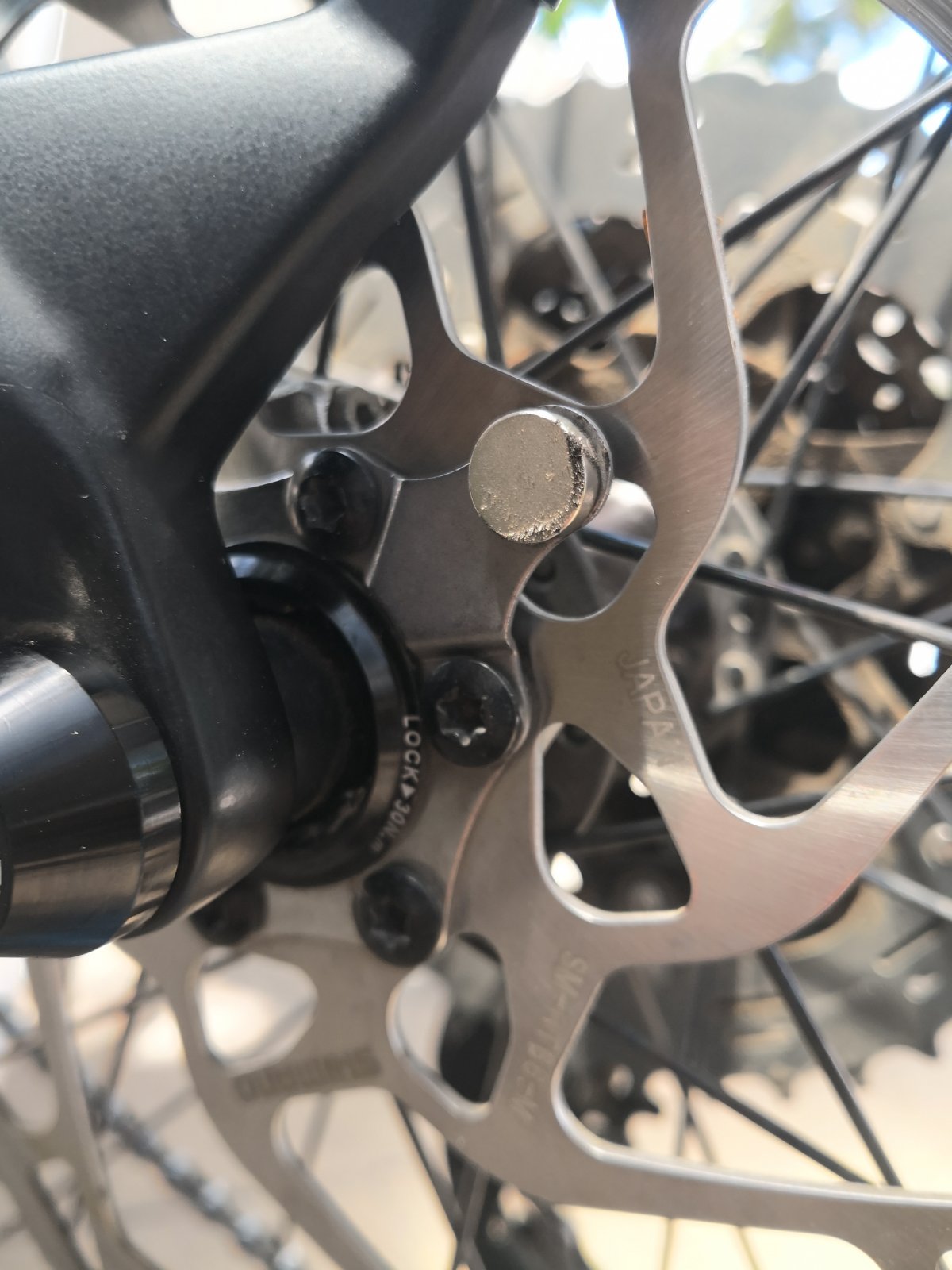

Ok guys, I've never used magnets before so I'm guessing it's an easy mistake. I don't mind holding my hand up, even if it might make me look dumb.
So the magnet came in like a metal shell. I was sticking the magnet to the disc so the sensor couldn't pick it up. Luckily there was just enough pull to put the magnet on backwards and stick to the disc, tested... And then it worked. So I glued it in place with the 2 part epoxy and left it over night.
You'll see what I my mean on the two pics...

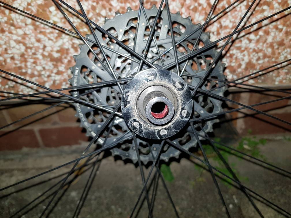

I also had the best outcome with the rotors. Took the ones off the Enve and they are 6 bolt fitment with 6 bolts?!? So I just put the levo ones straight on, no adapter needed and no centrelock rotor needed. All those are going back. I guess I should've just looked at it all first. I don't know why my hubs are like that. There's 6 pins and a lock ring. See pics. Only really noticeable when the lock ring is off.

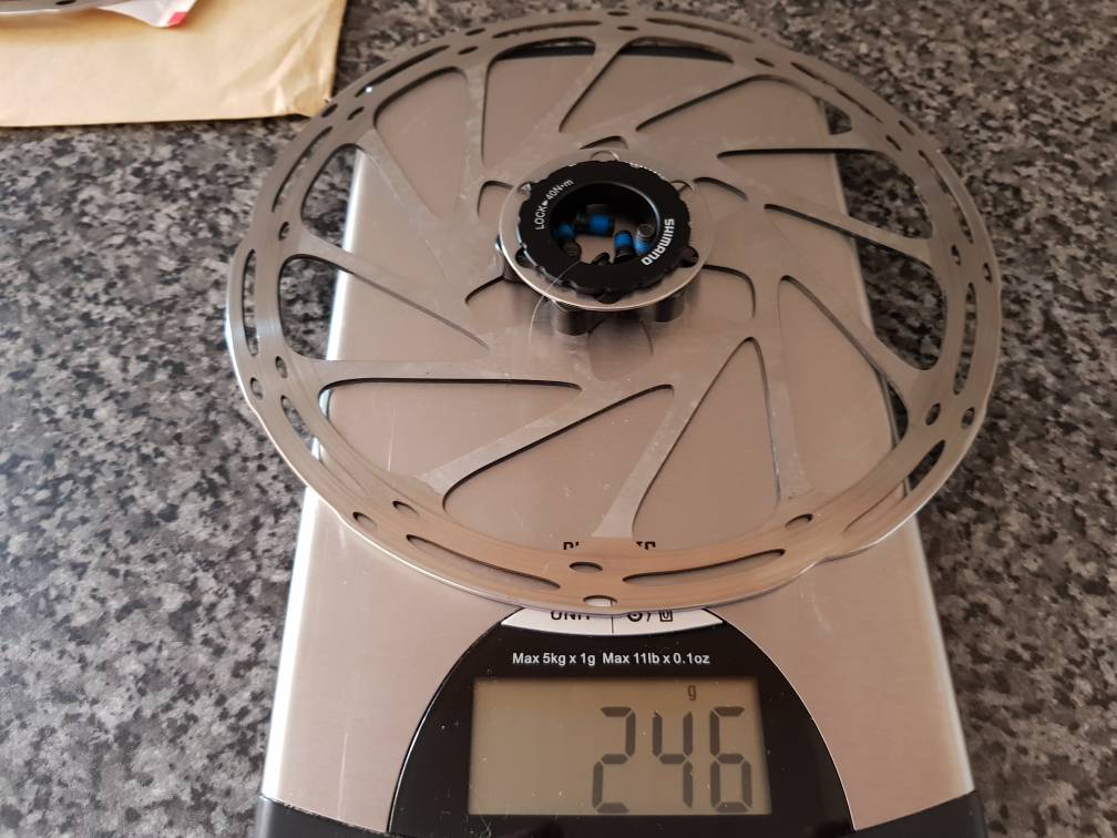

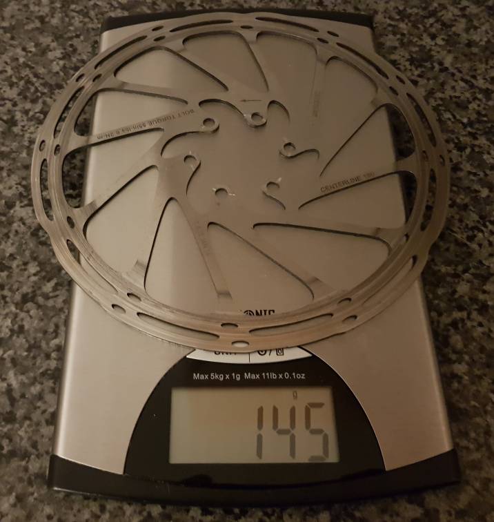

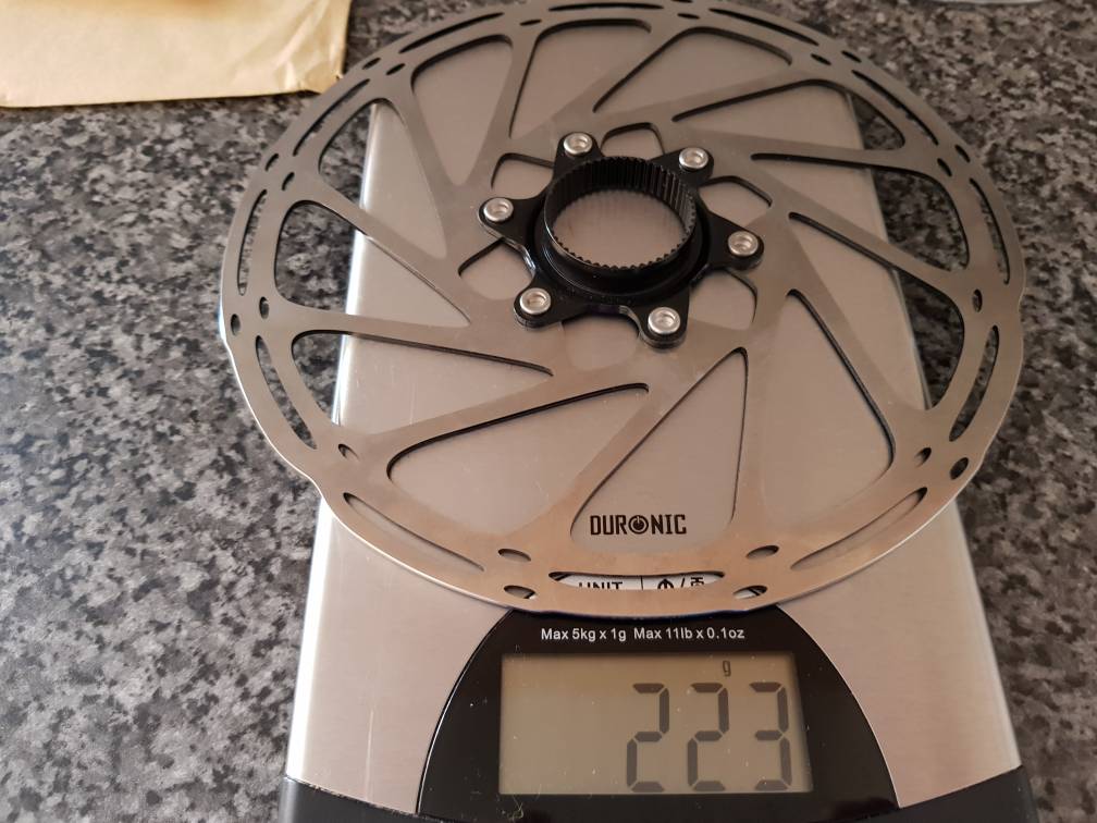

I also had the lightest outcome too. I weighed the 180 rotors, 200s, 200 centrelock and 200 with adapter. Pics below for reference.
That's interesting. There's a few places in the UK that stock the 203 em900 rotor. It's a hefty £69. A centerline at £30, plus £3 magnets, £5 glue is quite appealing, but not as trick.

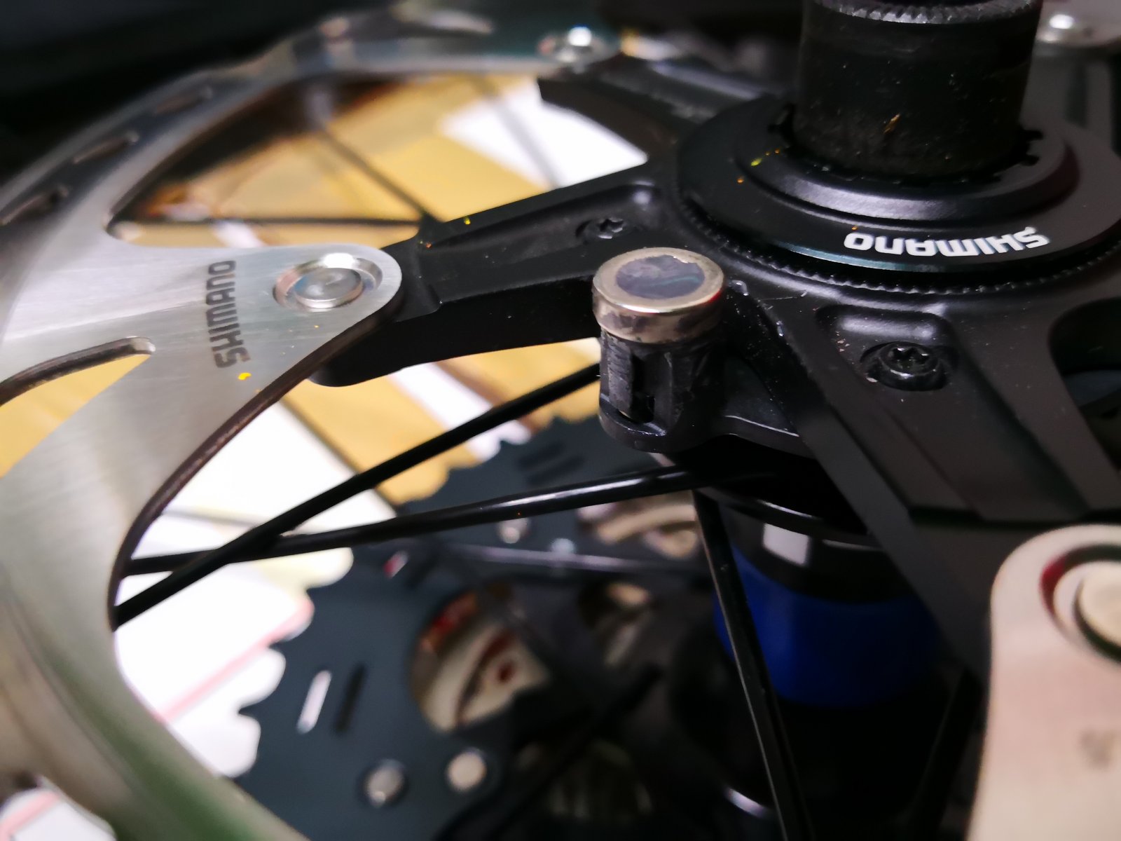

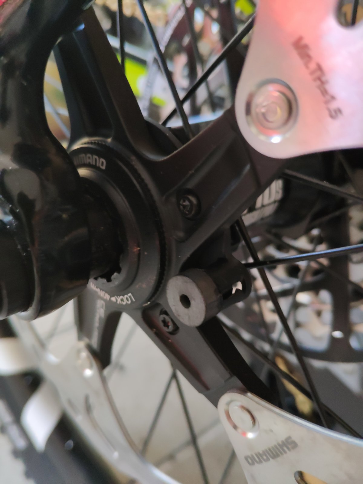

In case some Focus owners are going to play with rear rotors:
The OEM setup uses 6 bolt rotor with a third party magnet holder like this:
If changing to centerlock wheel, the Shimano rotor with integrated magnet can be used, but the magnet is either too weak or it is offset way back compared to the pic above. It may work on other bikes, on Focus it will give W011 error (no speed data detected).
Solved this with a small neodymium magnet with M3 countersink hole thru it (got it on eBay from China, cost peanuts, used them for some other DIY job).
Used JB Weld steel epoxy (saved my bacon few times in my moto days), it is tough stuff.
Made around 500km with the mod, holds well, I think that plastic magnet cavity will break before magnet gets undone. Rock solid.
And set off. Power for 5 seconds then a red and blue light and power loss. Gutted!View attachment 6761View attachment 6762View attachment 6763
I was just reading through this post - I'm gluing a magnet too. I think your problem above is that the magnet is up against the lock ring. The lock ring is magnetic - I think you've made the lock ring an extension of the magnet! The sensor wouldn't work with that - I think it wouldn't record any movement.
As an aside, I measured my shimano rotor with magnet - 68mm diameter. The rotor was still on the wheel on the bike so I used verniers. Essentially, 34mm from center of rotor; easy while holding ruler across centre of rotor.
