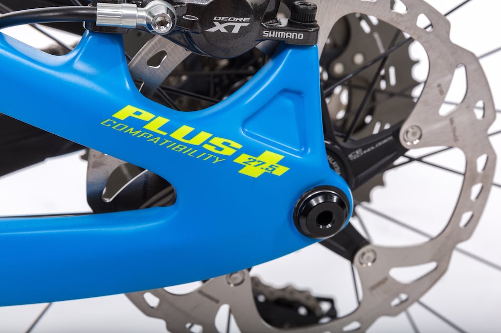

Pivot shuttle has them fitted as stock, so why not put a shout out on the Forum to an owner to see if they can measure it up. Looks to me like the location replicates a bolt mount
yes but the magnet location is the same on all of their rotors, so its irrelevant which rotor you get the measurement from, only that it is an ebike variant

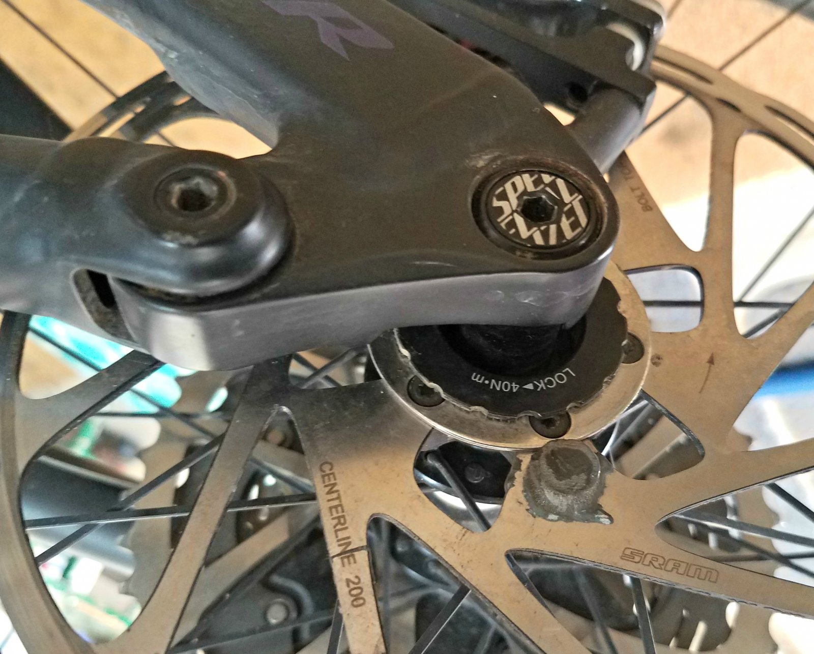

I used a strong neodymium magnet with no adhesive for several months, and it held tight (did carry a spare just in case). Recently added some JB Weld epoxy around it, not between the magnet and rotor, to make sure it didn't shift or get knocked off if something along the trail happened to hit it. (The epoxy is the ugly gray stuff in the photo.)

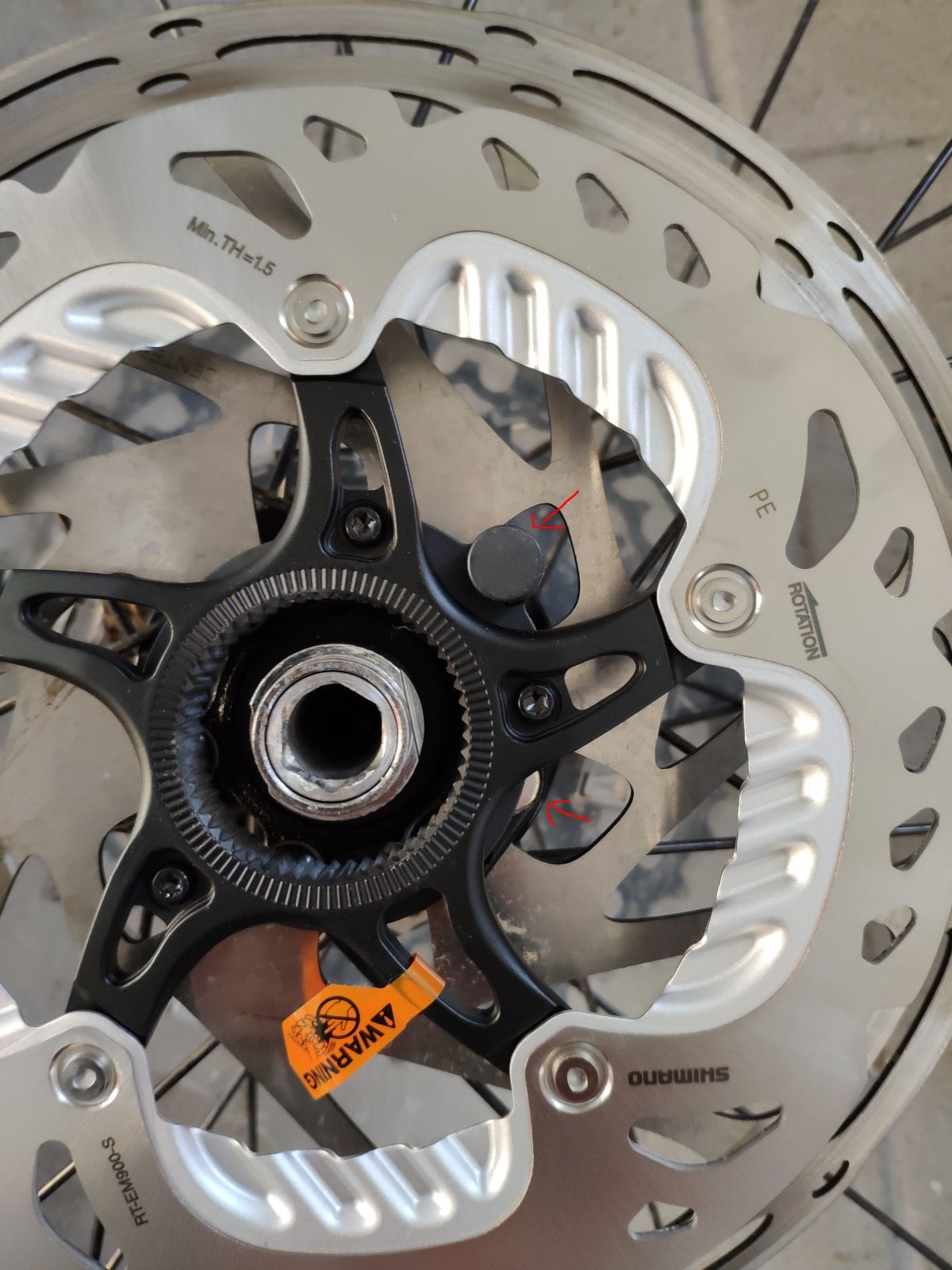

so from what ive researched, centerlock is a shimano invention so i have never seen sram cl rotors. the adapter works for both turbo levo and kenevo as they share the same geometry for the magnet sensor. this is confirmed with my LBS.
This adapter only works with 203mm Shimano XTR SM-RT99 Ice Tech Rotors. Both parts are made out of 6061-T6 aluminum and have a Type II black anodized coating and are held together with Black Torx T15 screws made out of ultra corrosion resistant steel. the magnet is a neodymium N45 strength that is pressed in. the adapter is removable and requires no drilling or glue.
What size was your magnet? I'm gonna order some off eBay for the weekend.
I measured the one in the existing bracket and it seemed to be 10mm x 5mm.

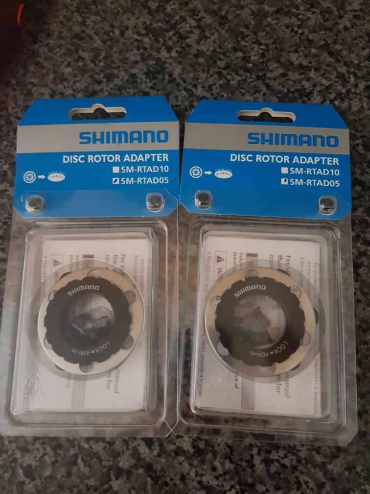

So i've 2x Shimano adapters arriving tomorrow on Next Day. Let's see what happens. If i can't ride my bike this weekend i'm gonna be pissed off.

Rare earth magnets (30 MGOe to 55 MGOe) are plenty strong enough to stay on a steel rotor even without epoxy support. I bought several types and sizes (they're inexpensive and fun to have!) and settled on the 10mm x 3mm Nd42 (shown in the pic). No need to move the sensor. A Google search should return several suppliers to choose from.
