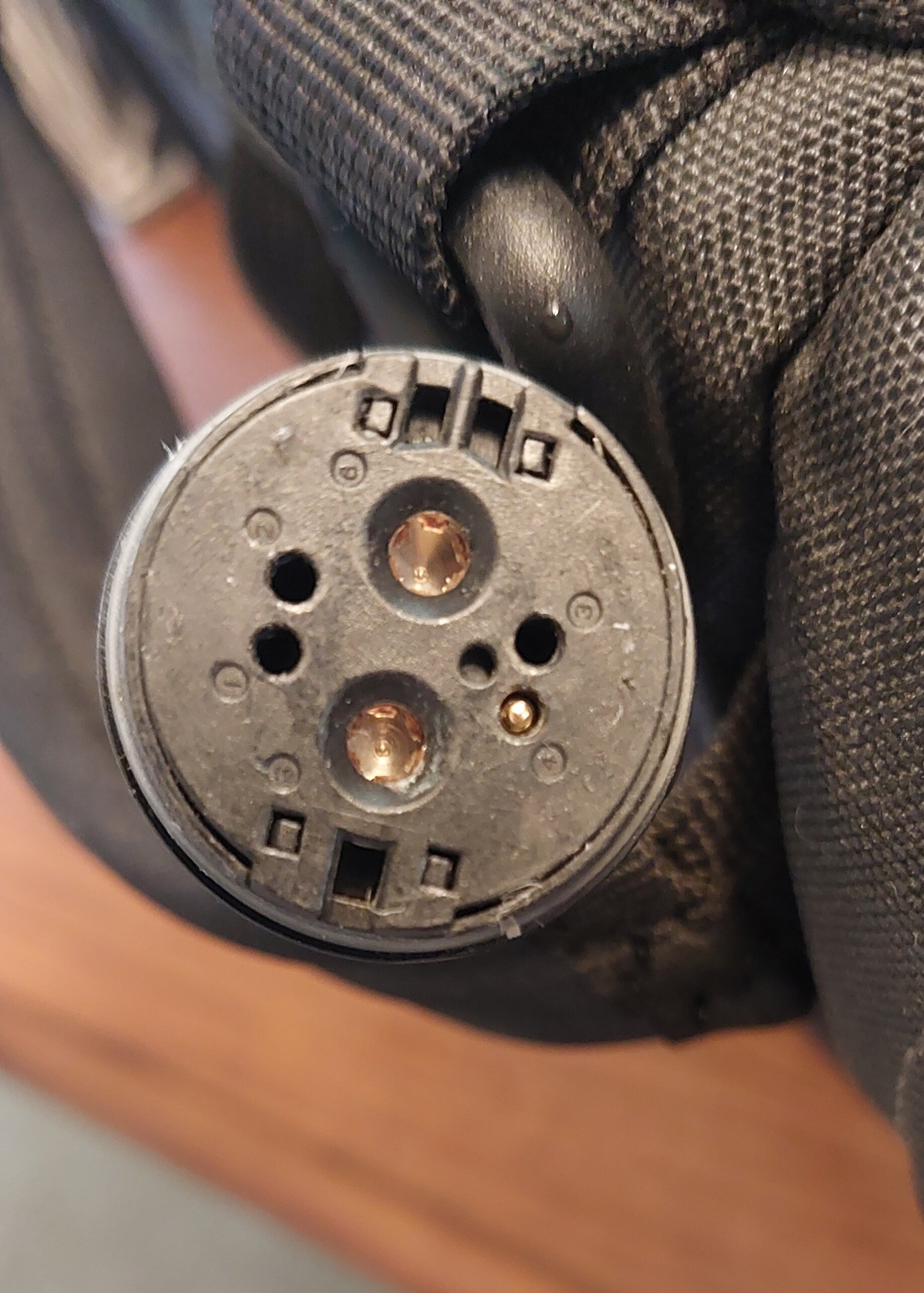

I need to figure if my new SPecialized battery charger is missing some pins? How many pins are on YOUR Specialized charger? Just ordered this brand new charger from Ascent Cycles (SBC-C04). The charger magnetically connects fine but never goes from green to red (to indicate charging) on my como 4.0. When you look at the pins on my charger, some appear missing. Is this how they all look? So do the pins on mine look like the ones on yours or did I somehow get a bad charger?

Are you plugging in to the wall outlet first or the battery first. Manual states wall outlet first. I have other bikes, brands that are just the opposite.
Have you checked in Specialized App that Battery Charge limit isn't affecting it?
Specialized App - Bike Settings - Battery Charge Limit
You are a genius! New bike, the limit charging was certainly selected, that was it. You all are great, two answers, same day, solution found.
