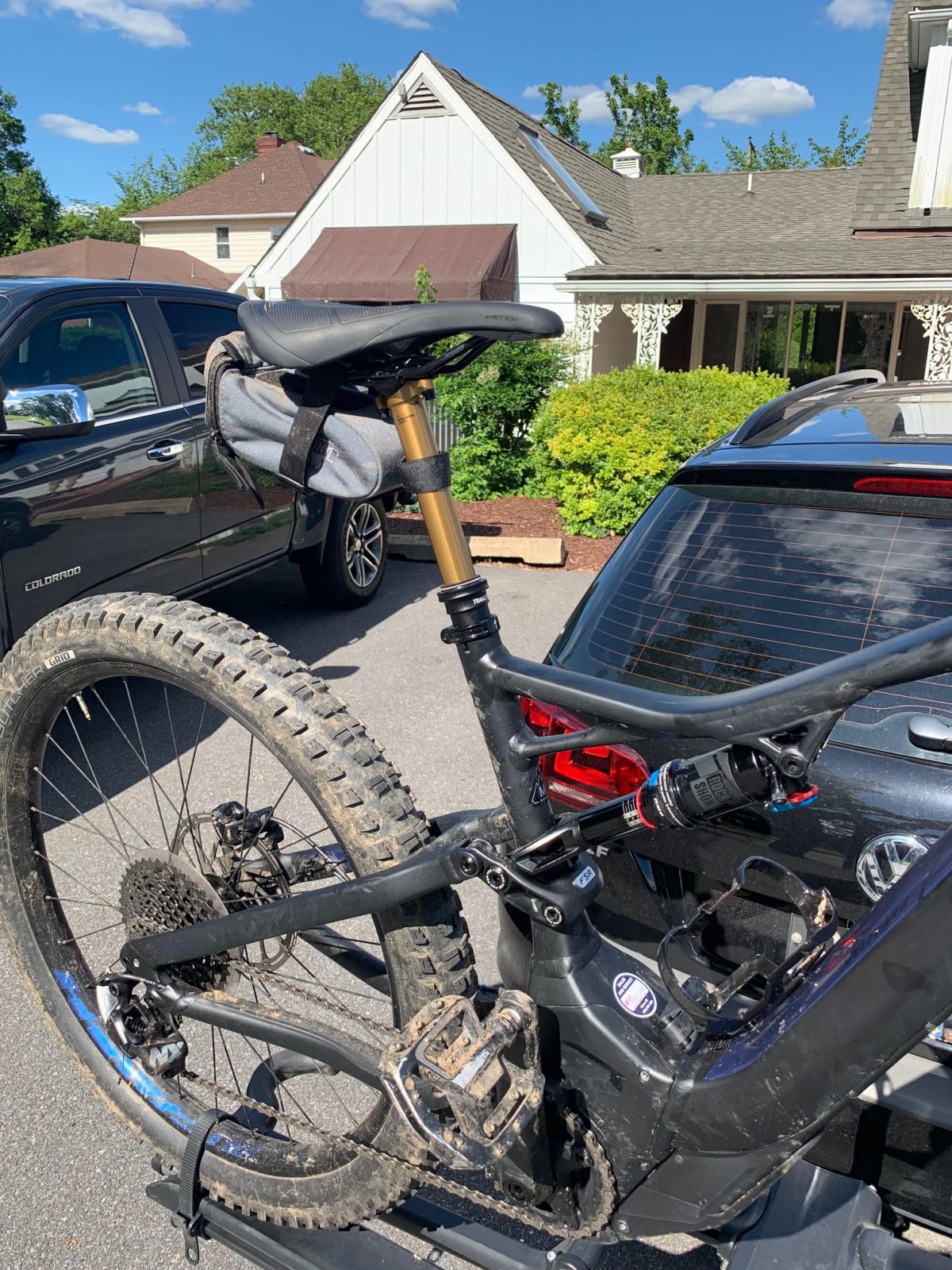

Wow, it was super easy, pulled the battery, opened the plate on the left side, piece of cake... No2 I just have to learn that the lever isn't a shifter, my instinct is to go to it to shift... which of course won't work!
