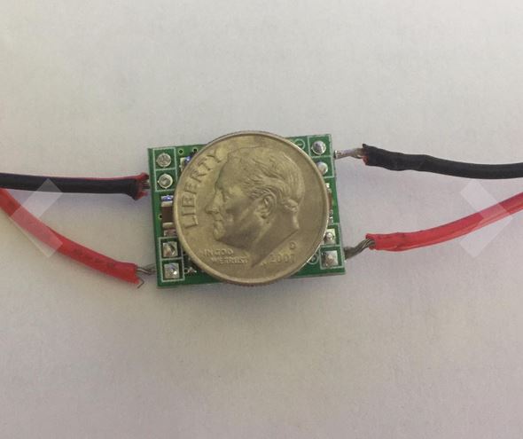

My lights normally run on 7.2 volts. Bike outputs 12 volts. Do I need a voltage converter ($6) or can these lights run on 12 volts also?
Not sure but 2 amps at 12 volts is 24 watts. That is a lot of watts for an LED light. So I doubt it uses that many.
serfas told me no, 12 volts will burn it up
I ordered this from Amazon ($7.55): "6 Pack Mini MP1584EN DC-DC Buck Converter Adjustable Power Step Down Module 24V to 12V 9V 5V 3V (6 Pack) "
You can put this inside the top tube where the main bike power button (on the 2019 or 2020) is, or leave it outside on the handlebars.

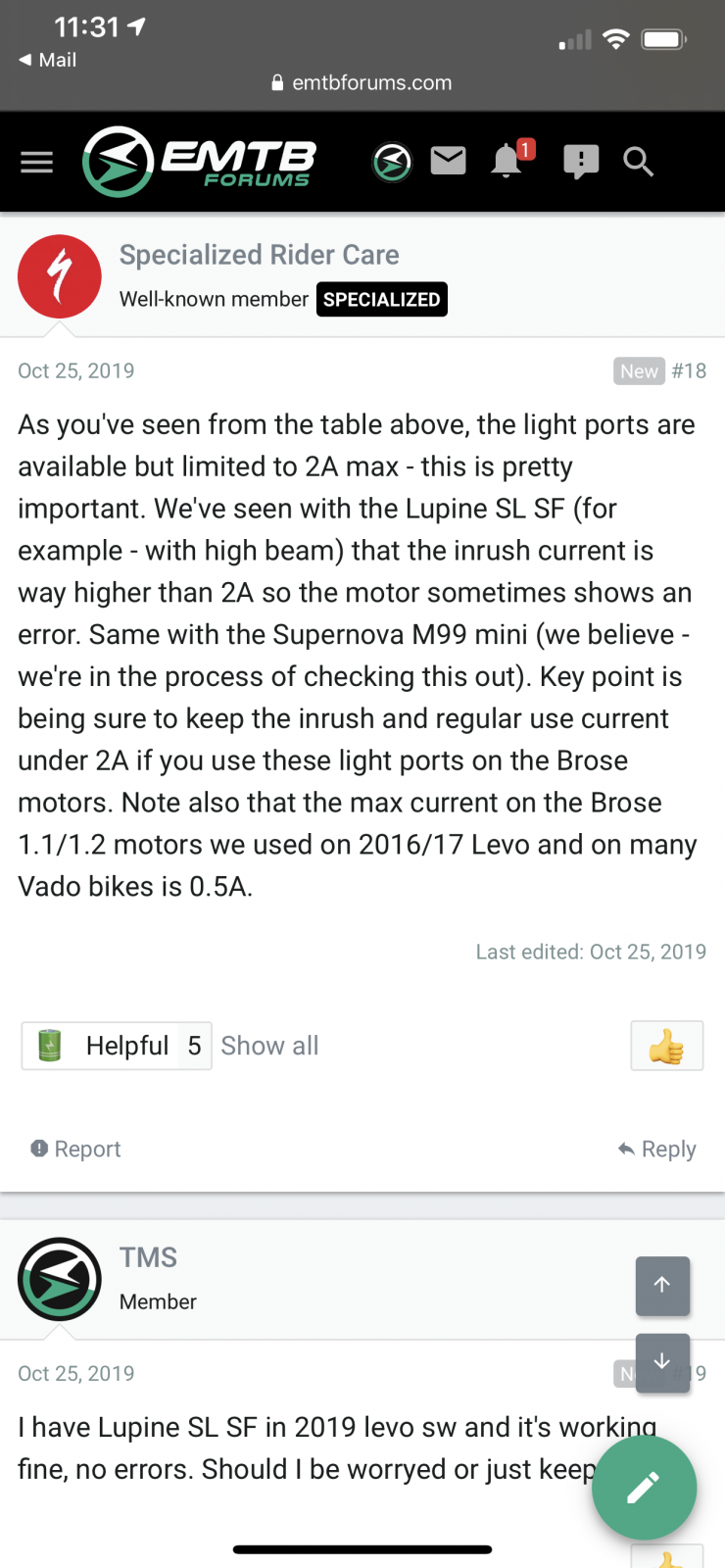

The limit is 2A@12V = 24W on latest Brose Drive S Mag motors ...

Max power is 24 watt by specialized, no need to examine that. I have Lupine light max 16 watts. I think you can't draw 24 watts when convertig the voltage to USB level. If depends the specs of converter. Maybe only 10 Watts and 1.5-2.0 A.
Specialized saying it is 24 watts doesn’t mean you can draw 24 watts.
I have tested a lot of 6 amp power supplies and you can‘t draw 6 amps from any of them. You usually use 60-80 percent of the claimed rating.
Great link.
They say the startup current exceeds the 24 watts. Startup current is always part of the deal. So that light is just too much. It sometimes works though, so it must be right at the threshold.
My sense is you won’t hurt anything by using it. It is possible the bike will kick out an error code in the future, in which case if that happens you can use something else later.
