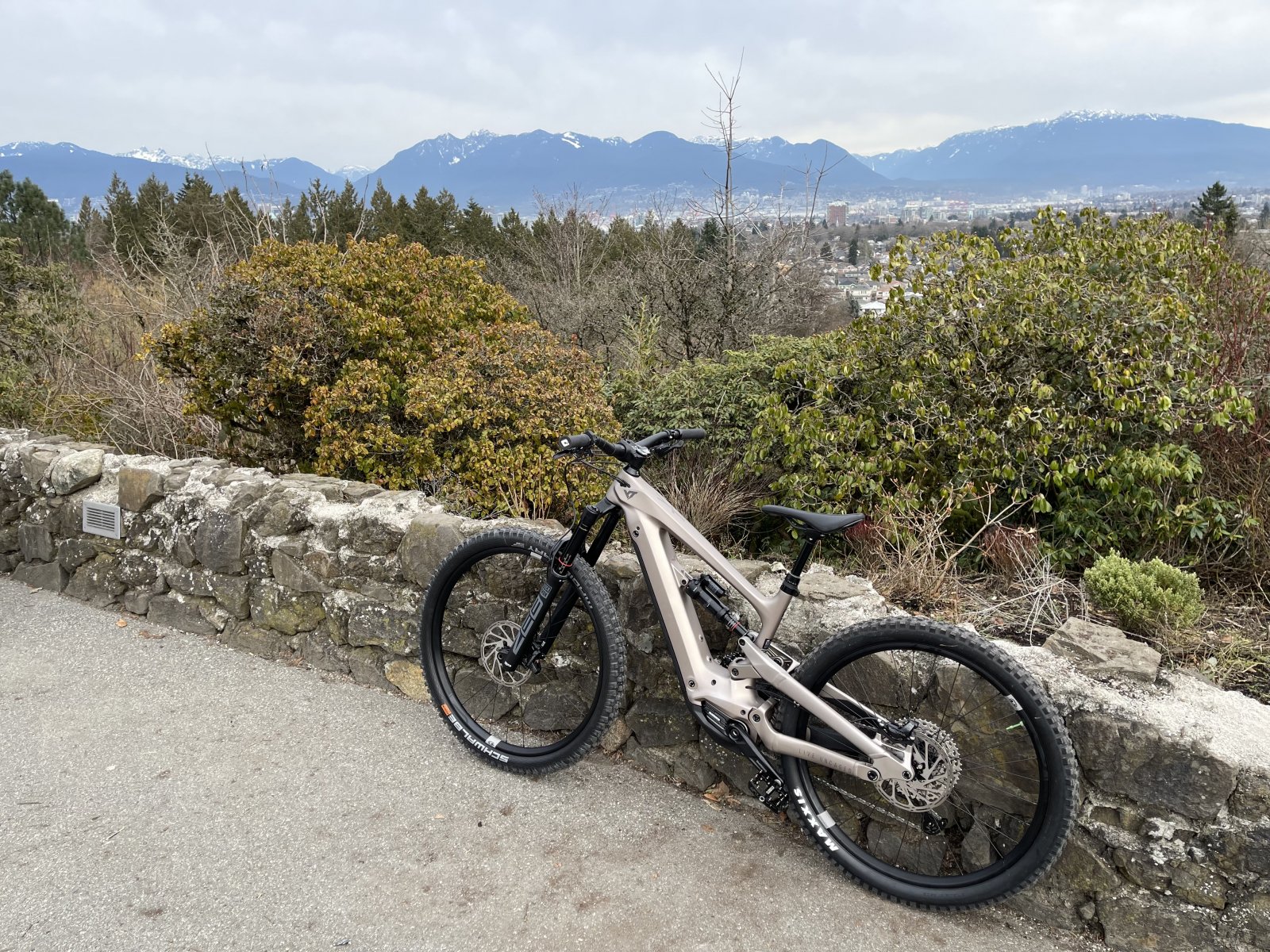

Setup the Core MX 2 today. Love everything about the bike, but oh boy those SRAM R brakes are a pile of crap. Friggin death trap on such a heavy bike. Those will be pulled off, and a few more minor adjustments to the cockpit and the bike will be good to go.

How long have you ridden it for? It took mine ages to bed in, I was thinking I definitely needed better brakes but they came right after a few rides. Now I'm really happy with them.

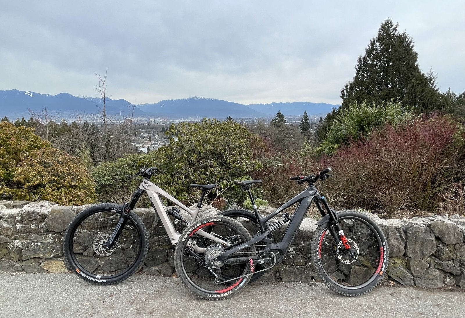

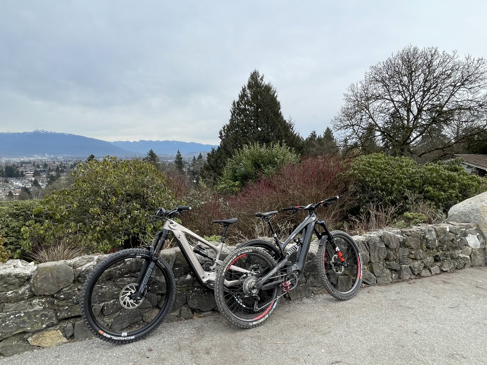

I've been riding the black Decoy in the photo for two years. The other bike is my wife's bike that arrived last week and we put it together Saturday morning and then went for a first ride. We'll give it a few more rides before swapping the brakes out then if they take a while settle in. Everything else is great about the bike. The Zeb is a super nice fork - amazing YT put such a nice fork on their "entry level" bike!

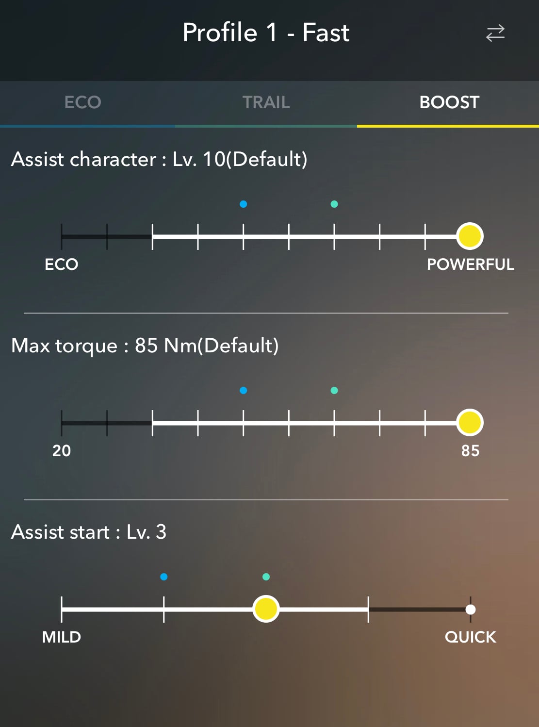

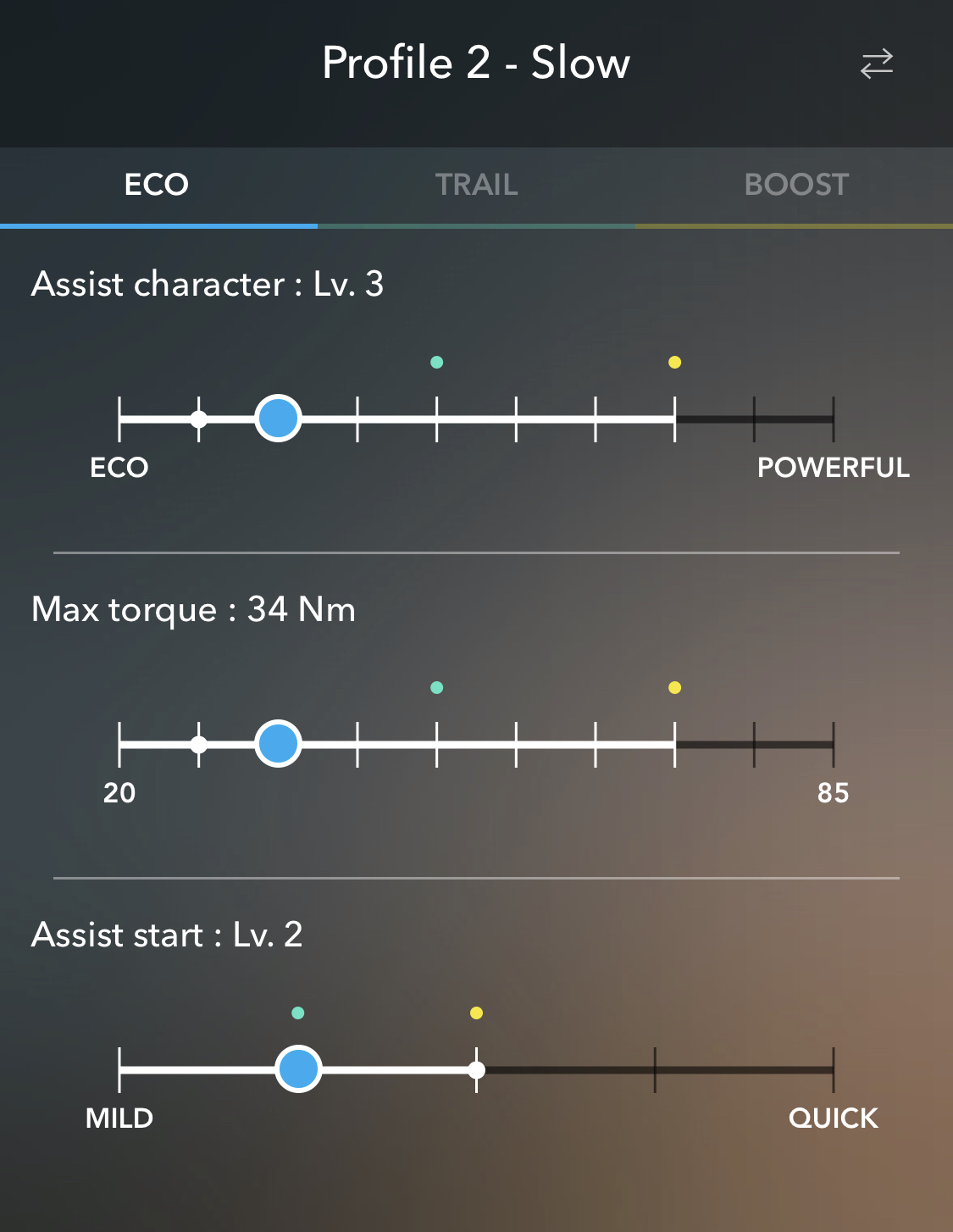

Yes the amount of configuration with the EP8 is great. I also have a Commencal Meta SX Power with EP8, and I always felt the motor was more powerful than my Decoy/E8000 but it was definitely confirmed when riding with my wife. The two different profile settings are great. I use Profile 1 when riding by myself or with other ebike riders, and Profile 2 when riding with the legacy guys. I was riding last night on Profile 2 with a legacy guy, and it's definitely a good work out on the climbs in dialed down eco.

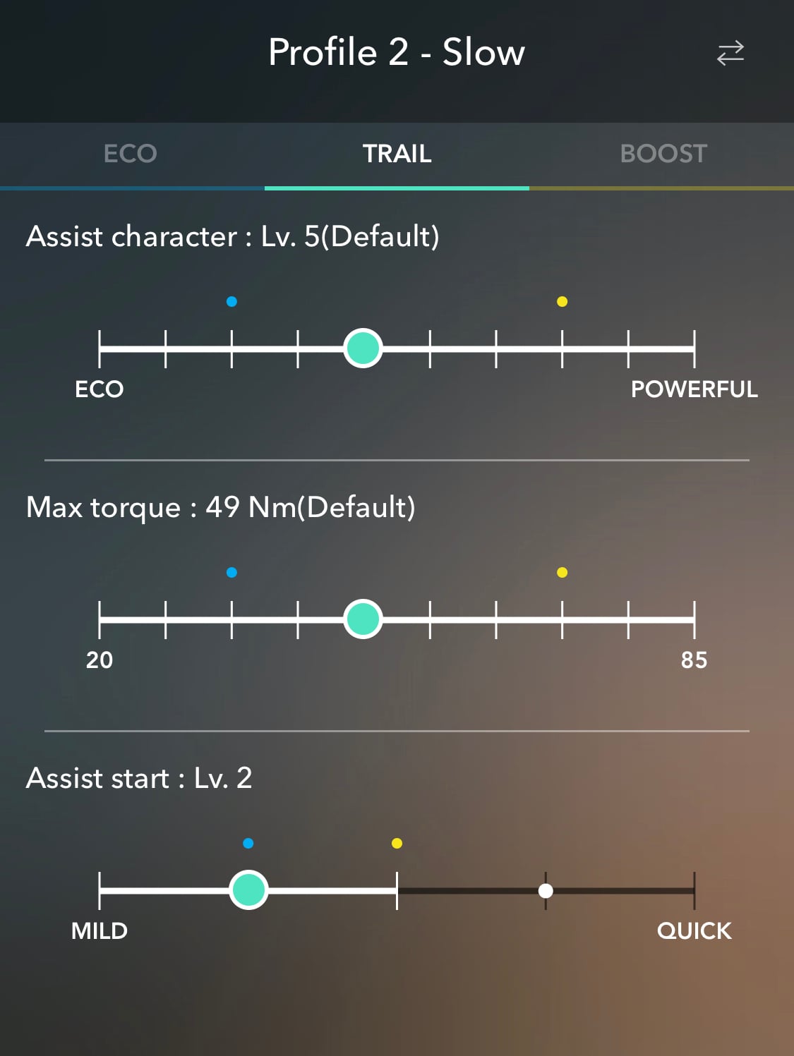

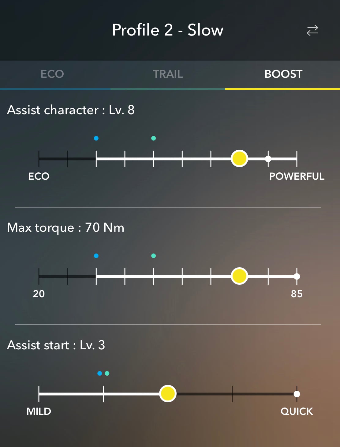

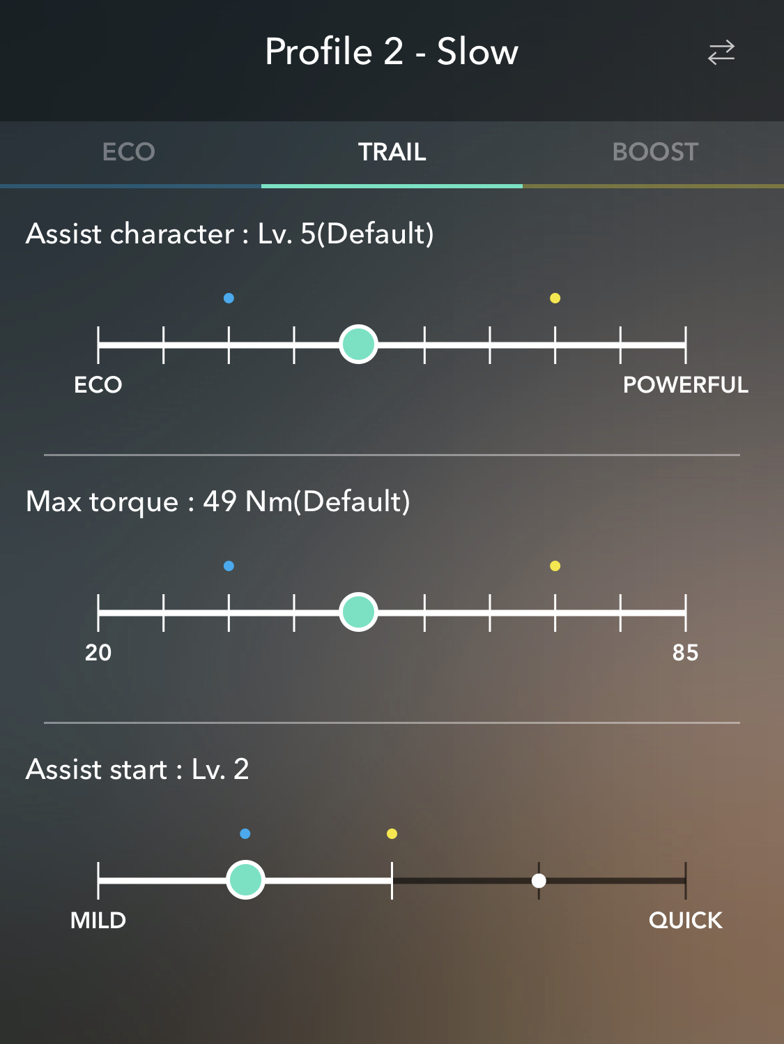

There is a short but steep climb that I am struggling to get up. The problem I have is that I am stalling almost at the top. I have tried everything I can think of and taken suggestions form others too! Now I have a new suggestion to consider that feels counter-intuitive, but it might work.
My mate has suggested that I try a low Assistance Character level instead of level 8 that I have in Trail, or the level 10 that I have in Boost. I have set up Profile 2 to do just that but have yet to try it (I've opted for level 3 which is the default minimum level suggested by Shimano). I am doubtful, but I have never been below level 5, so I don't know for sure. What do you think?

I do prefer the lower settings for steep technical climbing, especially if cornering is involved. I also find keeping the rear end on the seat helps - even if it’s just the very front of the seat. Steady cadence is more important than aggression.
I checked the settings on my Meta this afternoon and most are out of the box for profile 1 and 2 and eco/trail/boost for both.

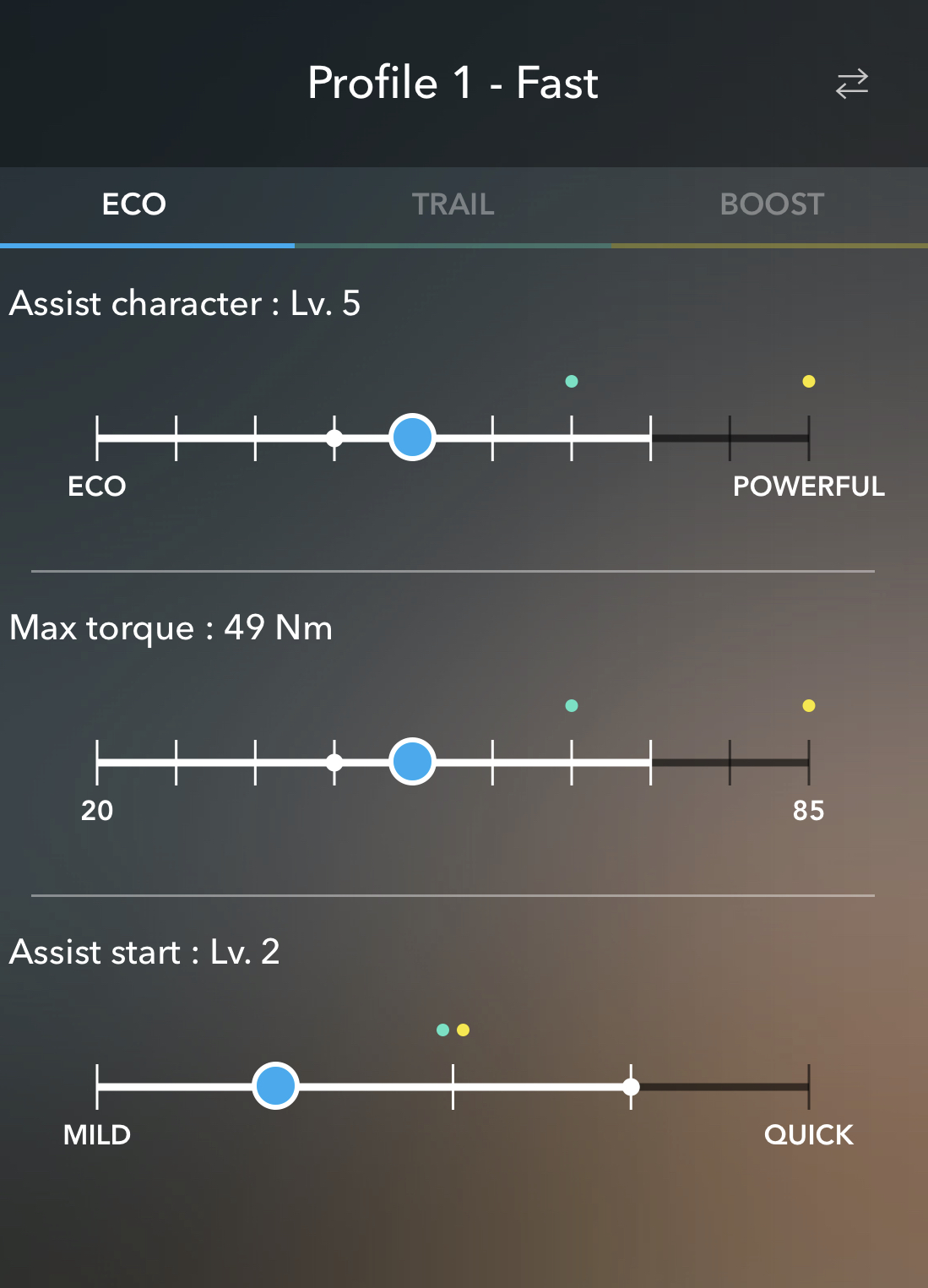

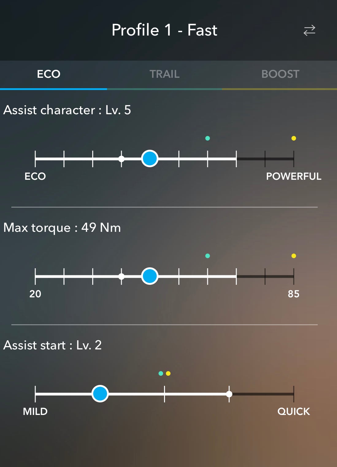

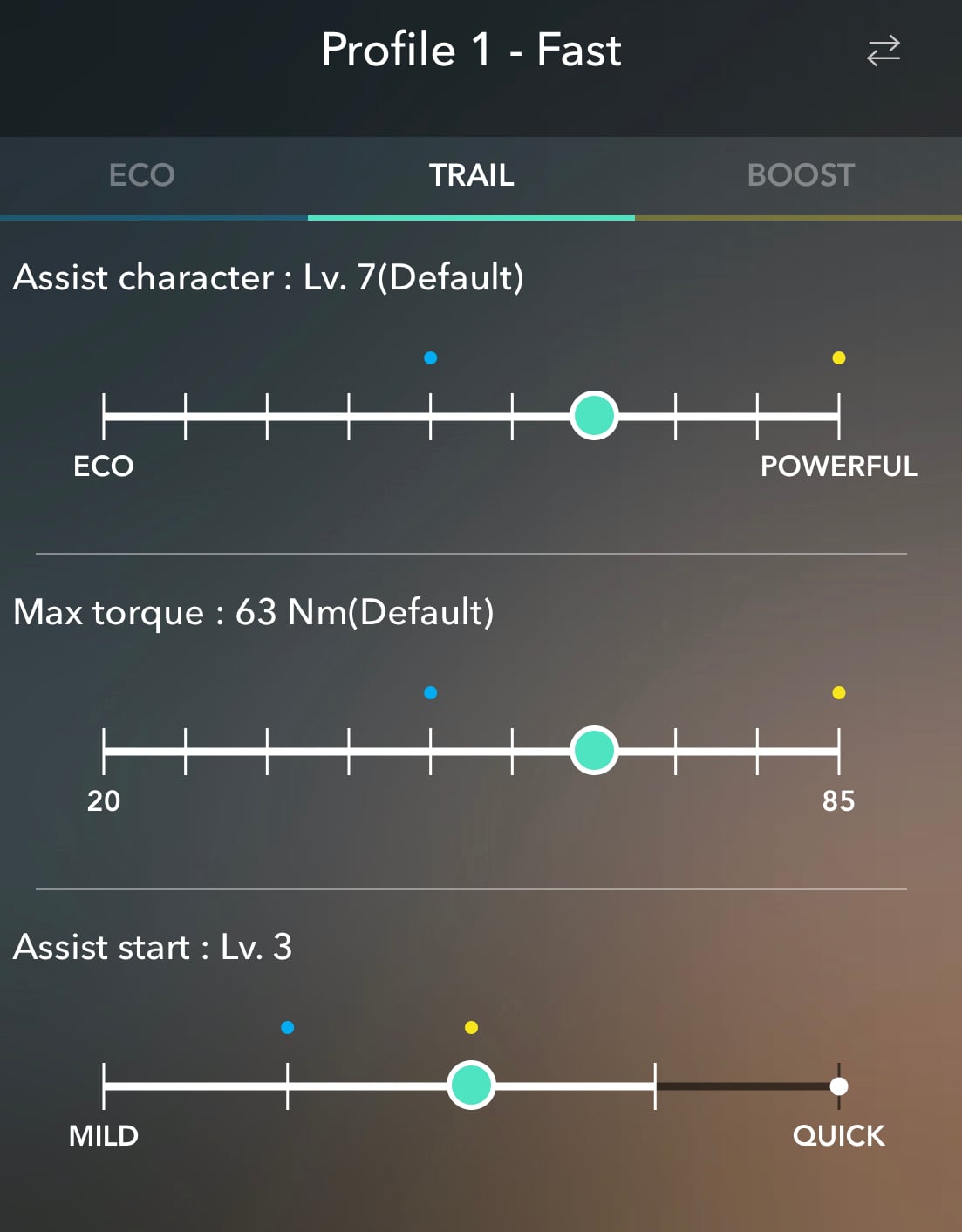

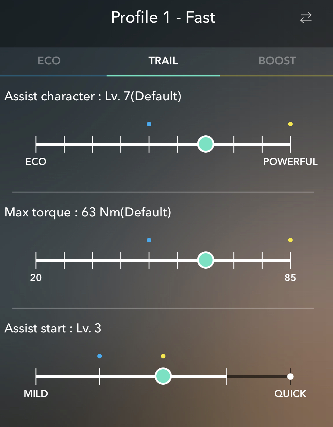

I checked the settings on my Meta this afternoon and most are out of the box for profile 1 and 2 and eco/trail/boost for both. View attachment 81308 View attachment 81309 View attachment 81310 View attachment 81311 View attachment 81312 View attachment 81313
I think they're giving you too many choices. If it were me Eco- MAX, Trail- MAX,Turbo- Anything higher than MAX ? 😀
