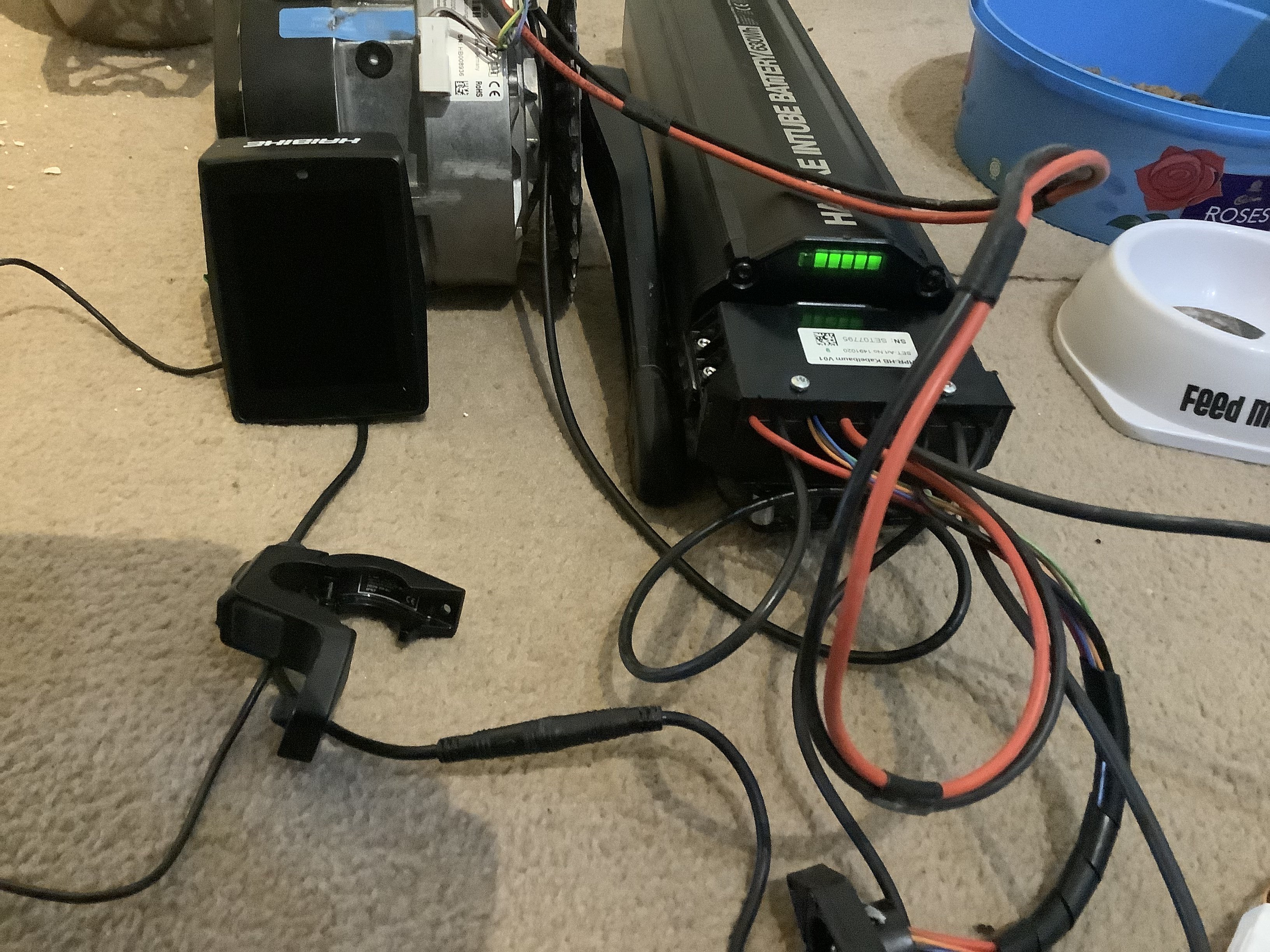

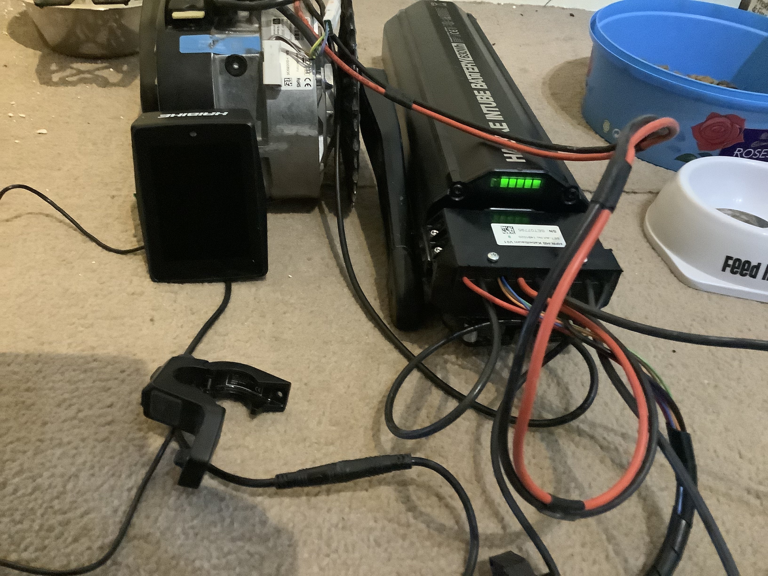

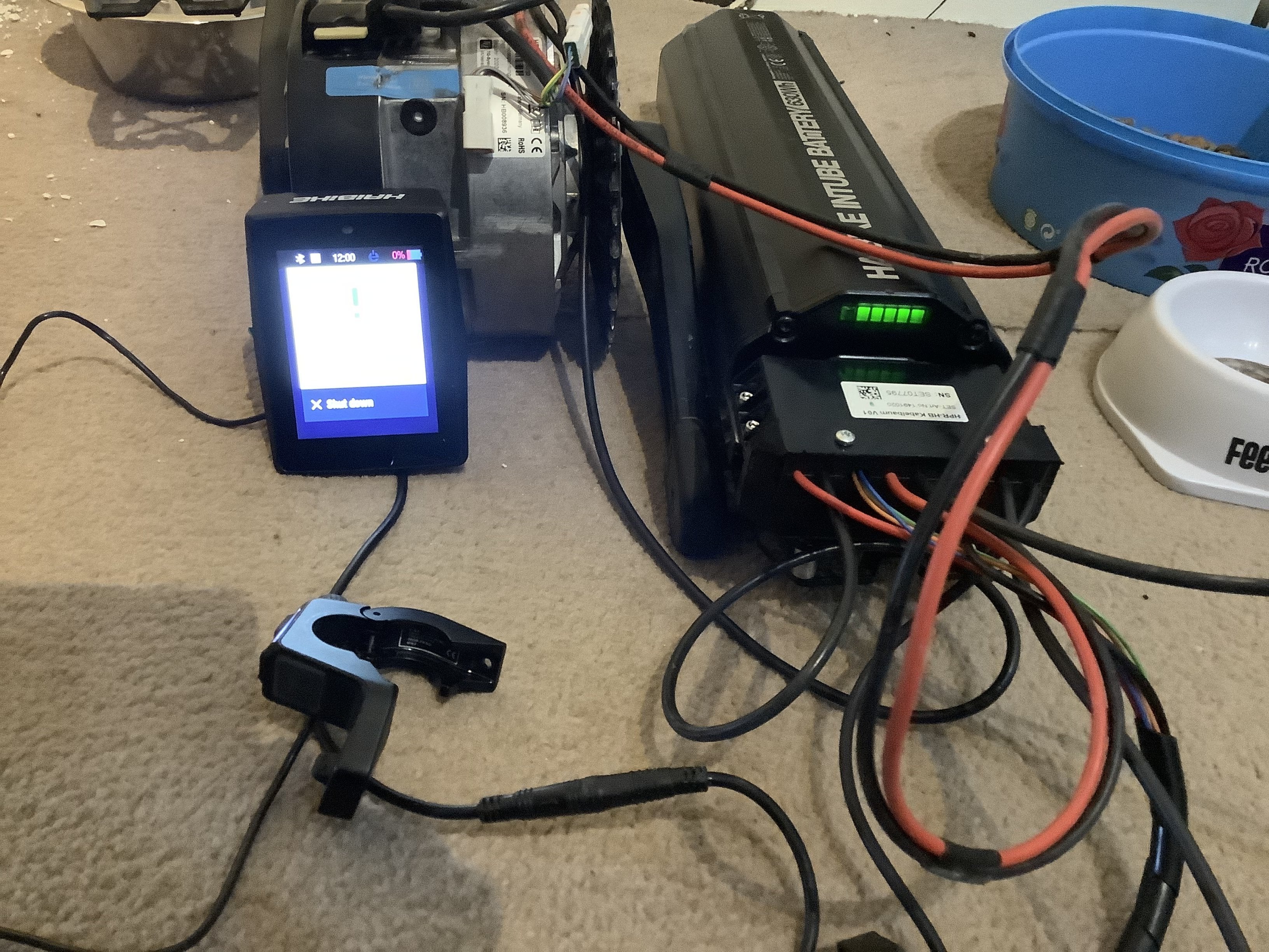

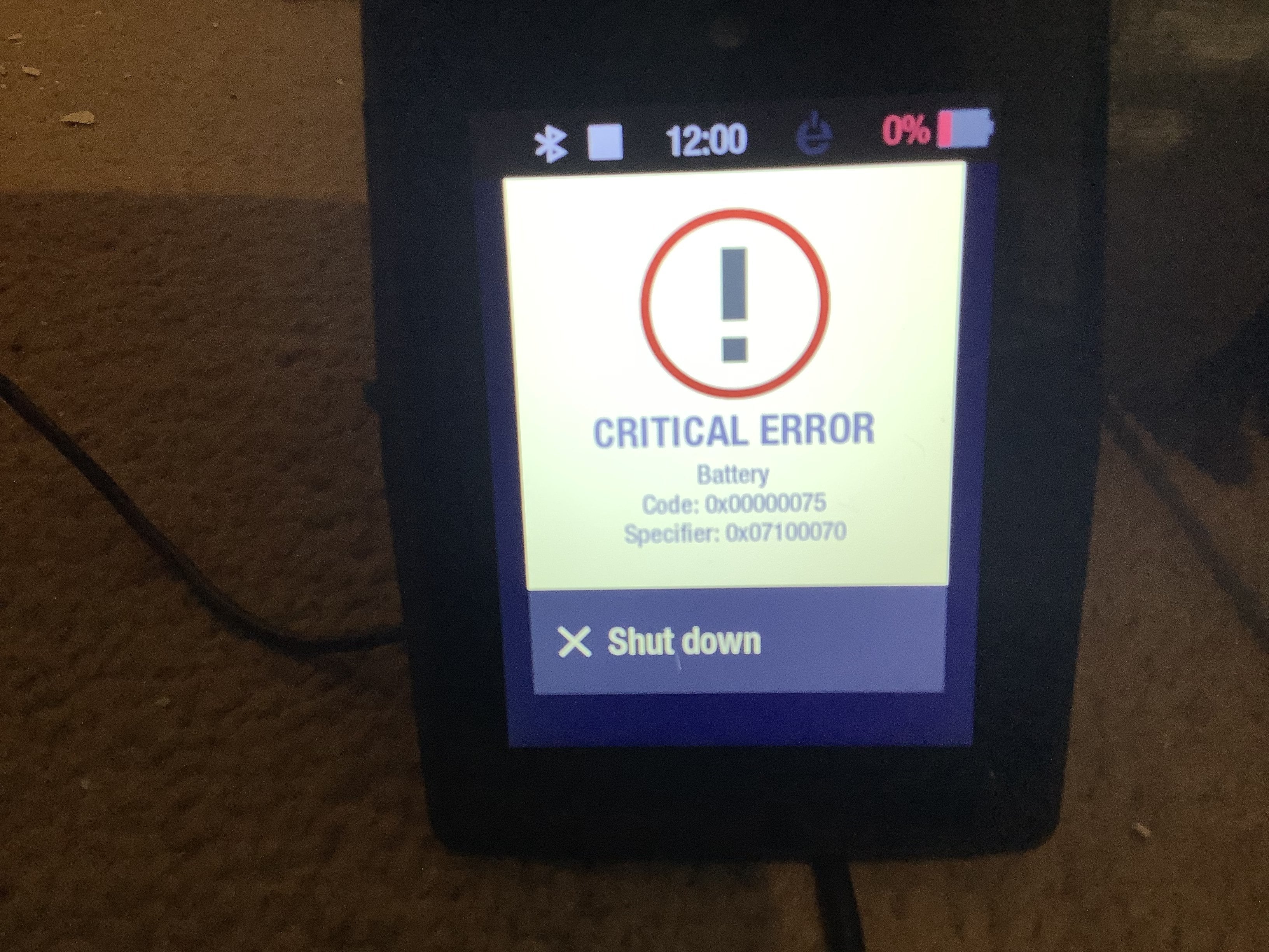

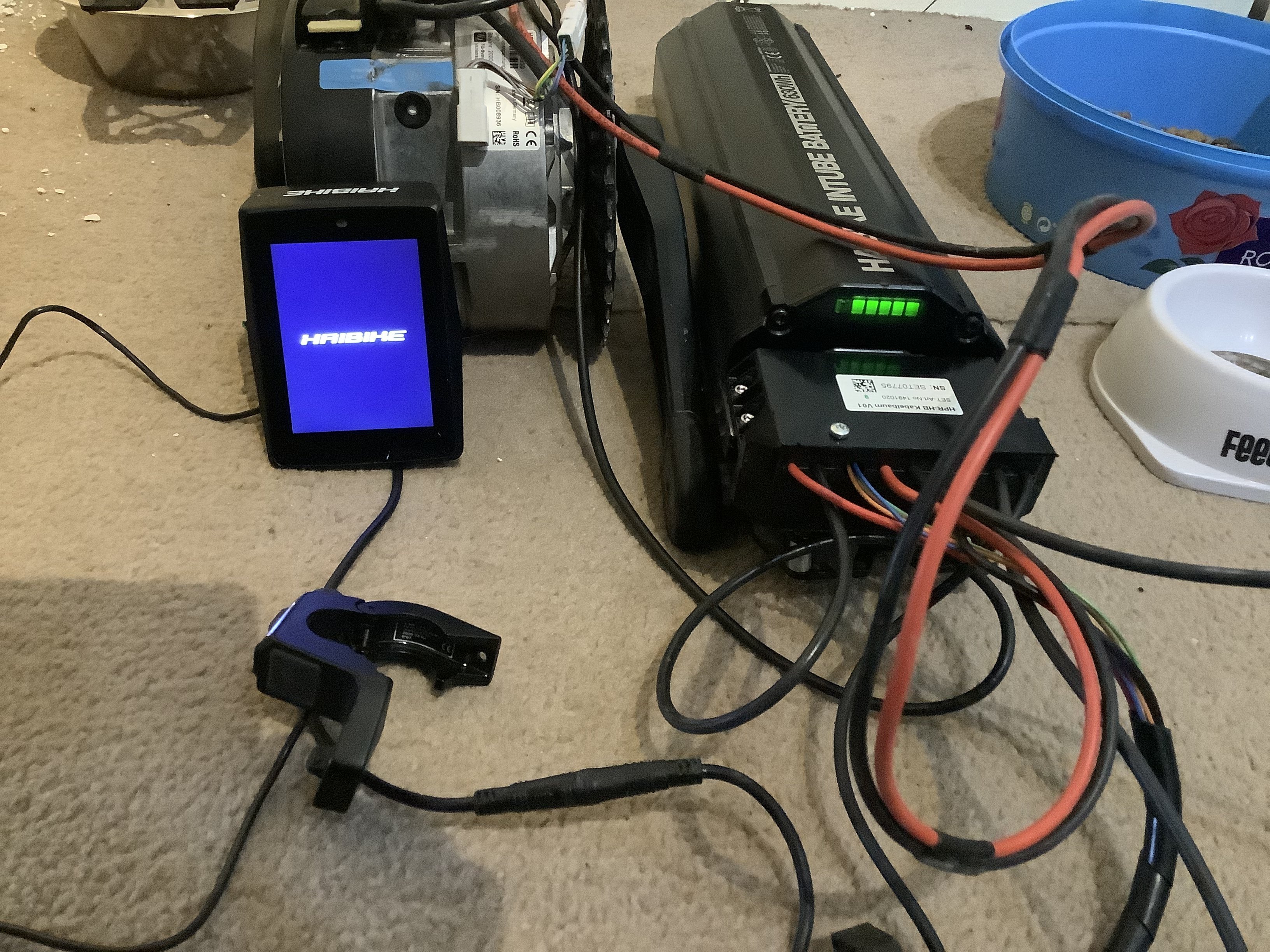

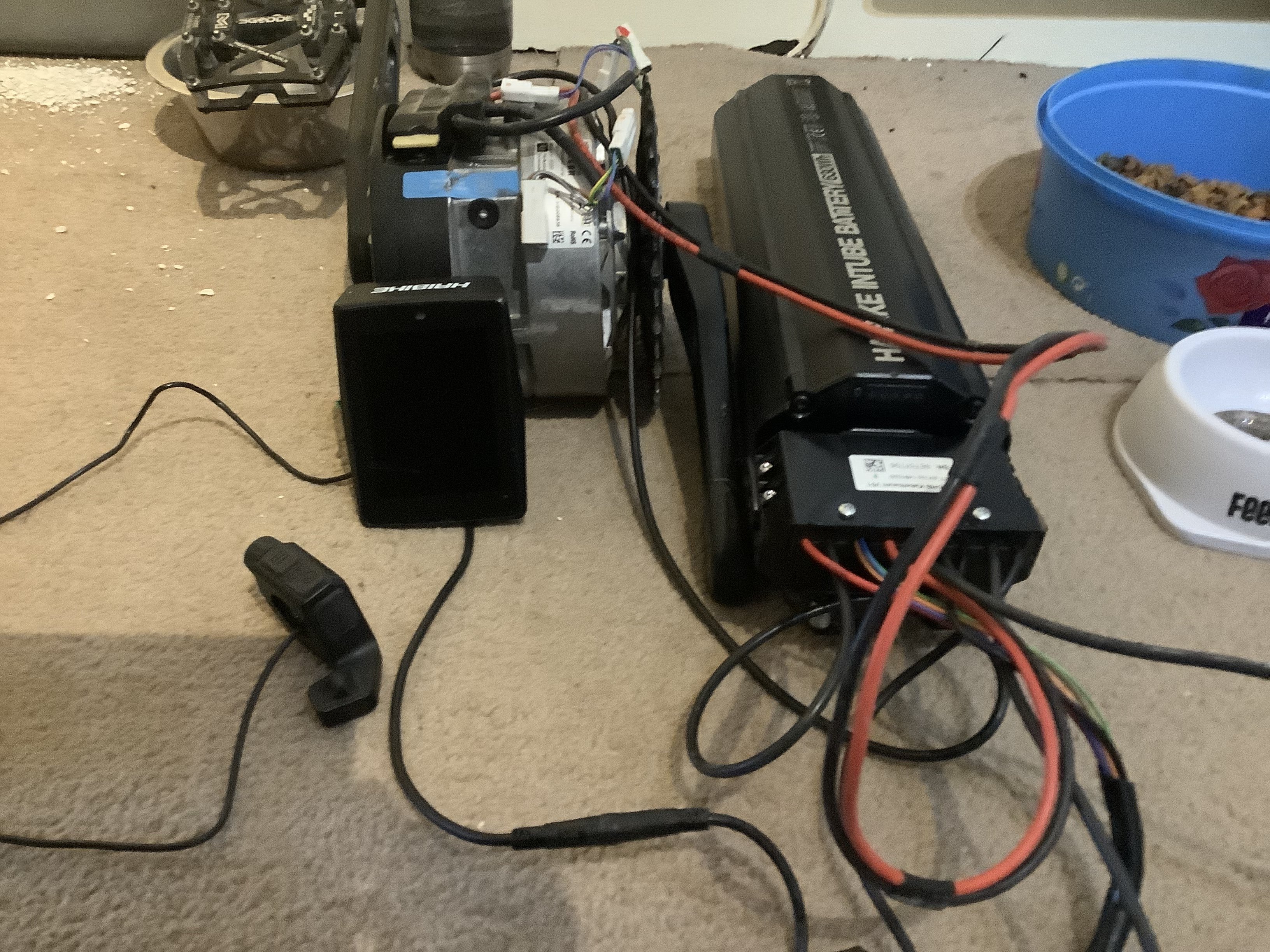

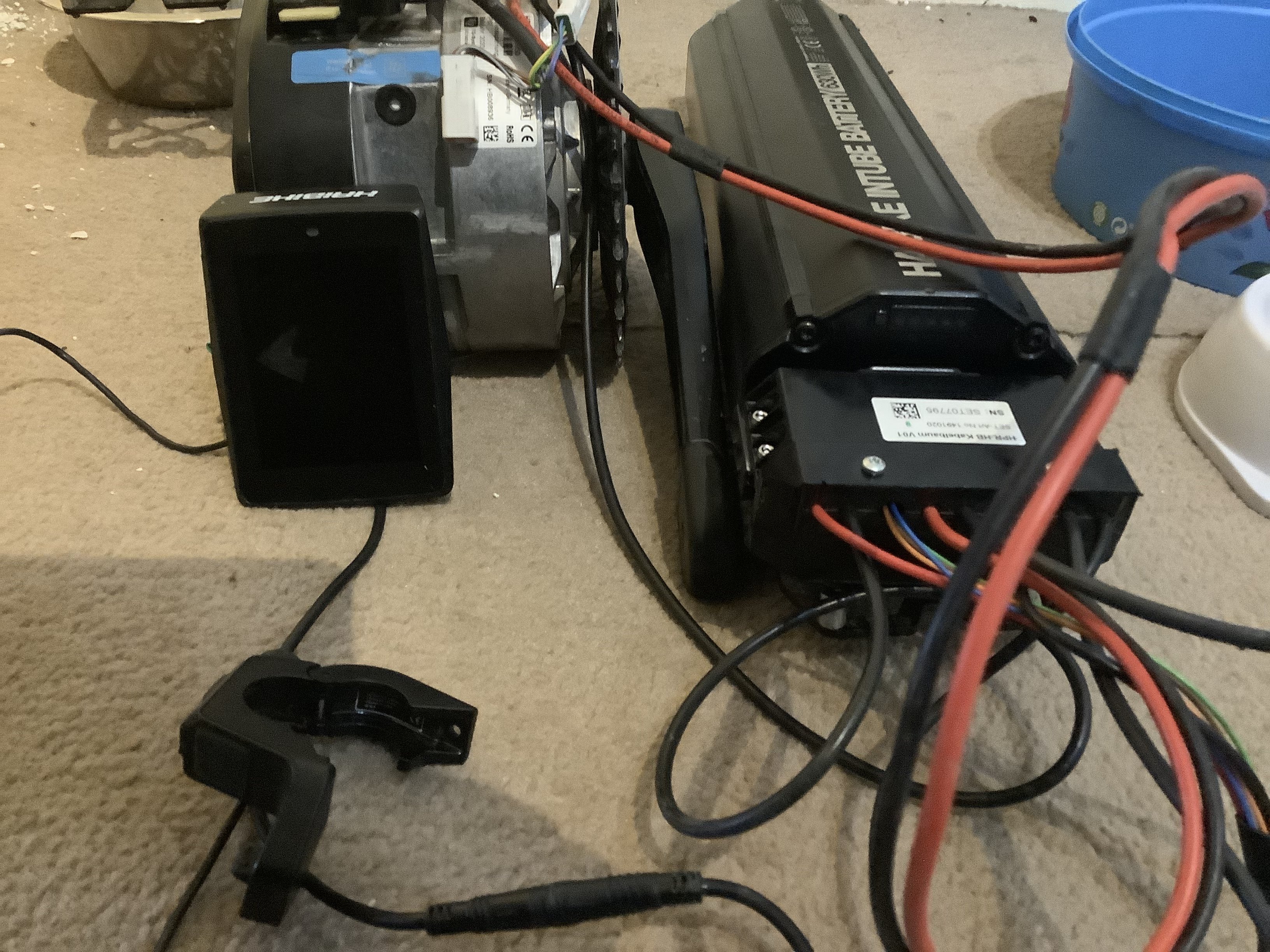

Stripped the bike ,all wires are ok ,switches on ,go’s error switches off
3A4B6B0E-8190-4416-BE1F-668F8AA881B3.jpeg 0894CAE8-CEA4-4C67-8C32-6C98253A2044.jpeg E6FDAA39-764F-45A6-8493-D007591C84BB.jpeg 0904FBCF-3148-4250-B52C-46FDBC5B7F64.jpeg 2A25DA3F-1E69-4D57-A015-2BAD26AD3021.jpeg 385E211F-58A0-4A5A-80E6-3EF30F78BDE5.jpeg 4C3CE90F-3B6D-4A94-A621-267A29DEA707.jpeg
So if i got a similar battery 48 volt 360 wh as my flyon did a bit of wiring magic do you guys think there might be any problems ,or would it go bang lolololo
I'd be interested to see. I think you must have the volts the same across the two batteries, and our are 50.8v, which i imagine is not easy to find, although i have not looked for a second or smaller Wh battery. But im interested in what you are trying to do. i'm considering trying to build something too.
