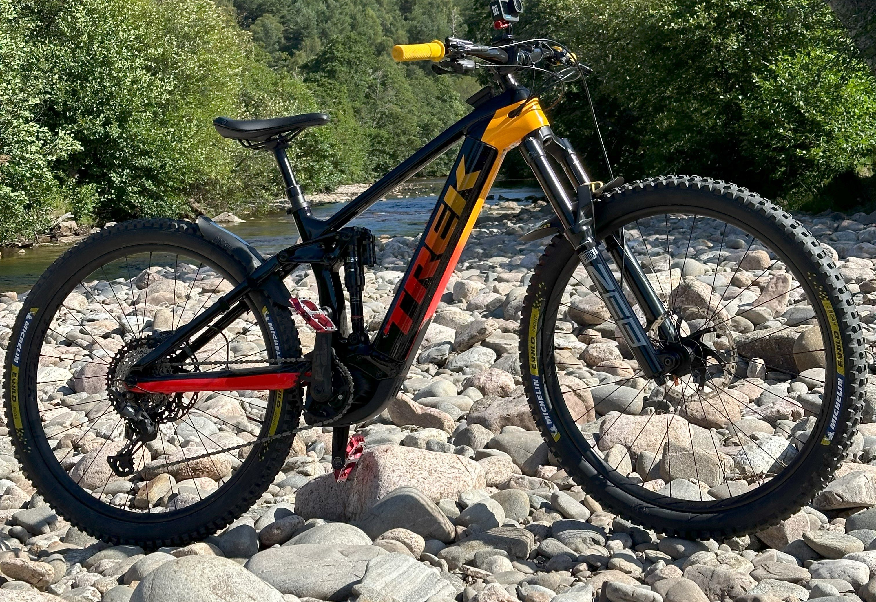

Well thanks for all the advice. As you can see I eventually went for the
Michelin E-Wild Racing Line 2.6​
Absolute magic for the conditions as originally detailed. Sooper draggy on tarmac but that's not what they're designed for. So at the moment like very much..
