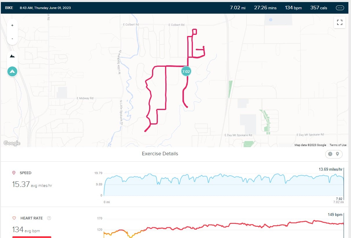

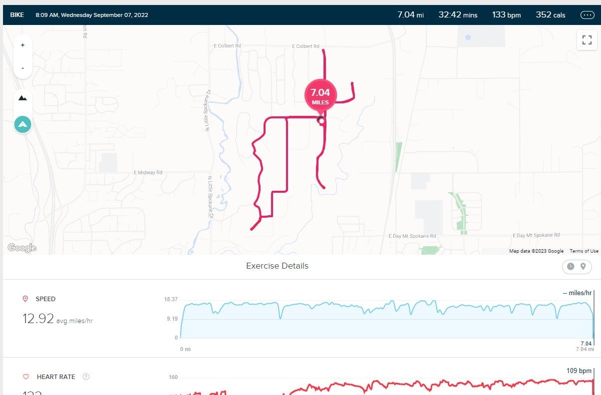

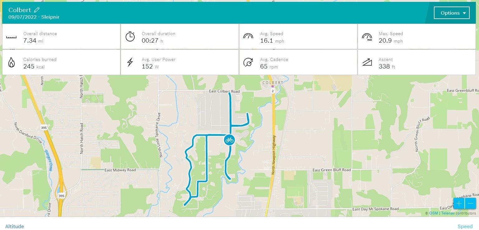

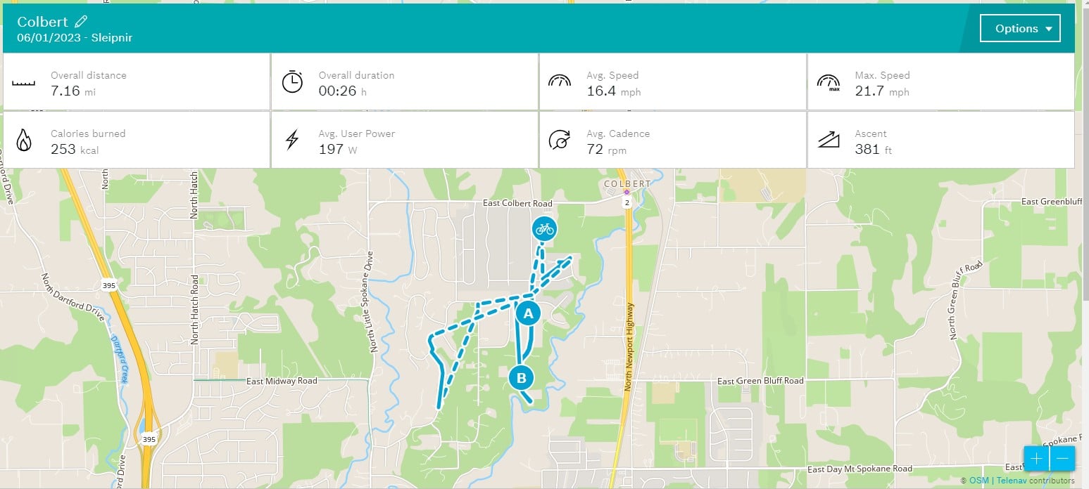

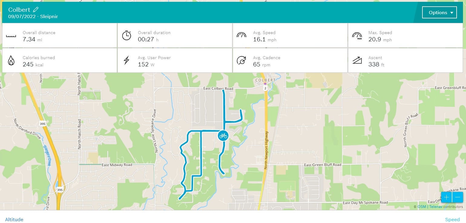

Hello, new forum member here. I did a search but did not find the answer.
I live in a northern climate where we get a fair amount of snow. That means outdoor riding stops for me in the fall and picks back up in the spring.
I have a Bosch ebike with a Kiox computer. I use the eBike Connect via Bosch and FitBit simultatiously to track rides.
Last fall the mapping matched nearly identically between the two. Since I started again on the Spring the FitBit map is consistently accurate and the eBike Connect map is a mess. Same phone device, same GPS access. It appears that the location polling is far more infrequent now on the eBike Connect. Does anyone know the trick here? Is there a setting for adjusting poll frequency? Examples attached.

So today I watched the connection checkmark in the lower left hand corner of the Kiox display very closely. My phone is also mounted to the handlebar about six inches from the Kiox unit. Several minutes into my ride my phone screen went to just the blank screen with the time displayed. Shortly after that the checkmark turned yellow indicating that the connection between the phone/eBike app and the Kiox unit had stopped. I 'woke' the phone up and placed it on the fitbit app screen. Every few minutes for the remainder of the ride I swiped down on the screen to evoke a sync between the fitbit app and my fitbit device. This process kept the phone from going into any measure of sleep mode for the apps.
The result after the ride was such that I could see a short break in the mapping on my ebike result around the time the checkmark was yellow. The remainder of the ride mapped perfectly. I conclude that under the same conditions FitBit can keep its GPS active in the background and eBike seemingly cannot. I am running Android version 13.

I went for a ride this morning as well. Watched the connection icon and didn't lose connection for the whole ride. The map detail level matched perfectly between The FitBit and the eBike apps. So that portion is now working. Will have to monitor to see if the re is now an adverse tradeoff with the eBike app and battery life.
