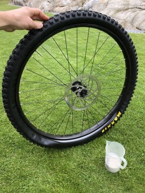

I used the 3 euro kitchen measuring cup to pour the sealant. Just have to remember turn the wheel before pushing rest of the tire into rim.
The grey part is the cushcore insert.

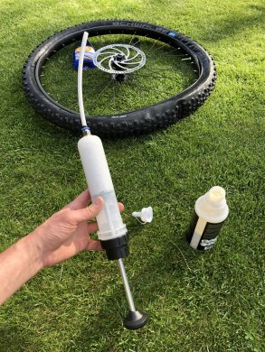

I also bought a jumbosize syringe from local automotive store Biltema as I thought it would be handy to push the sealant or get the sealant out of the tire when changing tires. This was never needed as there was not much free sealant flowing in the tire when I had to do the first tire change. 3 euro kitchen hardware did the job. The blue bottle is some random textile shampoo for car interior - used it as lube for the tire.
