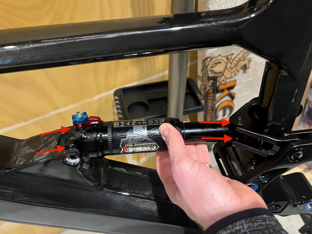

I went with a glossy frame / still part way through build as I wait for parts, but happy with the decision (hard to photograph). Black & glossy, but can see the carbon fibres when looking close.
Here is a close-up of part of the frame from an earlier post:
rear-shock-jpg.89091

wow that's beautiful!

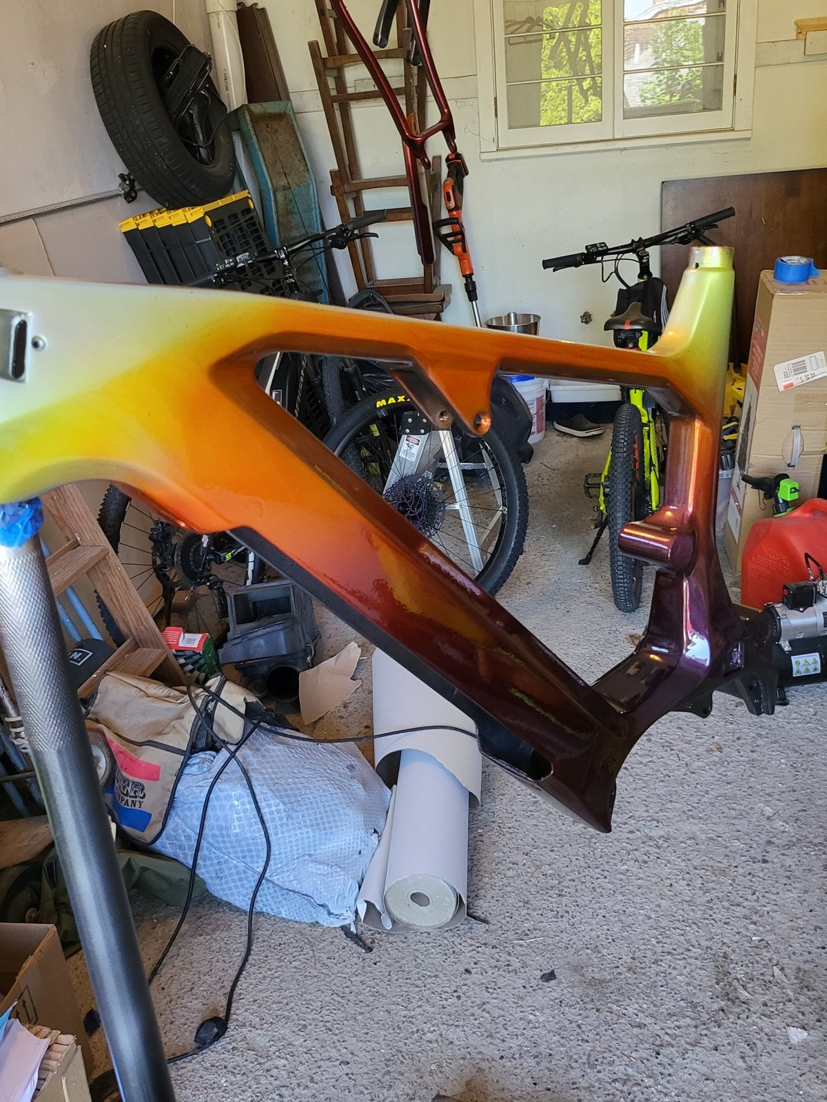

If you want a very nice glossy finish that is very Diy friendly just lightly scuff the frame with 800 grit or red scotch Brite. spray a good quality base black not nessesarily glossy you want a paint that give good color coverage and uniformity with the base coat. .then get a 2k clear coat and put at least 2 coats .. spray max makes a very good one in a rattle can. You'll be very happy with the results .
