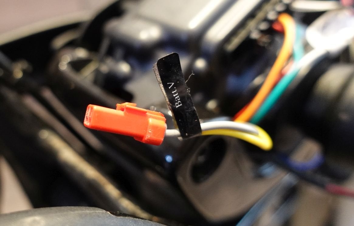

Hi all,
This bike has no connector for back-light. Is it normal?
Before I had another Giant trance bikes and every had a connector in motor compartment (12Volt).
How is it possible that this one doesnt have it?
this has only a connector with Battery voltage 37-42V. What is this used for?
Thank you for any advice.
Did that have a little white cover on it? There's definitely one off the end of the battery that is white or has a white cover on it... The red connector may be to power the Live Valve controller ie on the EL 1/0... Failing that there is a light connector up near the head tube under the Ride Control Go...
