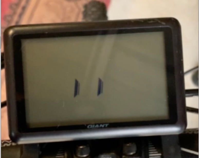

Hi everyone.
We just recently bought an ex-hire Giant Dirt-E and have been riding it. Love it of course. Yesterday I downloaded the App, connected to the bike via bluetooth, registered an account, checked out all the screens and all seemed well.
Then I changed the Bluetooth name...... Result - The display is on but a rotating set of two lines go round and round without stopping. Can't stop it, can't reset it. I don't have the keys to the battery either as the bike shop forgot to give them to us (trying to get them now). So right now the bike is BRICKED.
In answer to another post - The "new" release of the App has a single change (if you read the note) - stops people upgrading firmware. Well guess what, now there may be another reason to pull this shonky App from the online stores.
I need to contact a local Giant Authorised dealer and watch them scratch their head just like the previous Poster Segla did. I'm going to try and get it replaced regardless as this is unacceptable in every way.. I'll update the forum if people are interested.

To be clear, it's the display on the bike with the rotating lines, not the app?
G'day Dave
Thanks for requesting clarification - yes. The Charge RideControl screen. These two lines (in the attachment) cycle around and around the large screen numbers that are no longer there.

A follow up to this story. Apparently the cycling lines on the screen are what you see WHEN you do a firmware update via the dongle. My bike shop confirmed this. Also, they asked Giant about the model specificity for the App and the response was "there should be no issue with older bikes" . So now we have two competing versions of the story as I suspected. It's possible that by putting the dongle into the system to do a firmware update we could possibly trick the system into resetting normally. I just need to find a shop that can do that.

I have an update.... we got our key in the mail, removed the battery the bike reset itself back to normal. Dodged a bullet! Shame about the App, we were looking forward to the potential of it for future rides but wouldn't touch it with a barge pole now.
