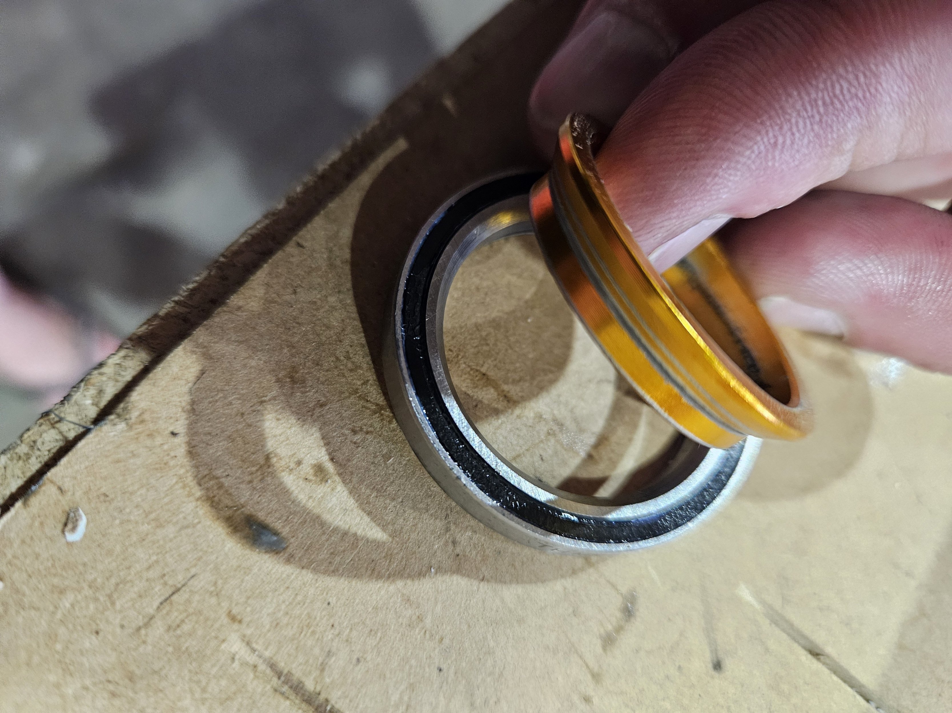

Had the same issue and appreciate the info above. Had a look at mine and I think the issue is the gold anodized part that is meant to clamp down onto the steerer tube.
You can see where its been fretting on my steerer tube and the inside of the gold ring.
I suspect some bearing retaining compound between the steerer tube and the ring might work for a while, I'll give it a try while waiting for the new headset to turn up.
View attachment 135525 View attachment 135526 View attachment 135527
For a second there, I thought someone had posted photos of my forks! Mine look exactly like that, with the same wear and I'm on my second Giant headset, (the first headset was also the same.) I agree, the gold spacer seems to be the main culprit. Be interested to know how people are getting on swapping to Hope or another decent brand.
I switched to Hope. I had more than 20 rides since then. Usually the noise turned itself on much earlier. So I confirm swap of the upper headset fixes the issue. And that's perfect because the number of options for the lower headset is extremely limited.
