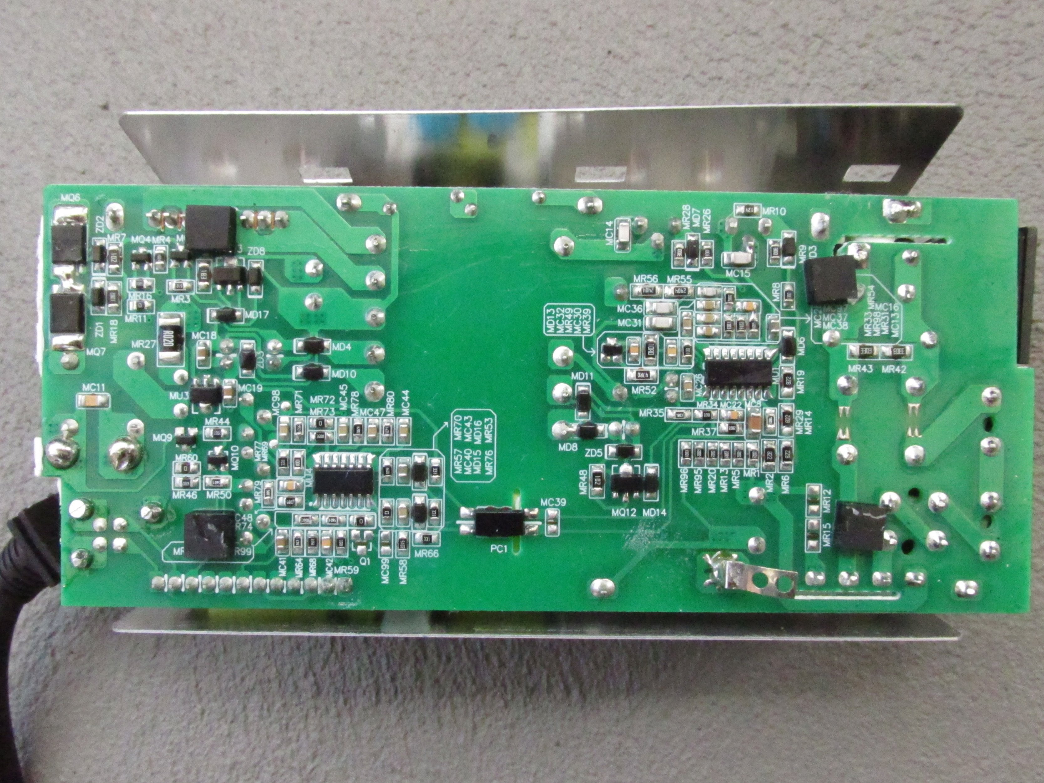

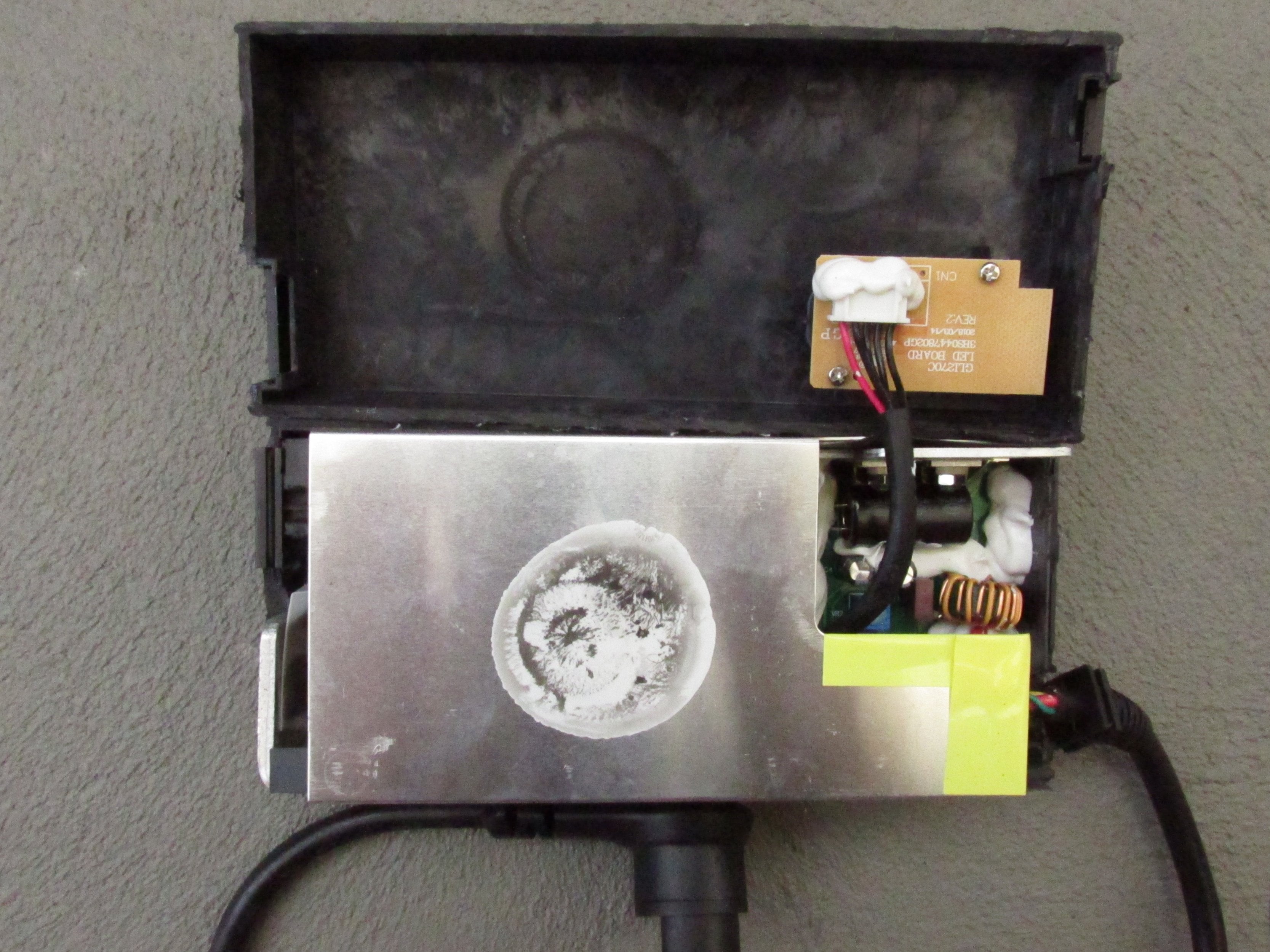

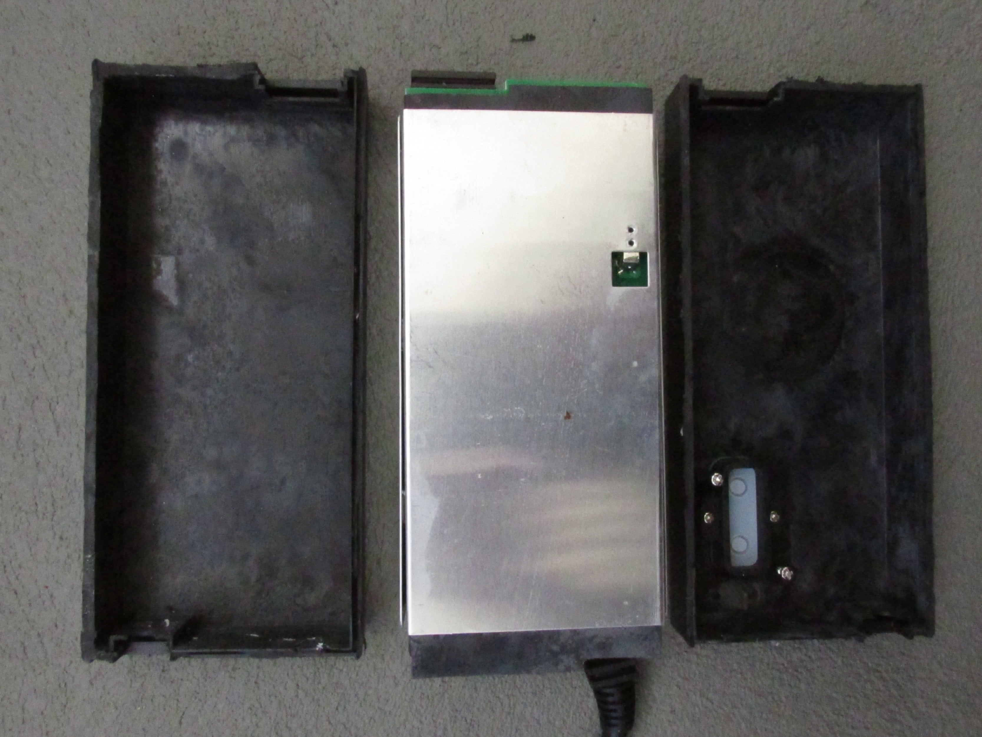

The case is plastic welded on all 4 sides, no clips to simply open. Use a hobby tool (Dremel) to split the case. Caution: Lots of fine black dust particles.

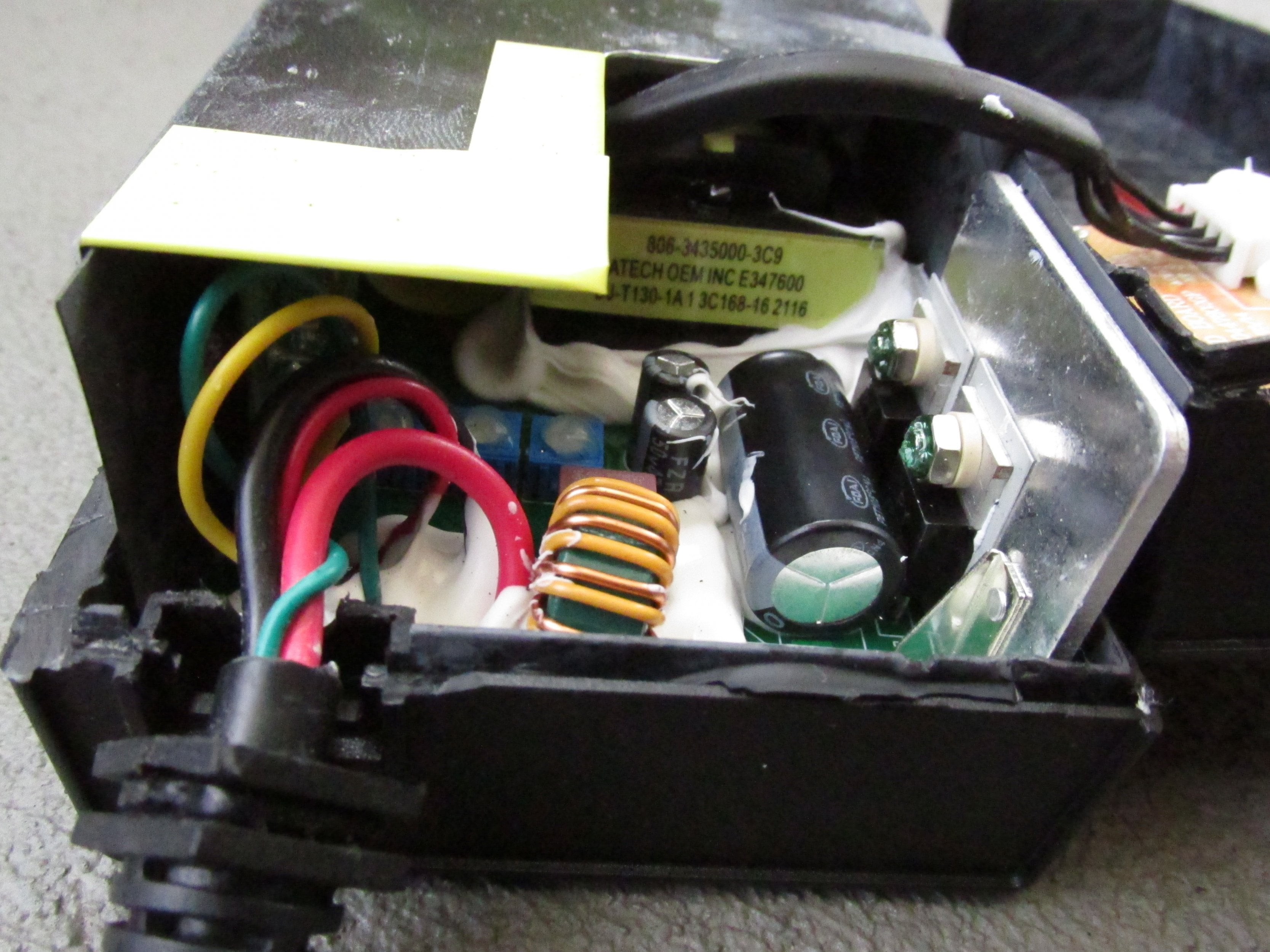

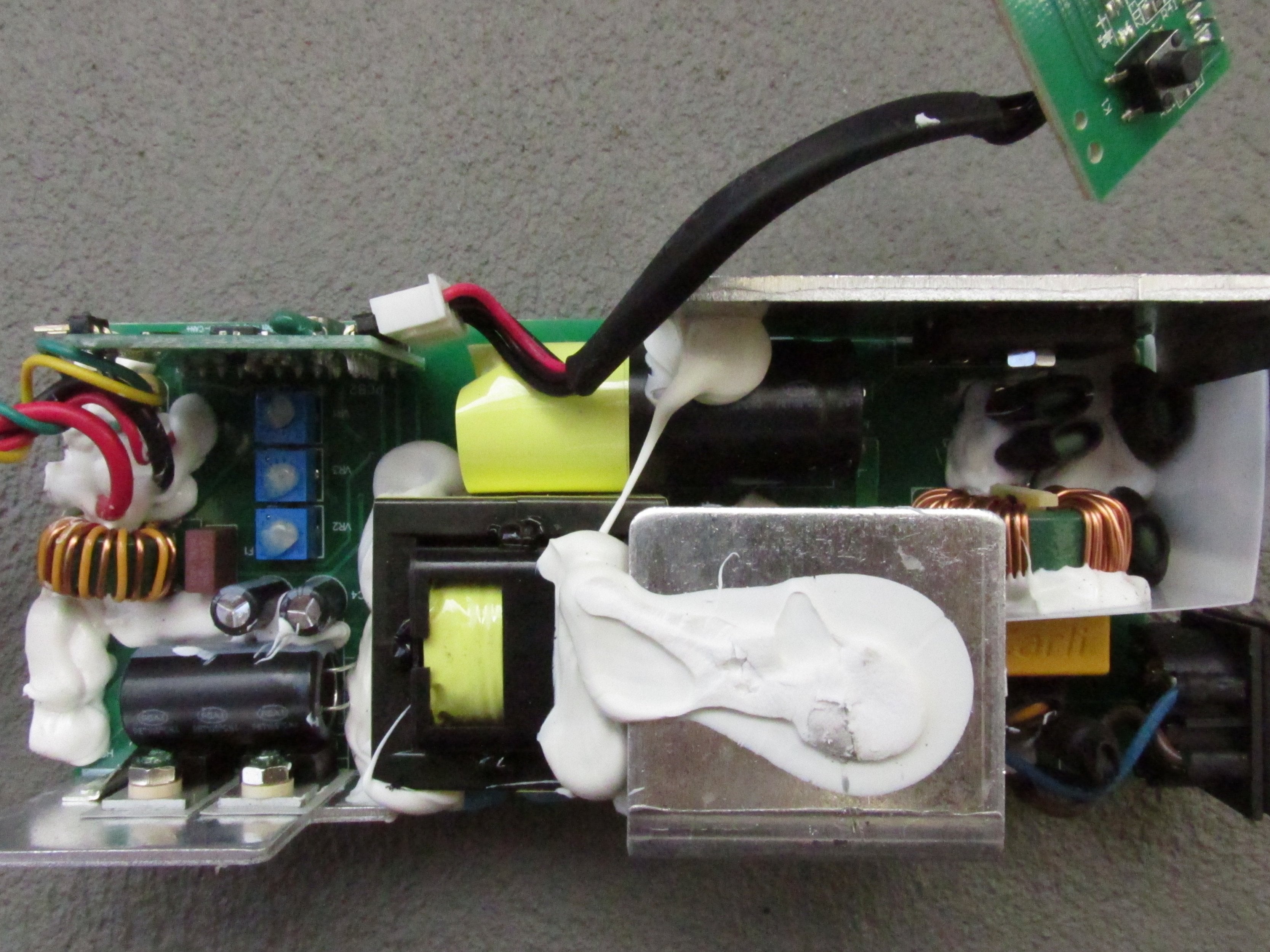

Internally, the circuit board is wrapped in aluminium sleeve which acts as heatsink. When you cut and the silver appears, you are through.
Input circuit has 5A fuse wrapped in heatshrink next to AC socket. If your LED's are dead, you might be lucky and just need to replace fuse. De-solder to replace.

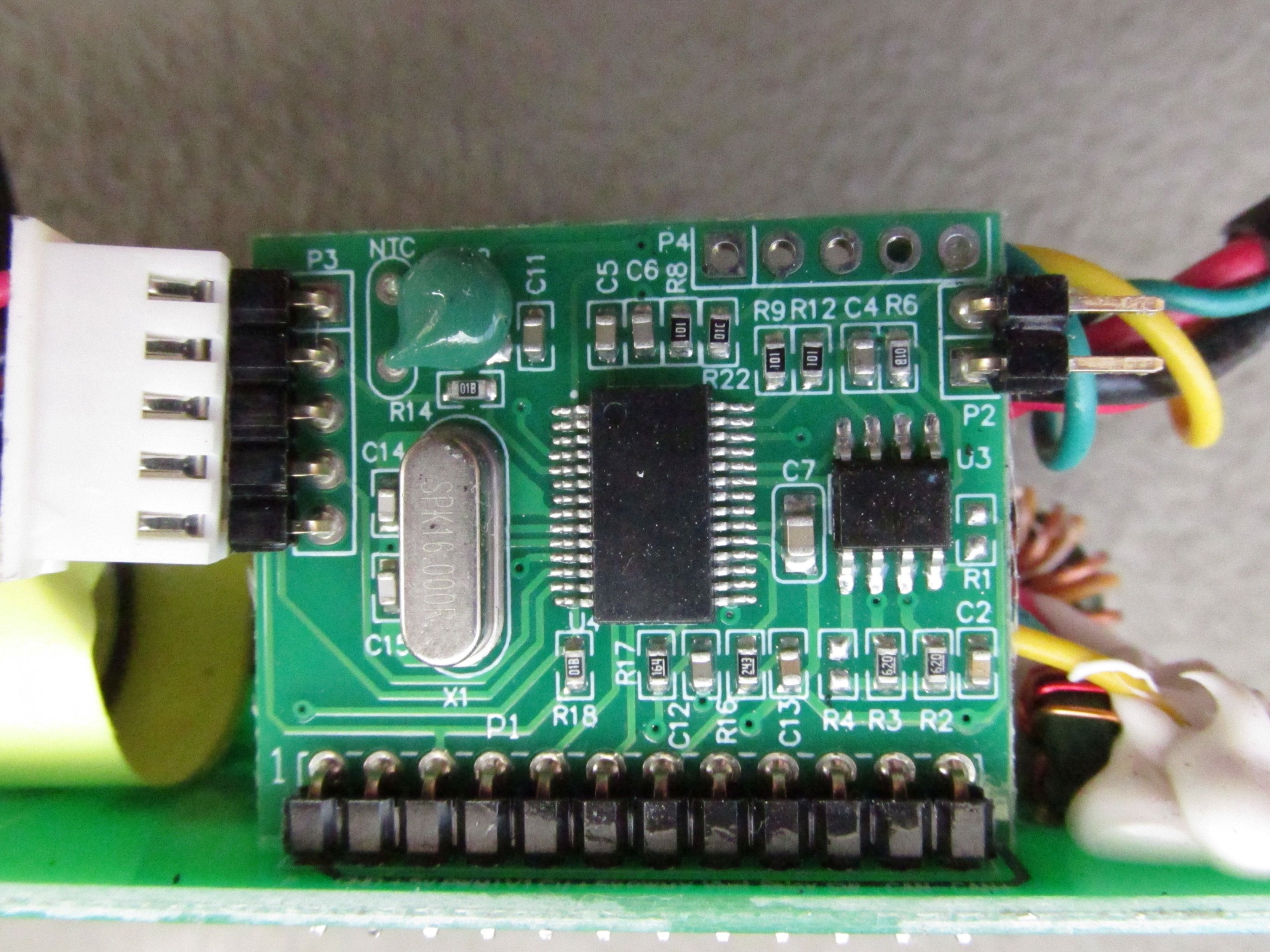

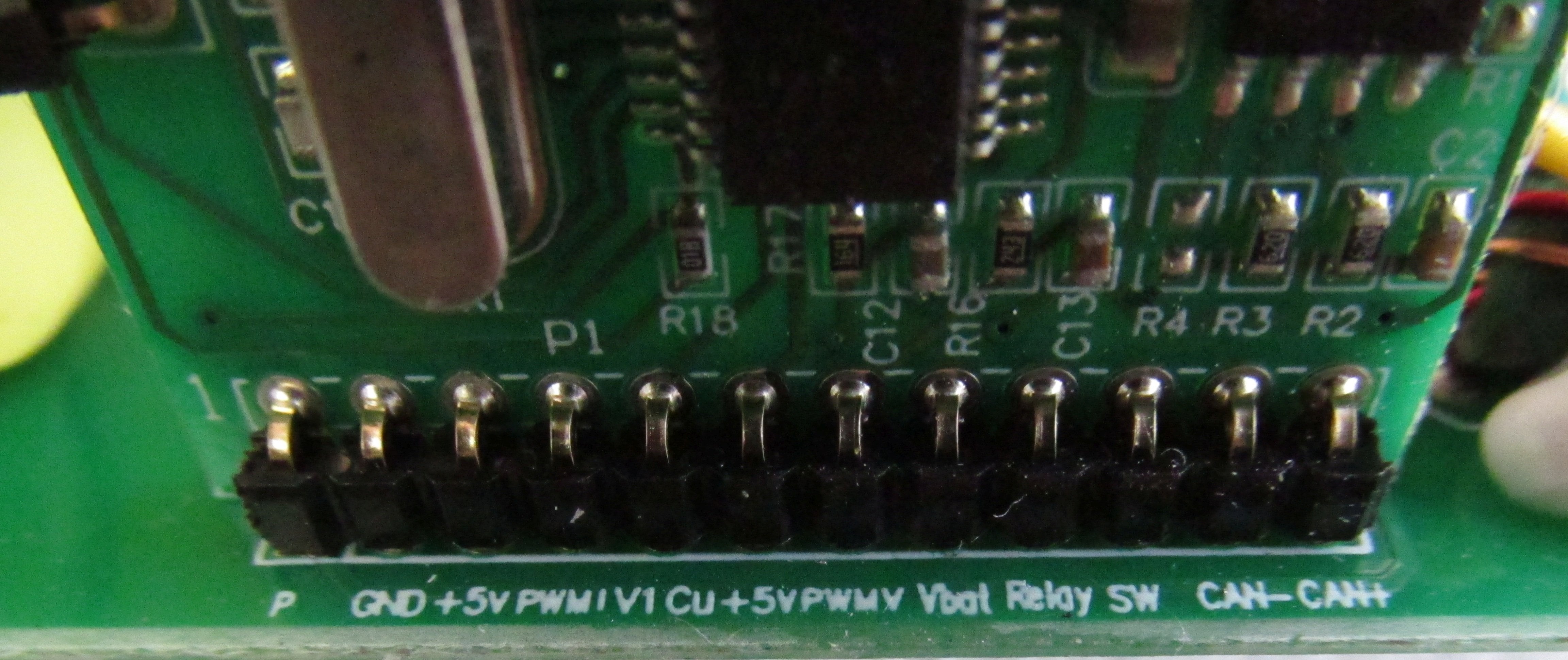

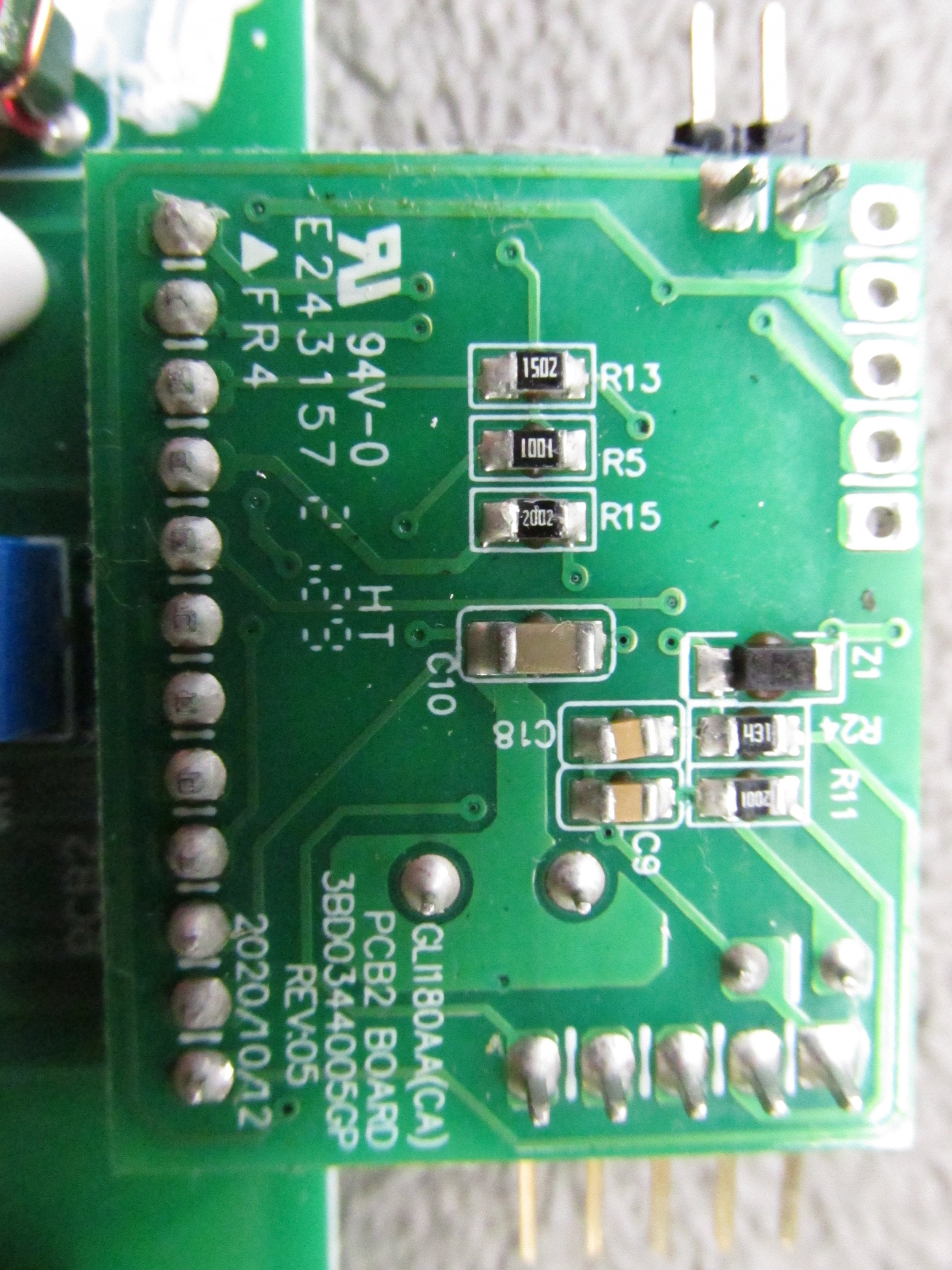

CANBUS daughter board mounted vertically off PCB. 5 pin connector to integrated LED and 60% charge switch. CANBUS communication is via Giant connector pin 2 (brown or yellow) pin 3 (red or pink) pin 4 (green).
If your original Giant charger dies, you can use a 42v (4A/6A) compatible and harvest the old 5 pin cable from the old charger and use thick RED and Black wires. You do not need the CANBUS signalling circuit to charge battery.

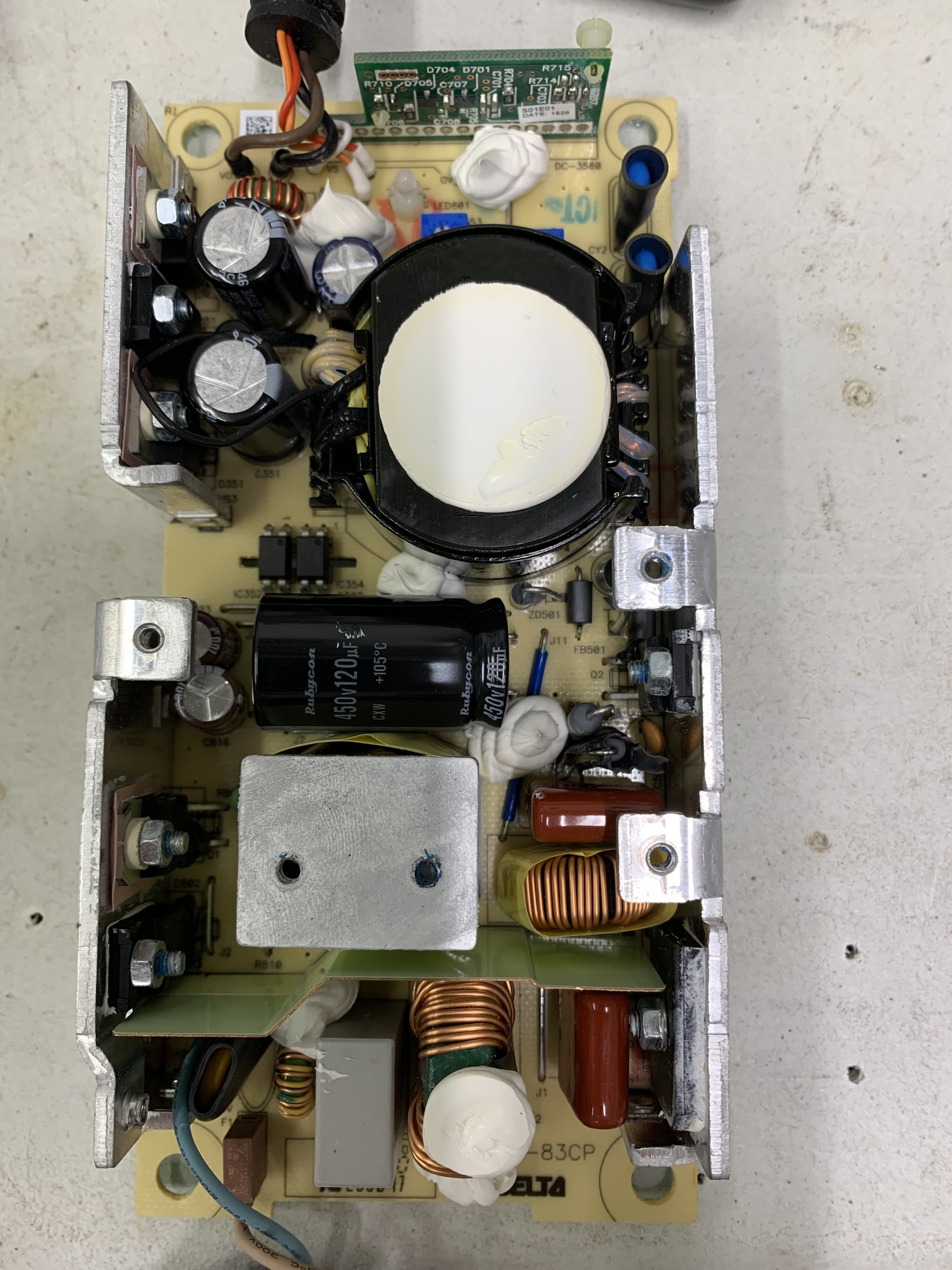

Great post on the charger … can you help:- I have a Giant DPS-83C A charger that has no output its spec is 41.8 v @ 2 amps .
Tested the continuity of the 5 wires of the Neutrik 5 way to PCB all good.
Voltages as follows photo 1 …
I cannot see any in line fuse on the PCB ?
Any thoughts. ?

Late to the party.... again. The fact you are only getting 34.5v on the secondary, not 41.8v could indicate component failure on the second stage output. Not familiar with the 5 pin XLR chargers, if in fact they are Canbus protocol. Is that mentioned on the daughter board anywhere ?
You don't need the Canbus communication to charge the battery, so any 41.8v unit will work.

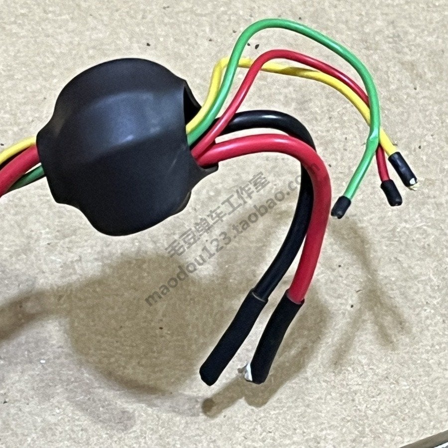

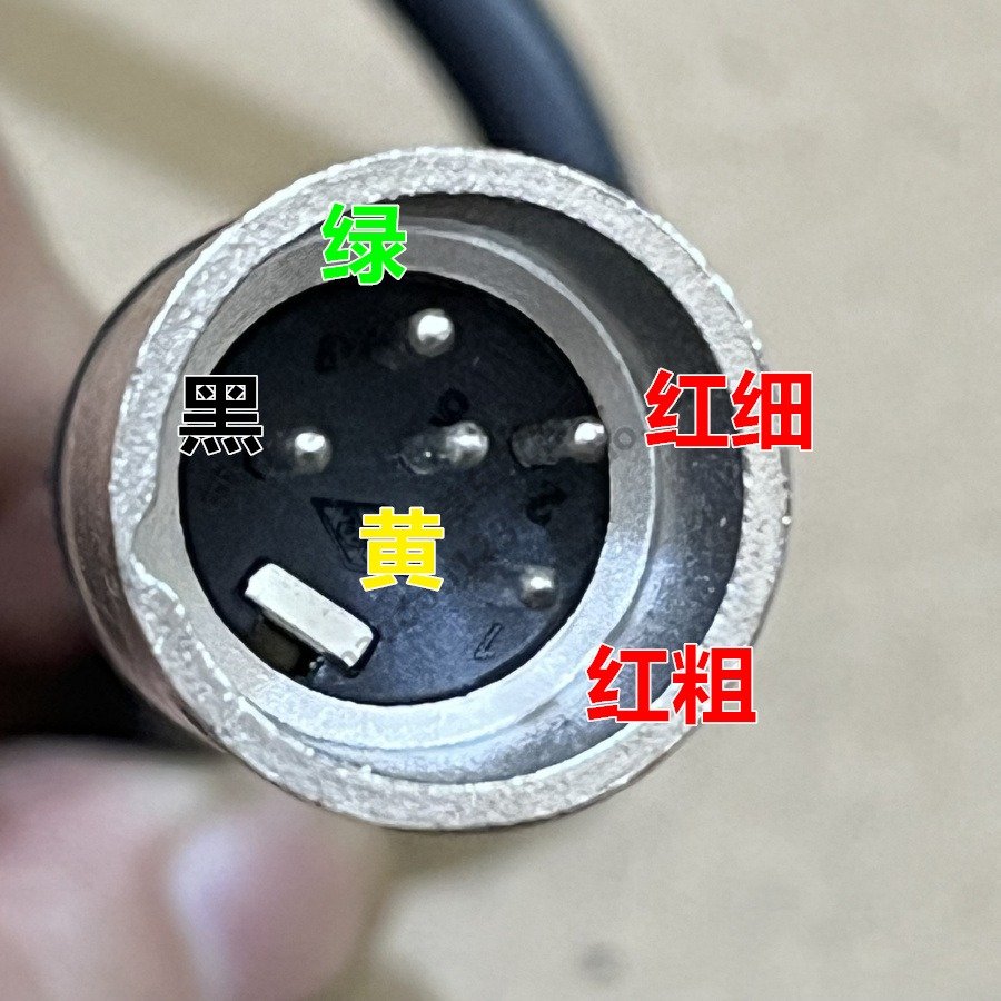

I Have A Giant GLI180A 41.8V - 4A Charger 5 pin charger
3 Wires have Come off The 5 pin charger connector, Mains Red And Black (Thick wires ) and Yellow (cambus I presume)
I found this image on Google but it's the 3 amps version
Can anyone confirm that red - black and Yellow are the correct way around?
The top 2 pins are still connected
Or Does anyone have Wiring Schematic ?
You can use the charger without the Canbus wires connected.

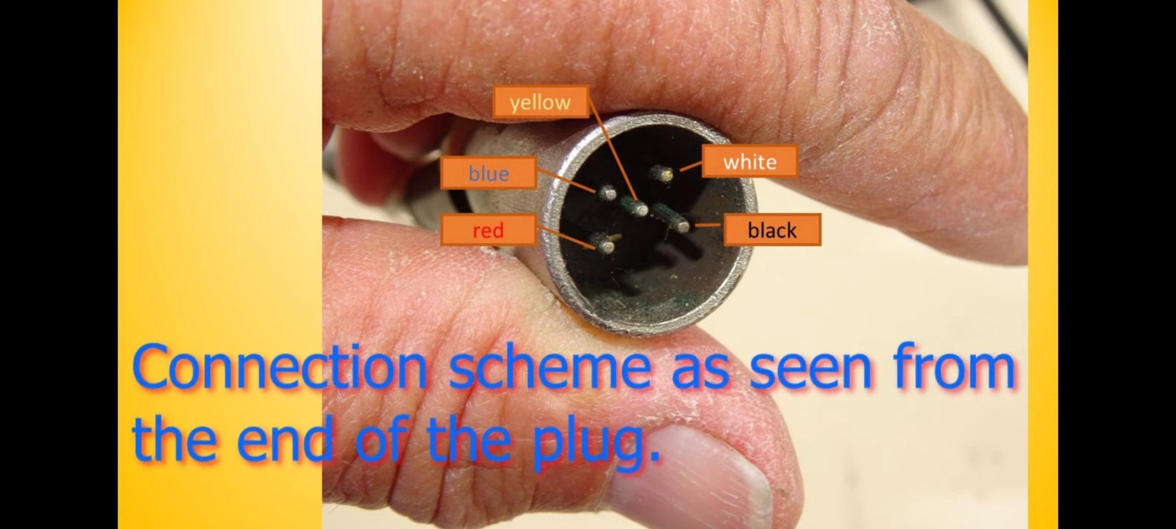

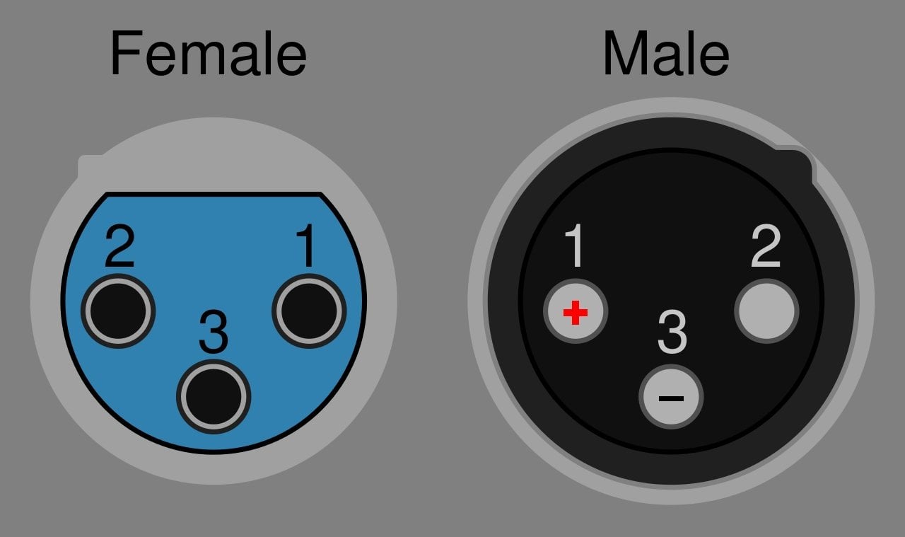

Stick a multi meter into the female battery socket to check positive and negative. Giant 3 pin XLR use 1+, 3-.
1. Red - thick (+)
2. Red - thin (Canbus)
3. Black - (-)
4. Green - Canbus
5. Yellow - Canbus

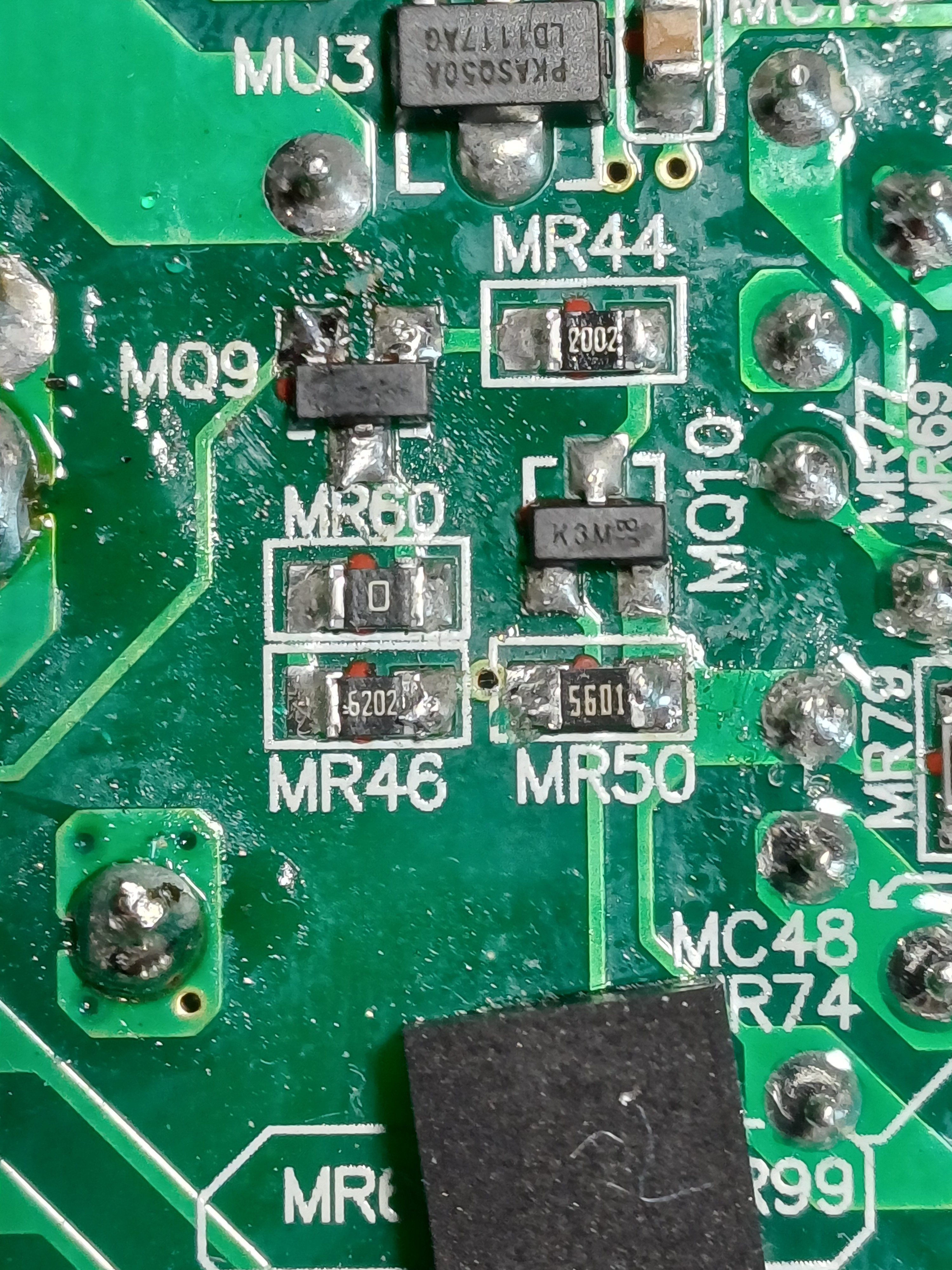

My brand new GLI180 charger behaved as follows at the third charging cycle:
Led A red for a few seconds, followed by green blinking for about 5 seconds, and after that 5 times red blinking, paused for a few seconds, 5 times red blinking and so forth.
And no charging at all(?). This can’t be anything else then a design error.
So I opened the device and found resistor MR50 (5k6 ohms) soldered at the back side of PCB1 at infinite value.
I just replaced it by another one, and the charger works like new again, CANBUS communication inclusive.
This resistor has imperial smd size 0805.
It could be undersized, and fail due to the generated heat by the other parts inside the device.
So it could be a good idea to replace it by a size 1206 (higher power rating), and the same resistance value.
There should be enough space on the PCB land pattern.
