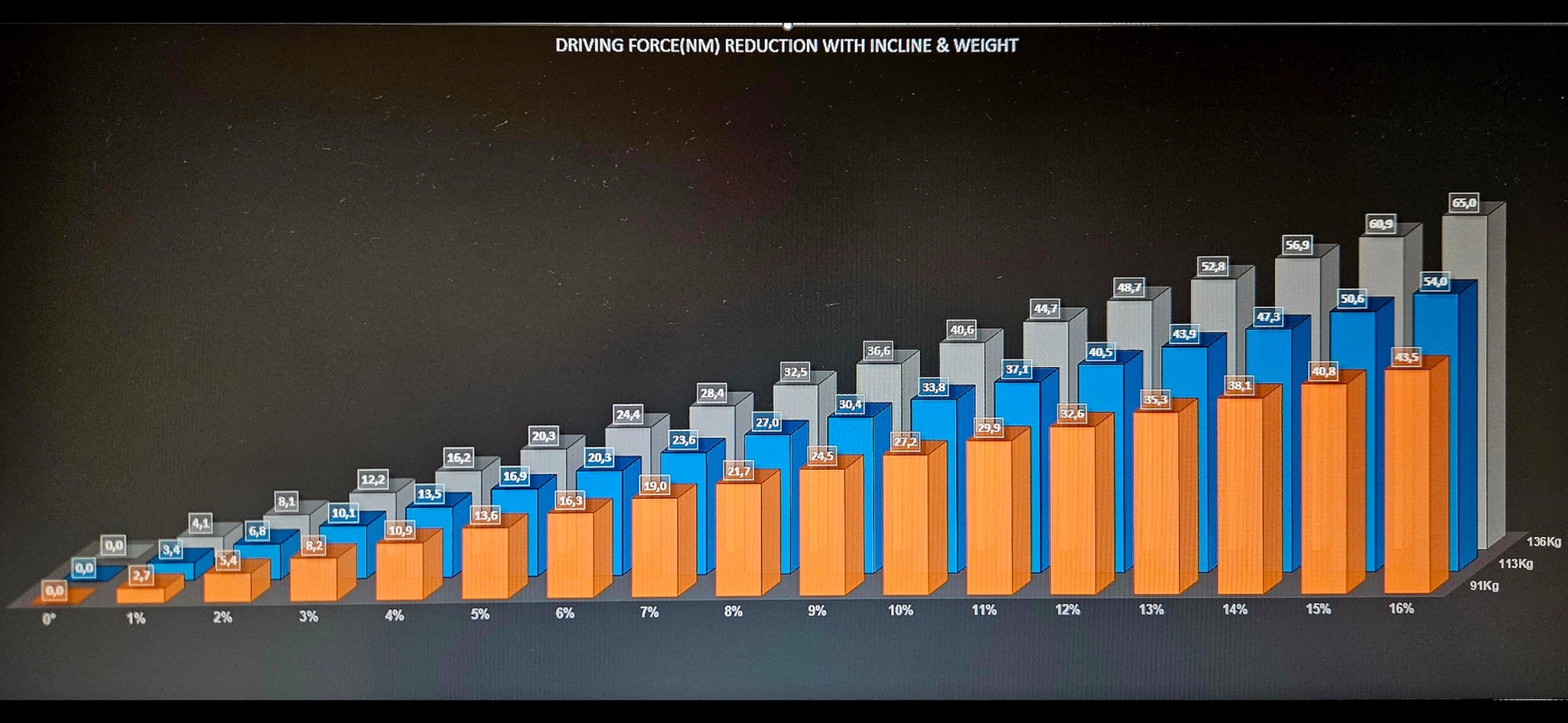

Maybe interesting for you or for someone...when I was bored I made chart based on various collected data that shows how much Driving Force(Nm) gets eaten from the getgo by combined mass(rider+bike) with increasing incline. Sorry about the bad quality...it's a screenshot unfortunately
These are all great discussions, but the fact remains that whether its power to weight ratio / Driving force reduction they are 2 separate motors. So I submit that Specialized just raise their power to 750w and call it a day. This topic of more power + more range is crazy... when power is near = across motors then people will focus back on how the bike handles. I have ridden both the Gen4 and now the Amflow, they don't ride the same. Weight is irrelevant to me at 40-50lbs.... they are all pigs compared to my 25lb MTB. Or have ppl stopped riding their old bikes:eek:

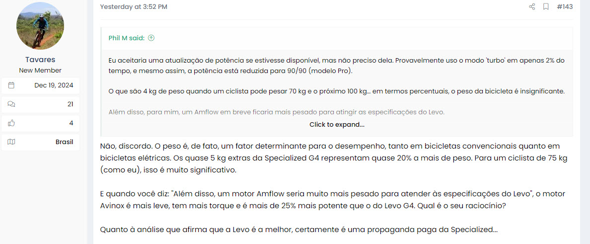

Não, discordo. O peso é, de fato, um fator determinante para o desempenho, tanto em bicicletas convencionais quanto em bicicletas elétricas. Os quase 5 kg extras da Specialized G4 representam quase 20% a mais de peso. Para um ciclista de 75 kg (como eu), isso é muito significativo.
E quando você diz: "Além disso, um motor Amflow seria muito mais pesado para atender às especificações do Levo", o motor Avinox é mais leve, tem mais torque e é mais de 25% mais potente que o do Levo G4. Qual é o seu raciocínio?
Quanto à análise que afirma que a Levo é a melhor, certamente é uma propaganda paga da Specialized...

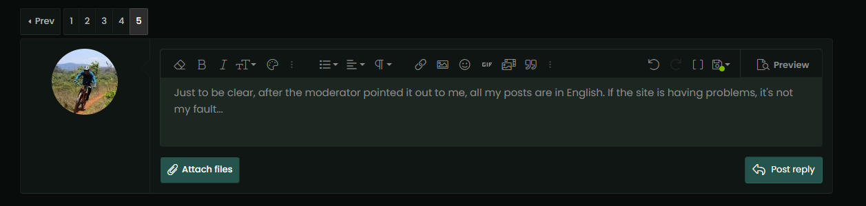

To be consistent with the language preference for the forum I have translated the post above...

No, I disagree. Weight is, in fact, a determining factor for performance, both on conventional bikes and electric bikes. The nearly 5 kg extra Specialized G4 accounts for almost 20% more weight. For a 75 kg cyclist (like me), this is very significant.
And when you say, "Also, an Amflow engine would be much heavier to meet the Levo specifications," the Avinox engine is lighter, has more torque and is more than 25% more powerful than that of the Levo G4. What is your reasoning?
As for the analysis that states that Levo is the best, it is certainly a paid advertisement from Specialized...
Just to be clear, after the moderator pointed it out to me, all my posts are in English. If the site is having problems, it's not my fault...
