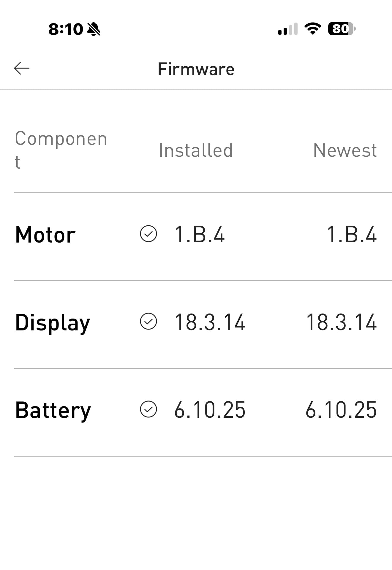

Ok guys I've taken the plunge! mainly because the update firmware became a banner in the home screen rather than just an instruction via email with details to check through.
It didn't take long and I did it at 100% battery but the display did worry me while it was running as it said do not unplug - I probably should have paid more attention at beginning as am sure it would have said to be plugged in lol!!

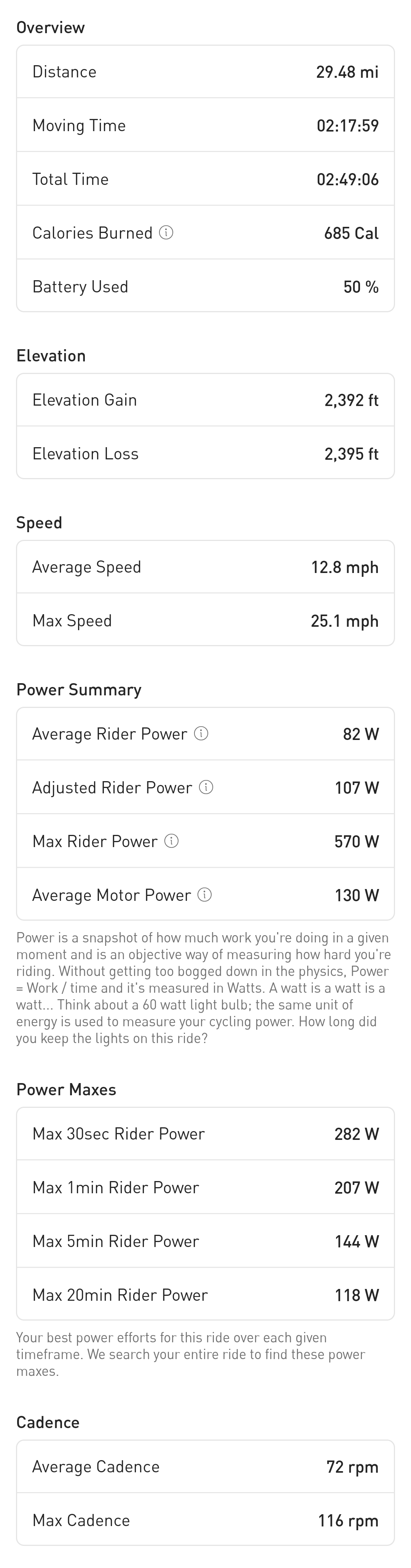

Hi, update as promised :)
The bike is vastly improved!!
The smoothness as you reach the limiter is night and day different, as noted last night on the quick test it no longer surges by clicking on and off, so it is much more enjoyable to ride, it feels natural to pedal at the speed limit now and over by increasing your own power without hitting that dead wall stop feeling, if this is the only change we get this time then I'll be a happy man.
While I used eco for 99% of the ride, the menu re-order is better as it makes logical sense.
In terms of battery use, I think it's more efficient now, likely because of the reduction of power at the top end - this is backed up by us returning home with me at 50% remaining and my wife at 41% - even accounting for the 1 or 2% difference we normally have over further distance, there is an improvement there.
I'm still not sure if I can notice the difference in NM when in turbo mode, it's not like this bike struggled at any rate but I probably need to go to a few steep hills to test them both, with some willful thinking it does feel a bit more spritely although I would be hard pushed to quantify it
What do you think of the battery consumption. Have you made any comparisons? Cheers!
Yep!
Details in the post above the video - mine used 9% less than the pre-upgraded bike, on a 30 mile ride.
For comparison, we did a 35 mile ride 2 days previous and we were between 1-2% different, which mirrors all other rides we do.
I always put it down to me pedalling just a few rpm faster than my Mrs on average over the ride, so I must shift earlier, we are within a few lbs of each other too at just under 11 stone each - so things are quite equally matched.

@Eduardinior I have!
Today we completed another 30mile ride, 4700 elevation this time and the extra nm is very noticeable when compared to my mrs without the update (just maybe not to self, like looking in the mirror daily and thinking your hair hasn't grown!)
Anyway eco me is equal to auto- her, which is now broadly 100w motor power I believe, but even still I have come home with more than 10% power difference again - this is certainly because being over the limiter is so much more natural and you go over speed via 'human power' without noticing as the start stop & dead wall has gone, so you're essentially riding without the battery in use etc.
In terms of power eco at 25/25 is more powerful than before, and equal to whatever auto- gives you pre update, I know this because we rode equally before with speed and battery mostly matched (+/- 1 or 2%) - but now I get to speed quicker and she commented today she feels less fit than before even tho it's not true, just a virtue of the bike power difference
I don't think there will much more to add now, I'm thoroughly impressed with the update, mainly for ride quality at the speed limit but I've fed back to specialized via both the survey and the email address on the update email to say all of the same things I have said here :)
