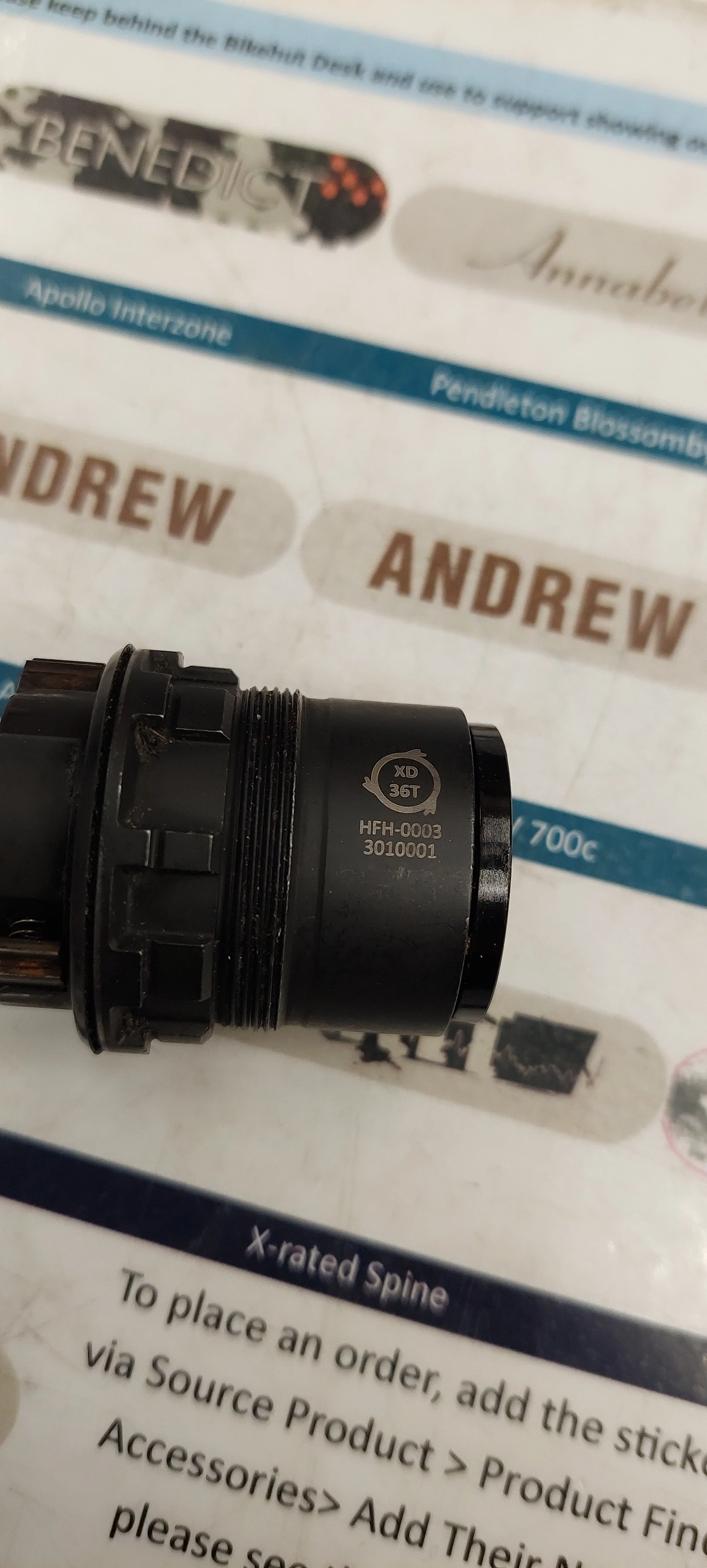

Looking for a tool to remove th cap from XD DRIVE HFH00033010001

Been in to 3 shops and asked sram and Specialized concept store noone can recommend any tool .It is screwed on not a cap. 12 faces so not alan key

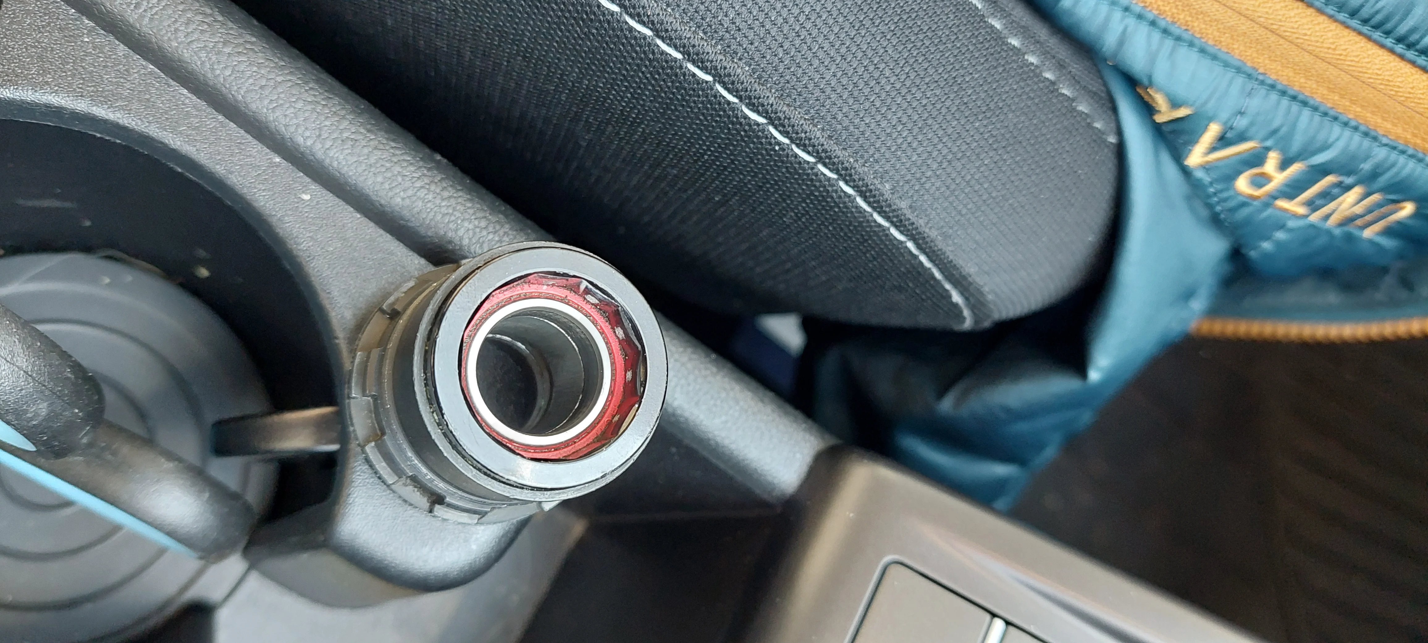

No flats . I have posted pictures

You can see inside with pictures I put on. I can't be the only one who has had this issue. If 3 shops can't help I wouldn't be buying a tool that might work

On the actual removal: on the Formula-based Roval, to get the freehub off you need to remove the nut on the end of the axle, and it's a reverse thread nut so clockwise to remove. Hold the locknut on the non-drive side to prevent the axle turning.
The left-hand side of the axle should have an allen key fitting inside it so you can unscrew the drive side nut.
That's your 12-face fitting right there. It's not a cap in the conventional sense; it's the axle preload nut, and it takes a large hex key inserted through the non-drive end. Reports suggest 12mm or 14mm, but you'd need to test fit to confirm which engages cleanly.

Your losing me. The freehub is off one side has pawls other side has the piece I want to remove.
