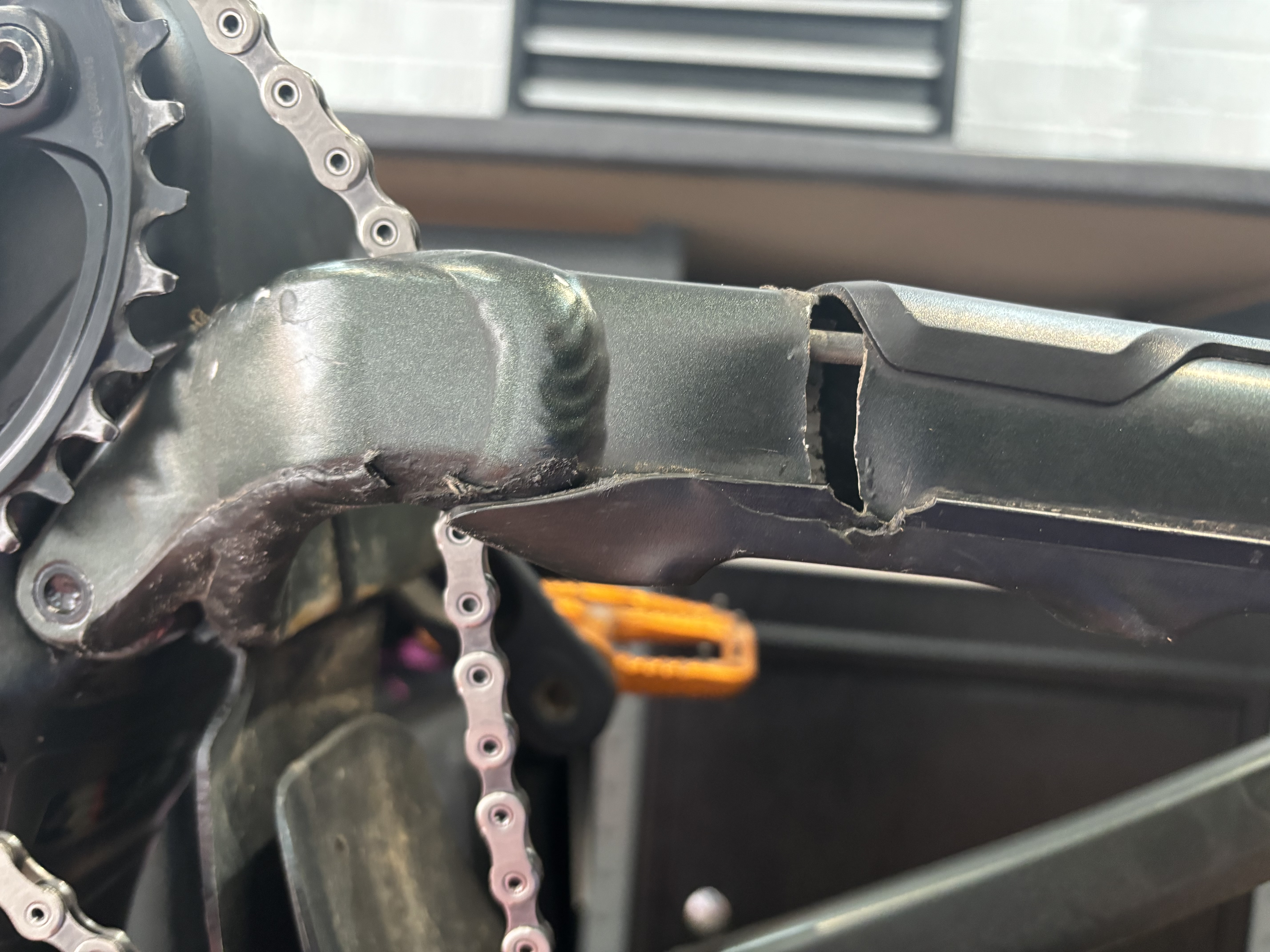

In fairness, they’re not a bad job……..
The seat stay takes a bit of frustration with equal relieve once done
Whilst I’d say none were particularly bad, I now have piece of mind they’re done
Onto the real cause of my creaking and waiting for a replacement chain stay for the rebuild

crikey you were riding around with that like that?! It wasn't done by the slide hammer was it? It always feels like something is going to break the couple of times I've done it!
Snrbrtsn
Apr 7, 2021
215
167
Uk - Scotland
Once the chain protector was removed, it’s even more impressive, clean cut that one would struggle to do blindfolded with a saw
No dings, little by way of paint damage,
Fortunately, bikes back together awaiting its maiden voyage with a second hand chainstay whilst the frame warranty outcome is settled
Shall take it through the tarmac for a shake down tonight
