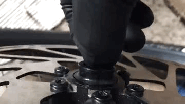

Possible noob question....please have a look at this video below. Is this as designed? It makes a clicking noise when I move it about too, has approx 2-3mm play. When you slip the spacers back on it limits the movement slightly but still enough to wobble it and make the clicking noise.
I hear the clicking every now and again whilst out and about, usually when compressing the forks. Anything to be concerned about/needing a fix or am I ok to crack on?
When the wheels on and tightened up It rides ok, no wheel wobble, just that noise sometimes?
Any help appreciated ?
Thanks

Hi @congerball - those are floating end-caps and designed to have play in them. Once the axle is through and tight they are highly unlikely to be the source of noise. Far more likely is that it's coming from your fork.
Ok, I wasn’t sure so I wanted to check. Thanks for taking the time to reply.

Turns out it was the fork, better late than never though ?
Specialized sent my Sektors to SRAM, they sent me a pair of Pikes back ????
What a difference. Also no clicking or oil leaking anymore ?
