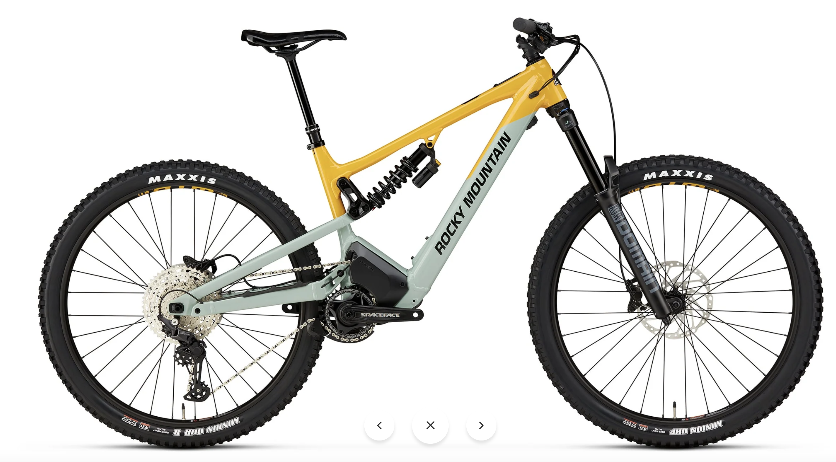

Not sure about the idler design which only allows about a third of the chainring teeth to be wrapped. I predict that it will be hard on chainrings. But just order a pile of cheap ones on AliEx I guess or buy stainless steel. But on second thought Rocky is getting away with it on their e bikes that have plenty of nm so I might be ok!

Don't get me wrong, i like fresh ideas, BUT as above some of the angles seem a bit off and I thought the point of a high pivot and idler set up was for pedal kick back over the gnar? You wont get that on an Eeb, so why have it?
Its like someone saw the Grim Doughnut idea and thought, that's a good idea and threw an Eeb version together but forgot to update the numbers?
But Rocky Mountain use a good old chainguide, not sure if is possible to use on this frame.

As far as RM goes their design has different stresses on the idler/drive cog which in their design actually puts less strain on the chainring as most of the power is on the upper cog. But they still use a tensioner behind the chainring to gain more wrap and I'm sure they do it for a good reason.
