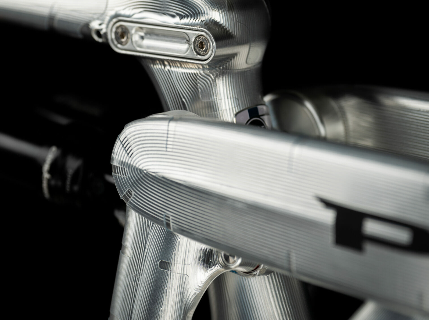

Anyone got a Raw and weren't sure about the frame protection film, decided to go for it, then when it arrived, decided it was really visible and not a good look.?? Or is it just pics that make it look so obvious??
I'm really torn on this one. I've always had Invisiframe on forks and frame and it's worked a treat when you hit the deck and kept the bike/forks scuff clear. Which is a result for keeping good second hand value in your bike. But if it looks like the pic and is that obvious, I'm a bit reluctant.

Film not very visible on my storm-grey frame and it’s very thick and protective. It’s more visible due to subsurface scattering on the photo and overall visibility depends on lighting conditions. It looks absolutely normal in person, not a hack job at all.
But If I to buy another voima or sonny I’d skip and go raw.
I do have raw uncoated pole machine since 2018 and crashed multiple times. It holds up just fine. 2018 pole is completely raw aluminum though. Raw voima is still covered by invisible coating afaik and doesn’t oxidize as easily as true raw.

Thanks a lot. So your first paragraph had me thinking, this sounds good, it's mostly the photo's that are exaggerating it on the Raw and it doesn't look like a "hack job".
Then your second paragraph says you'd skip it if you ordered again. So, why would that be if it doesn't look bad and It's thick and protective?? (it looks as thick as Helitape in the pics)
Storm grey/gold is easier to scratch, so film is a must have.
On raw scratches are less visible and easy to buff out and polish away.
I’d go filmless second time because I’d go raw color, not because I dislike the film.
Film actually does a great job and doesn’t ruin the looks really.
