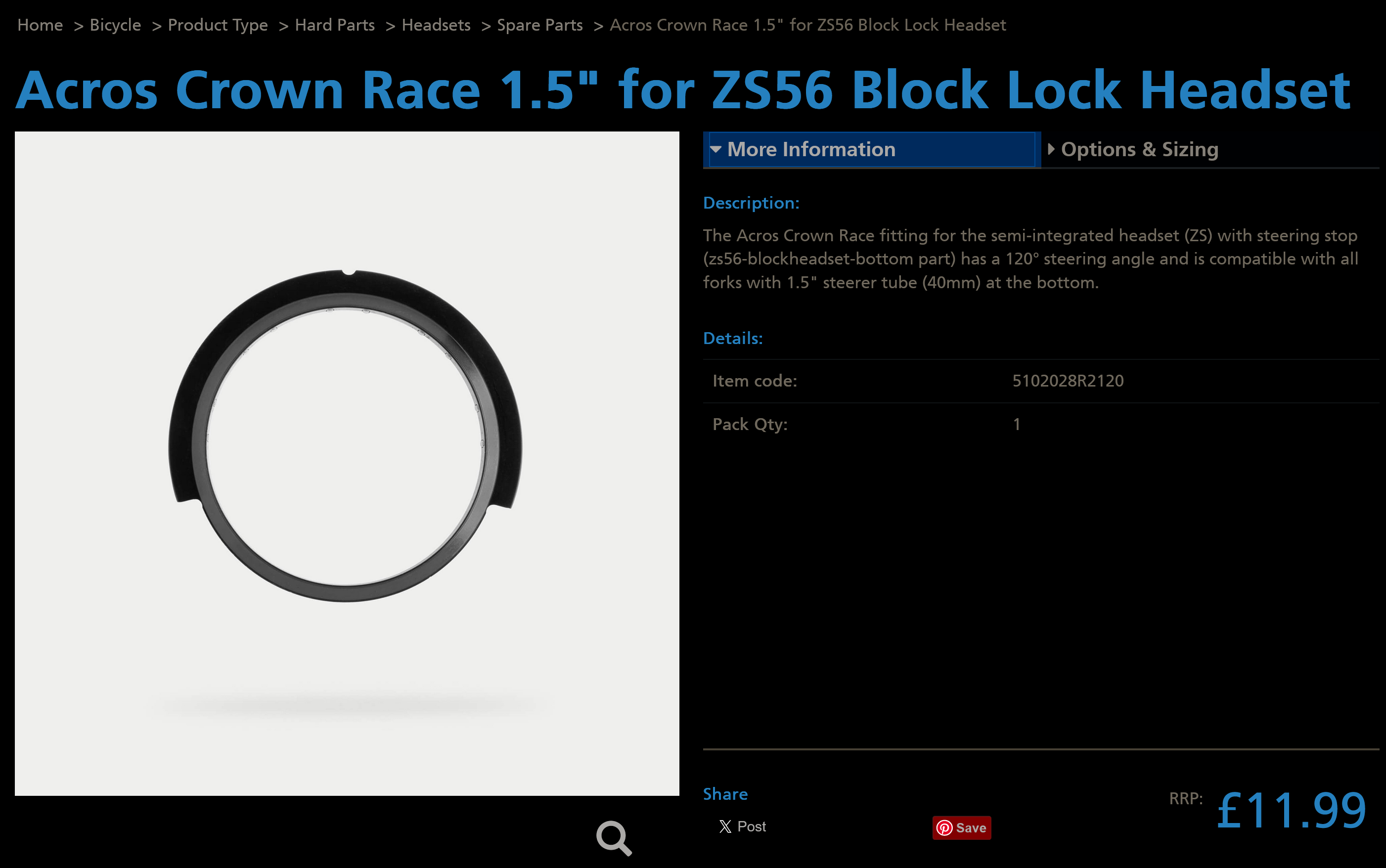

Just got new crafty carbon rr and YEP. Internal Cable Routed headset with blockknock lower crown race setup. Plan swop out the new fox38 for rxf38 Ive still got sat here so removed fox38 only to find this new starnge WTH is this BK Crown race that I can't get off with usual screwdriver hack/trick so after 2 days of seraching I found the part I need so for now Im just gonna buy it and sortout removing other one off the fox38 later on. I found it on Acors website so googled and Oxford website have the same part listed for sale.
Screenshot 2024-01-26 at 19-59-05 Acros Crown Race 1.5 for ZS56 Block Lock Headset Oxford Prod...png
I got mine on ebay, and theres only a single seller so not much choice. Price is more-£22.50 inc post, and to be honest with no other choice its better just to buy than wait an unknown amount of time to try to save a tenner when fitting it on a £5/6k bike
