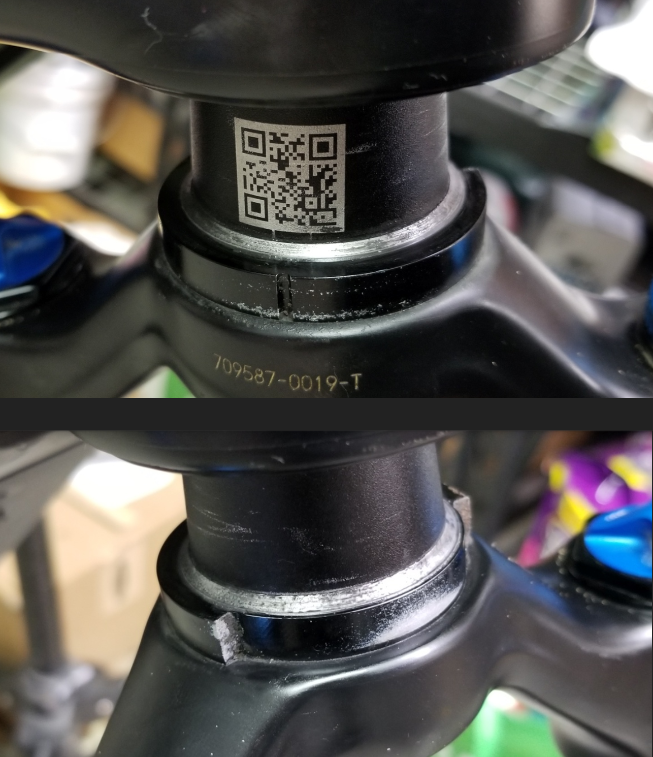

I'm contemplating a fork upgrade and was looking at the Acros headset that came on my Decoy. I am unsure how to remove this as there's no where to insert a screw driver tip and no lip at all to hit as there would be on a standard fork race. Not even a very small screw driver tip will fit between race and fork crown.
Does anyone know how this is removed? Special tool or method?
Headset is Acros AZX-260 on a CF Pro model 2019/FOX 36 FLOAT PERFORMANCE ELITE E
I also have searched extensively online and can't find a user manual or any info on this type of headset in as much as removal.

I don't know what the "official" technique is, but I sometimes use a wood chisel to CAREFULLY get a little bit of gap under the crown race so that I can remove it. Be CAREFUL because the chisel is sharp and the edge may break if you're not CAREFUL. Take your time and move it a little bit at a time. Good luck. And BE CAREFUL. ;-)

I'm changing that piece to the new fork. With a flat screwdriver, I inserted it in that place that is between the base of the fork and the respective part. with a plastic hammer tap the screwdriver lightly. .... lightly knock around. Attention, the piece has some small pieces of metal inside that play the role of locking the piece on the neck of the fork.

I just noticed this today on my decoy.. turning bars left they hit the block sooner than turning right.. can the race move in a crash? wonder if it happened last crash I had.. wonder easiest way to recenter it? Any ideas?
Crash on the other side.
Or pull the fork off, and use a hammer and punch to orient it straight again.

so looked at it with fork off and tried a punch but thought better of it before I went to ham fisted!! I called yt and the said just use the bars to reset it. So once I re mounted the fork I just slammed ( not too hard) the bars until it was centered again.. really easy actually.
So don’t bother with punch, just knock the bars a few times and you are good to go.

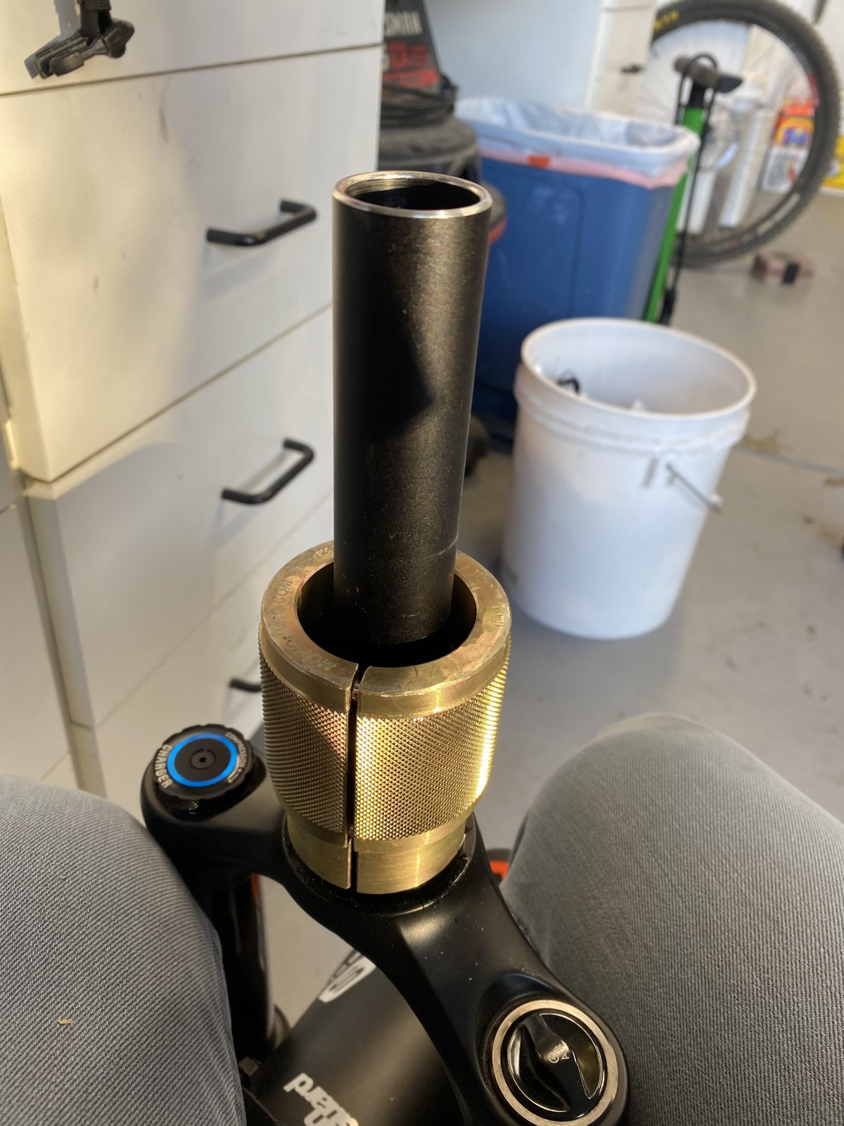

Here is how I did it without any of the proper tools.
first I used a screwdriver to get slight movement out of the crown race. Then I used the park tool brake pad spreader and a hammer and slowly worked my way around until it was able to pull free. I then removed most of the needle bearings minus 3 of them. (I tried with none but it was too loose. Didn’t want all of the just for easy of install). Last I used a motion pro fork seal driver for motos to pound on the race. Just a little at a time with a hammer. And bingo, no bike shop or proper tools necessary.
