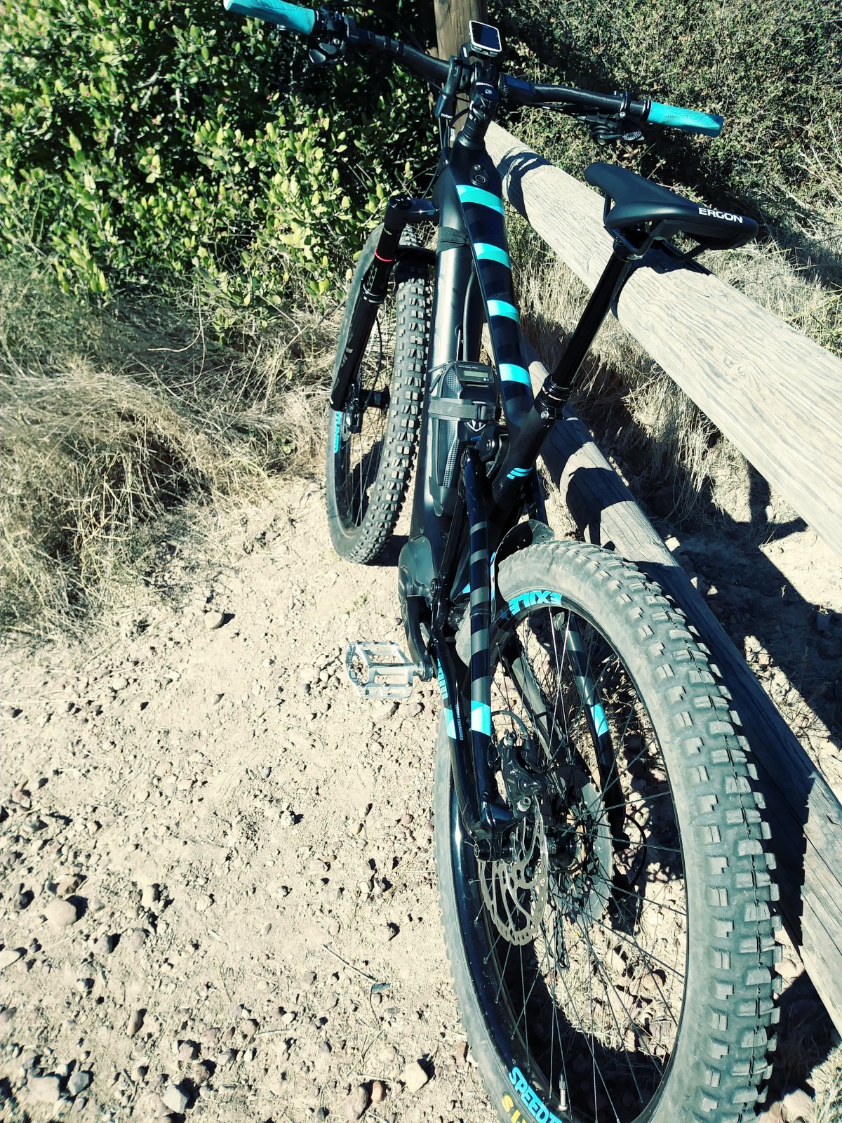

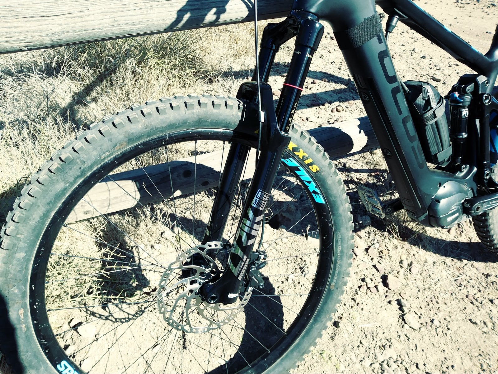

Just installed my 2021 lyrik ultimate 150mm 51mm offset. I’m glad I didn’t go with the 160mm. It sits taller and my 2018 jam2 C measures 65.1 deg now, just right for me. I ride it on the trails tomorrow morning for the first time. I could not get more than 20% sag at 55 psi though. One volume token, came with 2. Going to start with 60 psi. I’m about 156lbs with full gear. I have access to a shockwiz for finer tuning later. Oh only about 50g more than fox 34 rhythm.

I was concerned that I would not really notice much improvement with my new Lyrik but that is not the case. It's much more controlled and smooth over harsh surfaces. I used all but the last 25mm of travel on this ride and while I had a couple of harder hits trying to bottom it out they were not that severe so I'll still be doing some tuning I think. The harshness of the Fox 34 has been very muted and smoothed out and I'm very happy with the result. Can't fault rigidity of the new forks even without the torque caps that I'm still trying to get. It's just very solid and with the new upgrades for 2021 it sits higher, so much so that I'm going to lower the bars at least 10-20mm. Mid-range support was very good along with better small bump sensitivity. There's just a more damped feeling from all the harshness I was feeling in the Fox 34.
