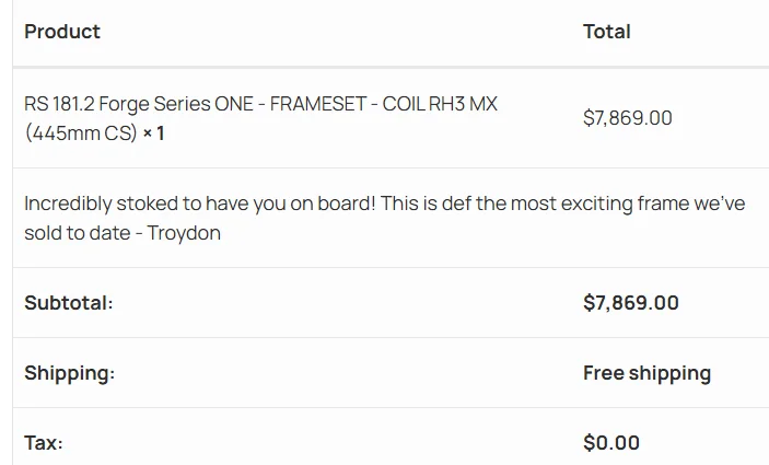

Well, I drank the Kool-Aid and snuck into the Forged carbon frames they dropped this morning, that color was too sexy to pass up. Will be selling my Forbidden Druid Core come June.

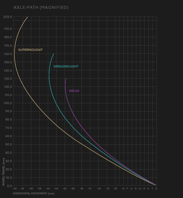

More travel is more travel. You cannot change the physics. Rate of deceleration is reduced with more travel. You can slow the energy being absorbed when hitting bumps over a greater distance, and thus time.
Late to the party here on the travel debate. Outside of the real world experience of having owned a Druid V1, a Dread V1 and a Crestline (run at many configurations), there is some flawed, living in a vacuum logic with "more travel is more travel." you simply cannot reduce a bike's behavior to that one variable.
First fly in the ointment: rear center length. If I am on a unicycle with a rear center of 0mm and I run over a 50mm square edge, then the hub/spindle immediately move 50mm in the vertical vector, transferring 100% of that energy through the hub/spindle. Conversely, if I have a front center of 0mm (think penny farthing), when the rear wheel strikes that same square edge, the spindle will move 0mm. To split the difference, if I have an equal front and rear center, say 200mm each, then the spindle will move only 25mm in the vertical direction and take half the time to get there. the longer the rear center the greater the time before that is experienced. the longer the wheelbase, the more it flattens rough terrain, regardless of suspension travel numbers.
Second (and most important) fly in the ointment: the conjecture over travel is generally centered around a bike with a neutral position; ie. on horizontal ground. now tilt the bike profile to a 45* slope, and axle path impact gets magnified. what was once a vertical axle path is now a completely forward axle path. relative to gravity, the rear wheel hangs up even more, decelerating the bike, and pitching the rider forward, especially when rebounding. combine that with the fact that steeper terrain positions the bottom bracket above the front axle and the sensation of OTB comes on much quicker.
Take a look at what RAAW, Frameworks, and Forbidden (and to a lesser degree Crestline) are doing with their geo:
Low BB to get the spindle low/behind the front axle
Shorter reach combined with higher stack to get the rider's weight behind the front wheel, not over it (effective reach grows on steep terrain, pulling the rider's hips in front of the spindle)
Longer CS to reduce the impact at the spindle and still shift weight/force to the front wheel
All of that is useless on horizontal ground. Start to point it down a janky steep, and all of that corrects the rider's position relative to the front axle.

I'll concede that the vacuum you are living does support your argument. That vacuum is
1) a completely horizontal landing (possible but poor trail design and different than you illustrated in your photo)
2) a rider with zero horizontal velocity (impossible unless bunny hopping sideways off of your drop)
3) both wheels striking the ground at exactly the same time (possible but not probable, and a skilled rider will set the rear wheel down first when they sense they are coming up short)
4) the axle path is linear and vertical in nature (you'd need set of levers that replicates an infinite instant center to achieve this)
take a peak at the manufacturers axle paths and note where the inflection point is. note that at sag, one is still moving rearward while one is moving forward. note that the behavior is magnified and the inflection happens earlier when both bikes start to deviate from perfectly horizontal. note that both of the curves are longer than the vertical travel. note that rear wheel travel changes relative to gravity the moment the bikes start to deviate from perfectly horizontal (the higher pivot actually catches up to the lower pivot in terms of vertical travel).
it would have been very easy for Forbidden to square up their rear travel to match their front travel in an effort to not have to resort to the marketing speak that you point out. why would that elect to open themselves up to ridicule? because its a system and the whole is greater than the sum of its parts.
are either approach perfect? absolutely not. everything is a compromise.
