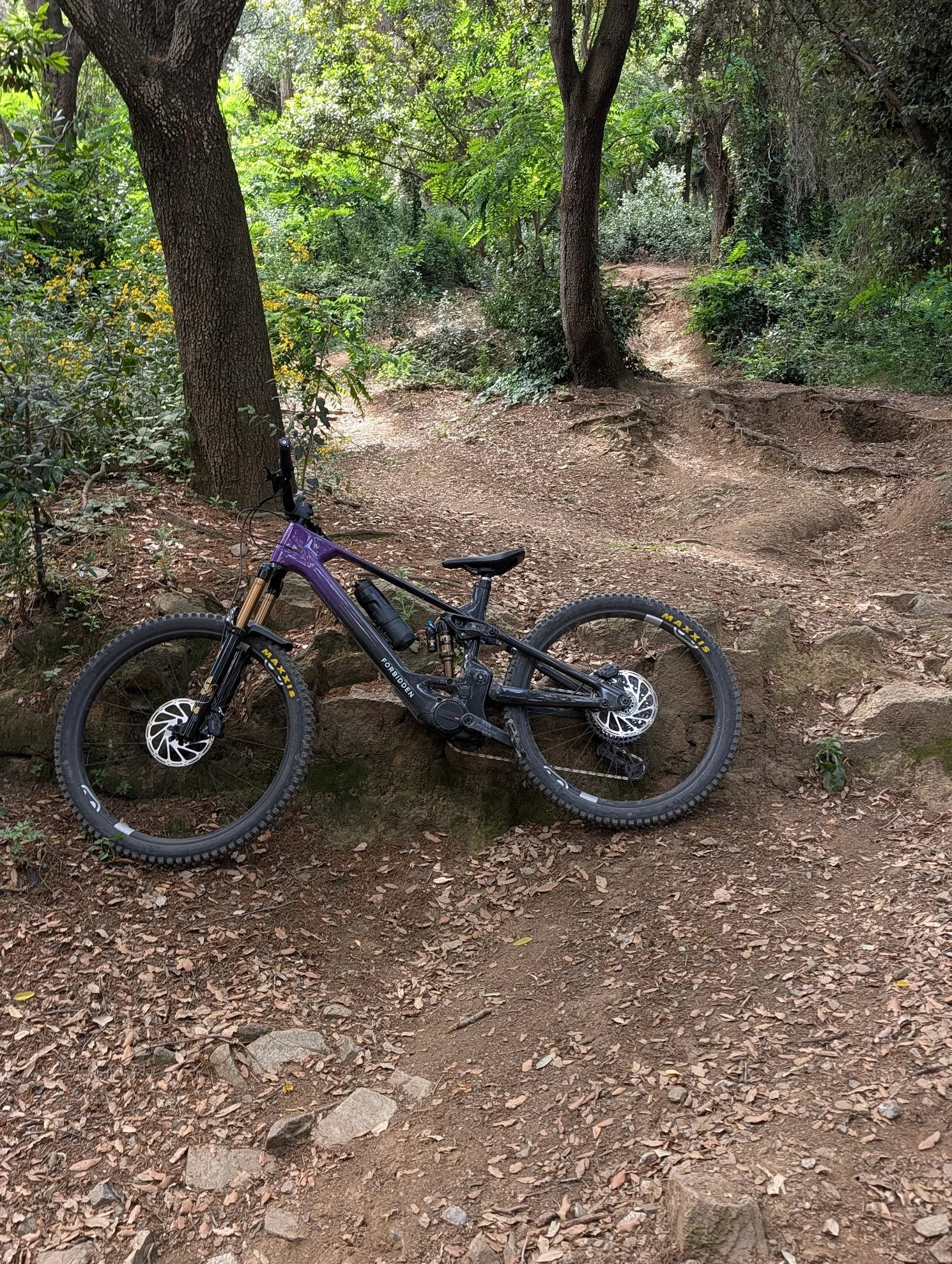

It’s straight out of the box. I was considering trying a 650 pound coil but since my sag is right where it’s supposed to be, I ended up just scratching my head. At this point I’m tempted to just throw an air shock on it and see how it changes.

Interesting. I definitely had the opposite experience on my bike, but again it has the coil and a zeb. For example, on flowy sections of trail with berms I feel like my bike sucks the life out of the momentum where the lte just flew through it and felt way more responsive and poppy. Frustrating and not sure what to do other than start other haha

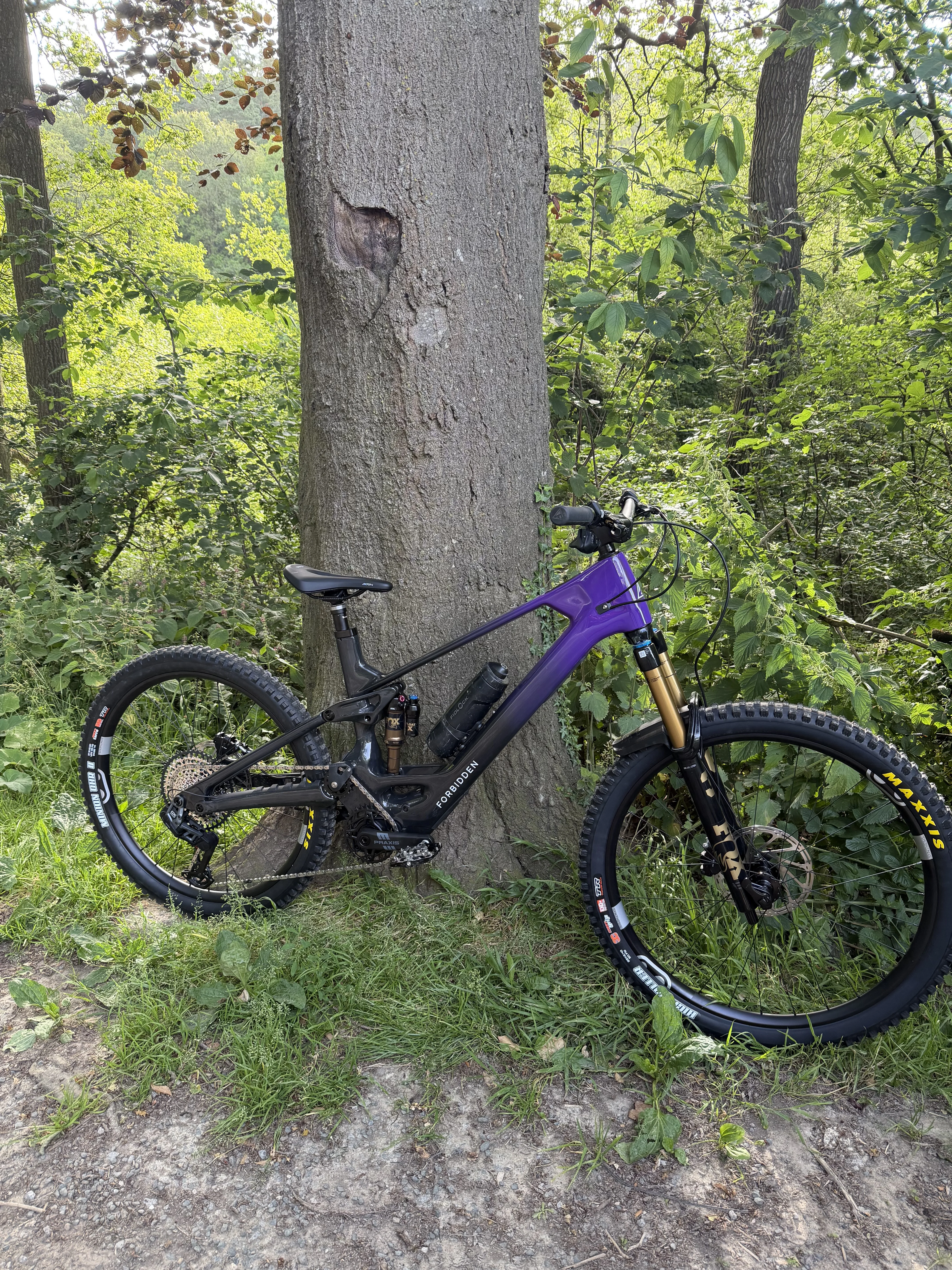

My Druid definitely doesn't ride like that with a Vivid Air. I was shocked St how poppy and responsive it was on tbe first ride out on it considering how long the rear end is

Good to know. Thank you! Maybe I just swap the coil and see what happens.
I guess the question now is what direction to go. Get a vivid air or something more lightweight like a fox float x or super deluxe? Any thoughts?

I’m leaning towards going with the new superdeluxe after reading it’s a bit more poppy/well rounded. I plan on buying a bigger bike for the steeper days(whole other convo dreadnoughtE/zendit/crestline haha).
Edit: pulled the trigger and am gonna swap the coil for a fox float x to mimic the current Druid e builds. I reached out to them and they were helpful in responding back. Thanks forbidden!
