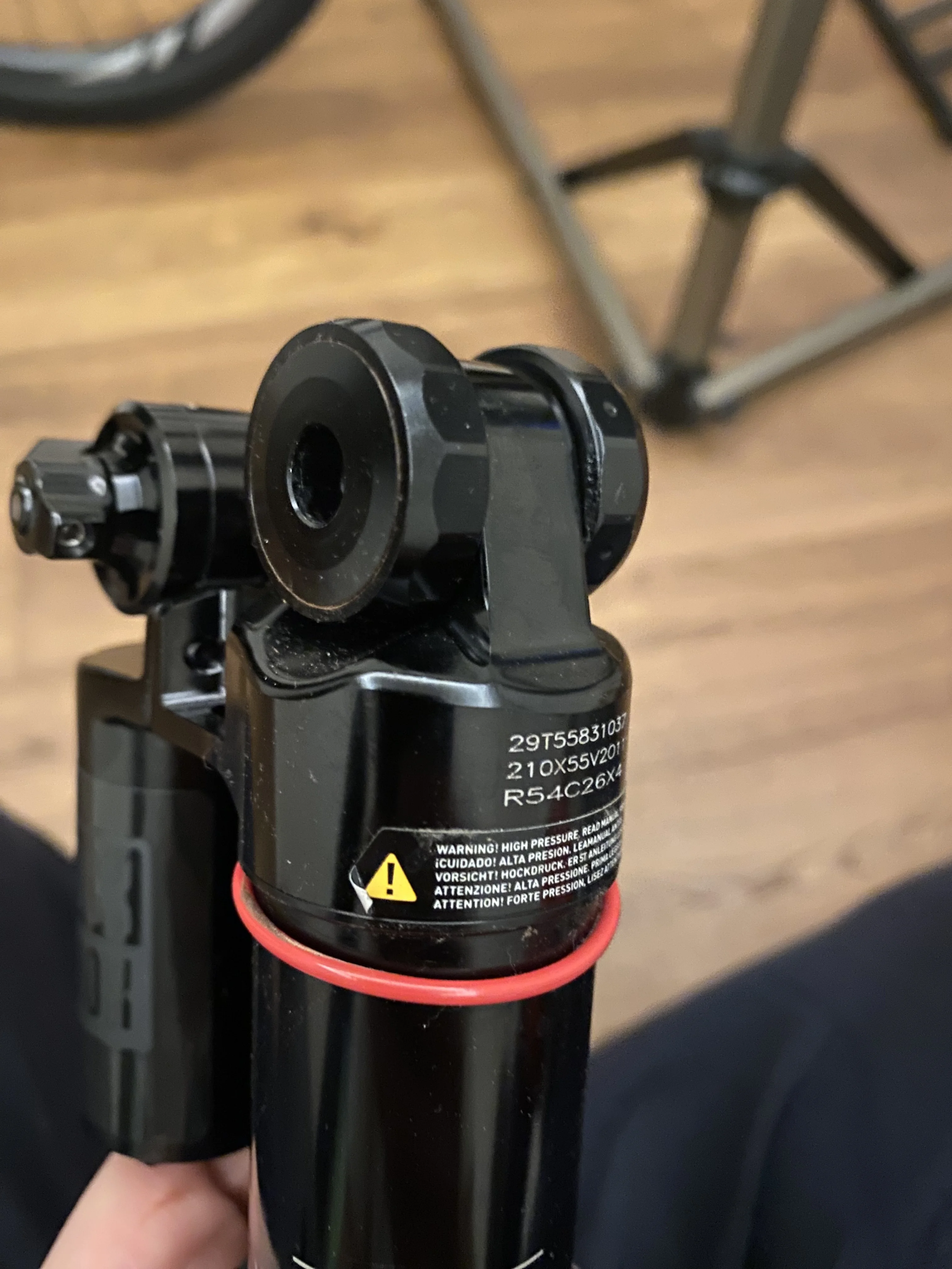

Hey guys…Can you advise me how to remove the bushings ( mount stuff ) and put them on another shock absorber (Ohlins ttx)
Thank you
It's basically like a nut and bolt - so hold one side (vice, spanner etc) and undo the other side (socket, spanner etc)
