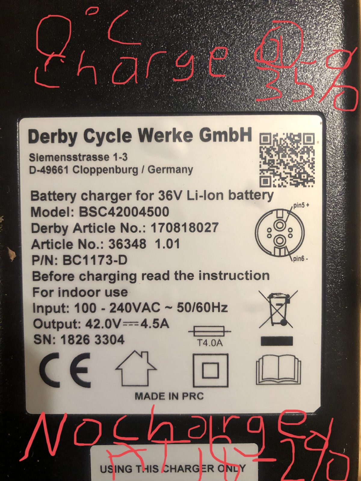

I just carried out the following charging test at 0°C I only have 120 V coming out of my wall socket in the United States so I don’t think it’s whether you’re in Europe or the US makes no difference .
My original charger which is pictured below charges OK at 35% battery 0°C

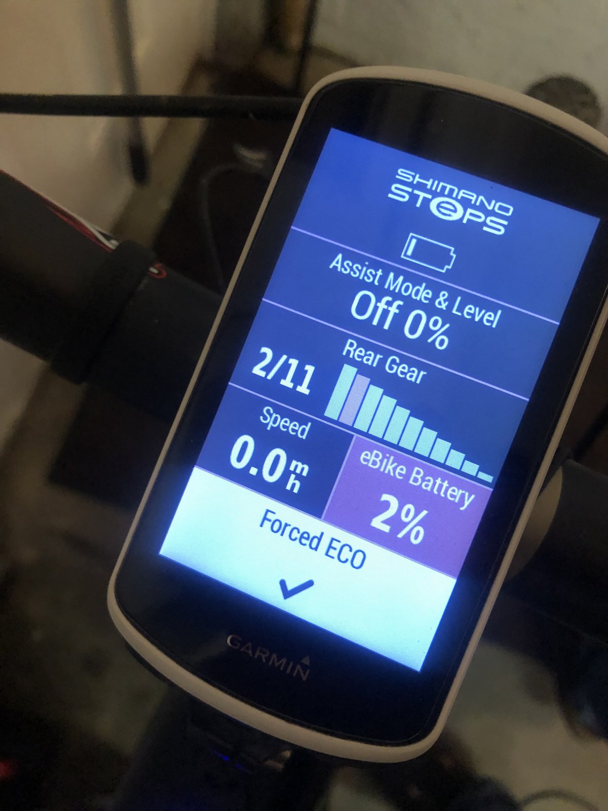

but it consistently will not charge at 18% battery or 2% battery .

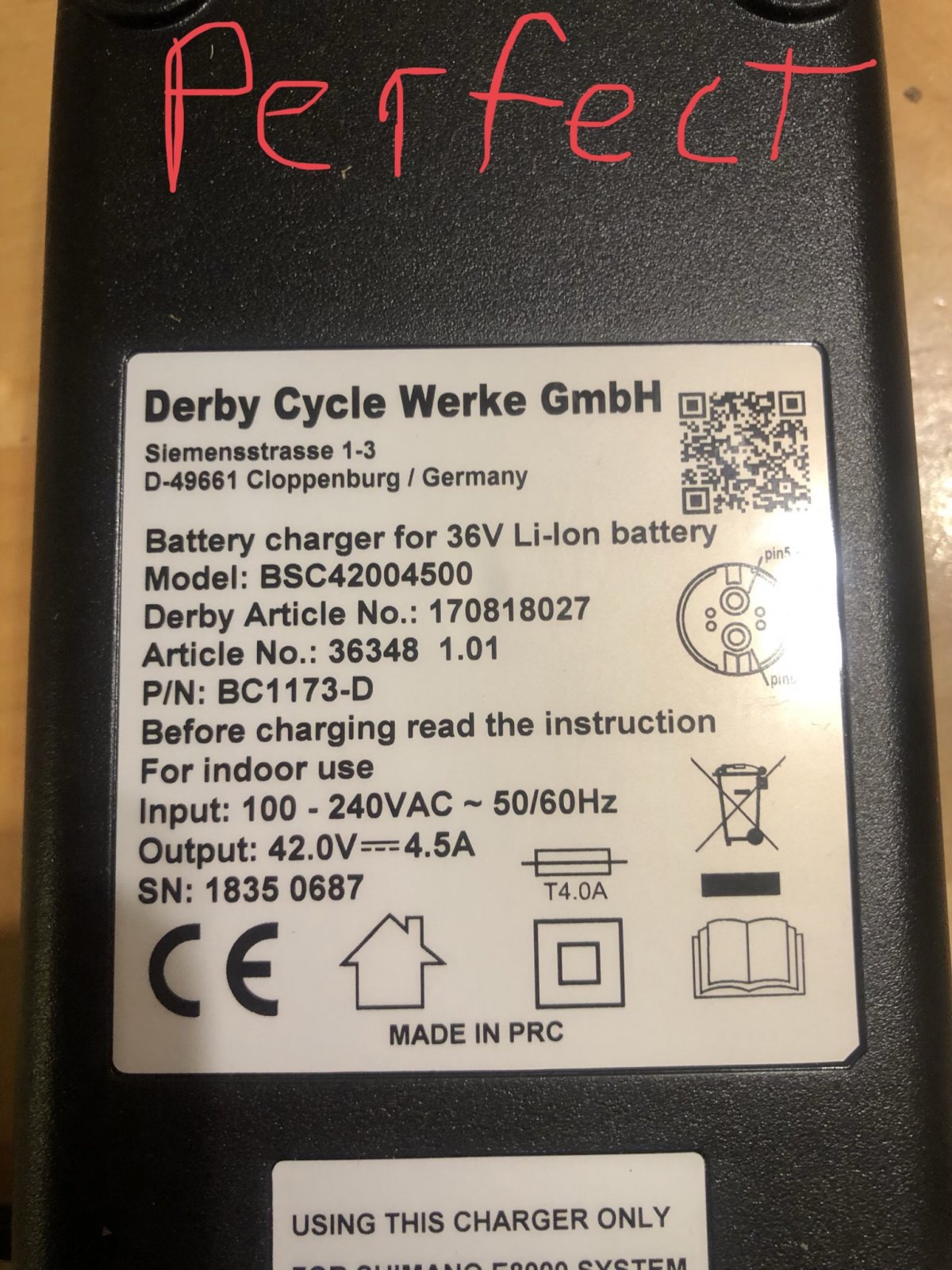

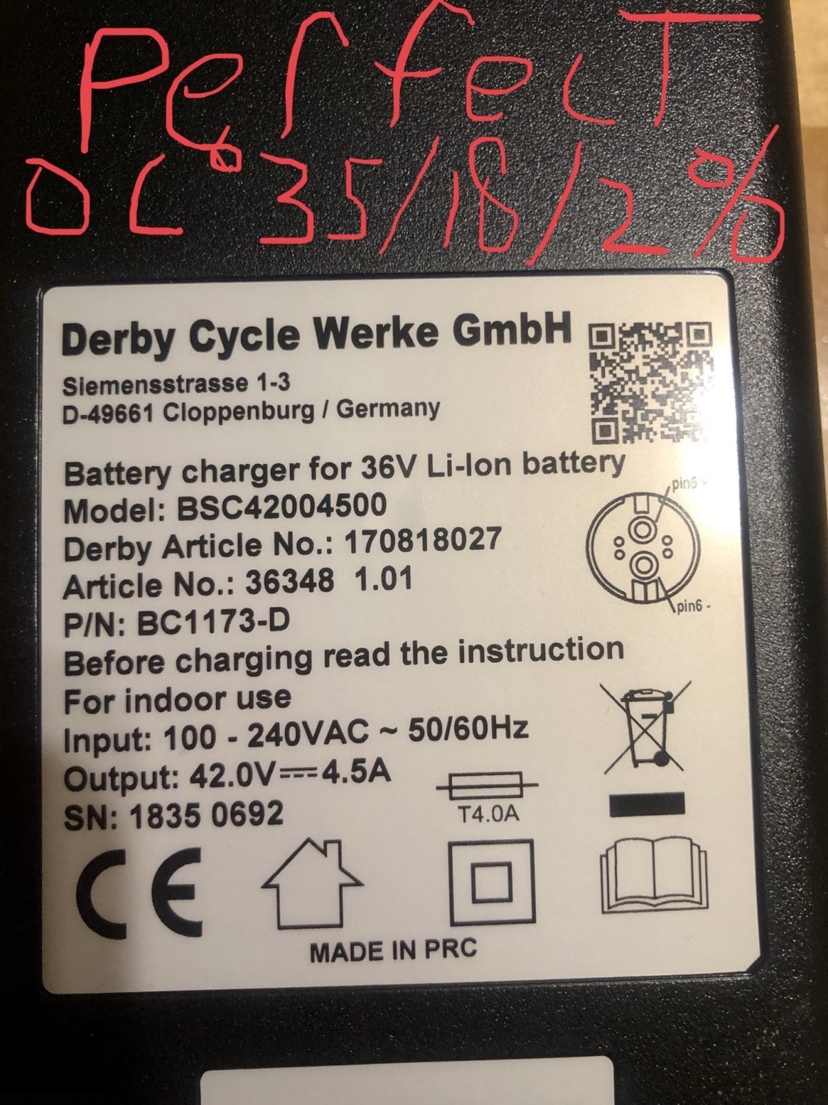

My two replacement chargers ,charge perfectly at a 35% battery at 18% battery and a 2% battery all at 0°C outside temperature .
Please compare serial numbers .
