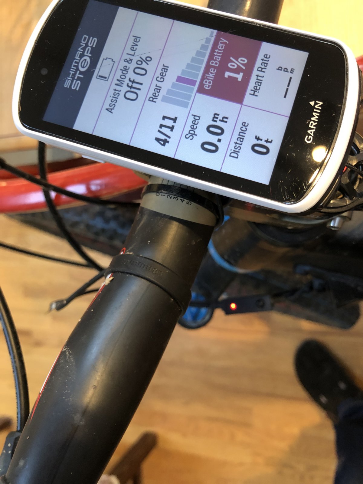

I brought my bike and charger in last night 67F or 19.5C temperature in the house.
This morning I attempted to charge the battery , starting with this condition 1% Ebike battery on my Garman 1030, Shimano
EW-EN100
The charger would do the eight or nine green flashes and then shut off , I repeated unplugging the charger all sorts of different ways and it kept on shutting off , there was no current (AMPS)being drawn through the AC input voltage , so I figured that the battery voltage must be too low as others have stated , so I ended up pulling the AC power cord high voltage from the charger every nine flashes waiting for a few seconds and plugging it back in after 10 cycles of this the charger started drawing 175 W and started charging properly 175 W Equals approximately 4 Amps at 42 V DC input voltage to battery, see picture attached . I also took the temperature of the charger about two hours into the charge and you can see it’s approximately 150°F or 65°C

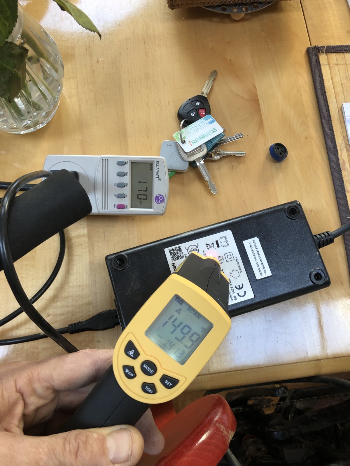

This indicates there are losses at the charger and the battery. Losses are generally 25 to 50% according to this thread .
How much energy is lost when charging a battery?
After the charge was finished I had used 400 Watthours of AC power from my house . See picture attached . I don’t understand why the numbers are so low if I have a 376 W hour battery to charge I would think it would’ve taken a couple hundred more watt hours ?
This all comes back to Steve Sordy earlier suggestion that the trickle charger is not working. The manual states see picture attached ,a 500 mA charge will occur if the battery has low voltage.
500 mA is .5 A ,my charger jumped directly to 4 Amps, my charger is broken?
The math breakdown as follows :
175watts divided by 42 DC volts equals
4 Amps, a A 500 mA trickle charge would equal 22Watts on my meter , and that never happened .

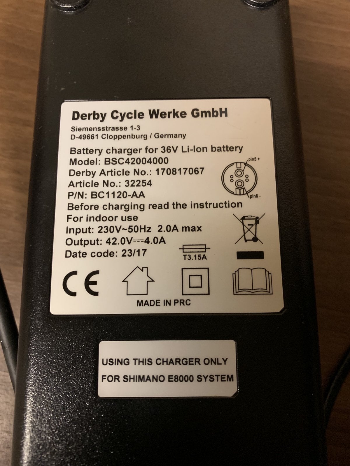

Yep, different. Mine is same make but model number ending in 4500 not 4000. My charger is a 4.5A current, yours is 4.0A. Yours was the one I used at Rutland Cycles that worked just fine on a cold bike.

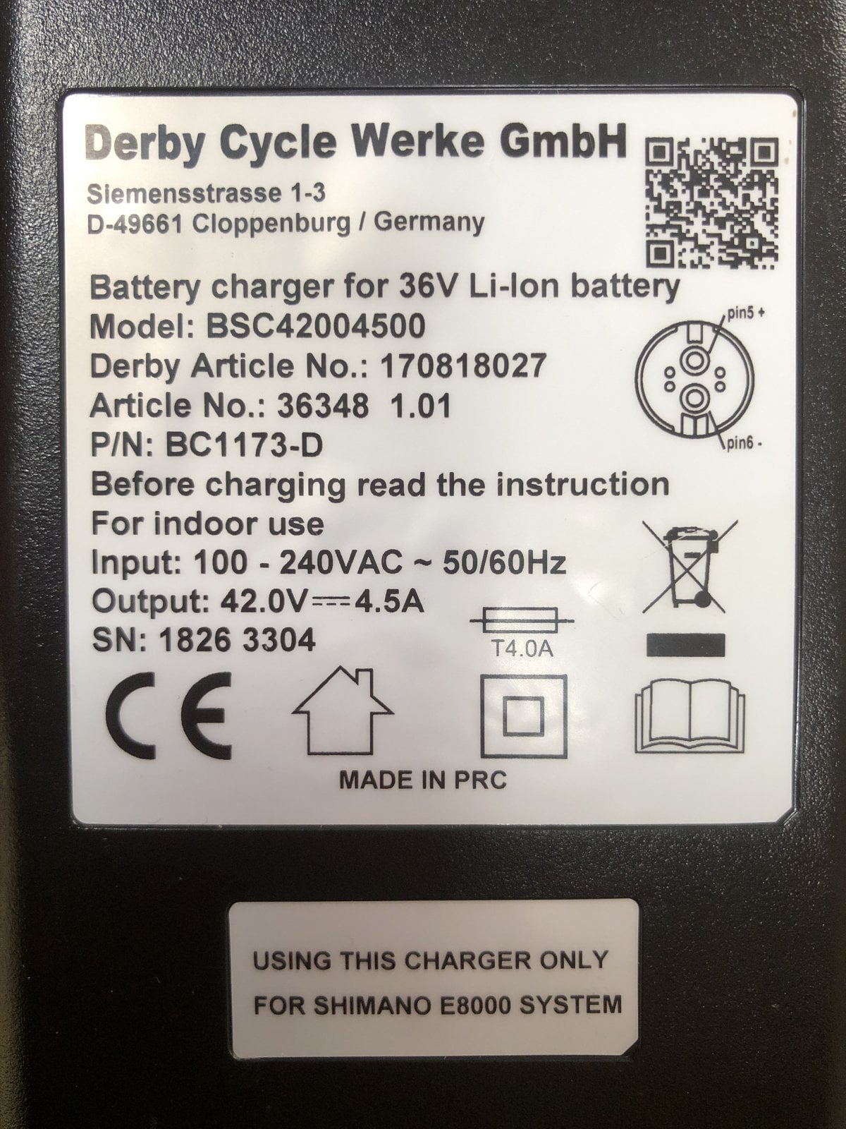

Steve I agree with you I have the same charger that you have that ends in 4500 that will not trickle charge as I’ve tested it on a fully depleted battery and the only way I was able to get it to charge was plugging and unplugging the AC power source from the charger at least 10 times , it finally started charging but it went to a full on fast charge it never went to the small trickle charge .
This is my charger. Guess it's a later and "improved" model.
