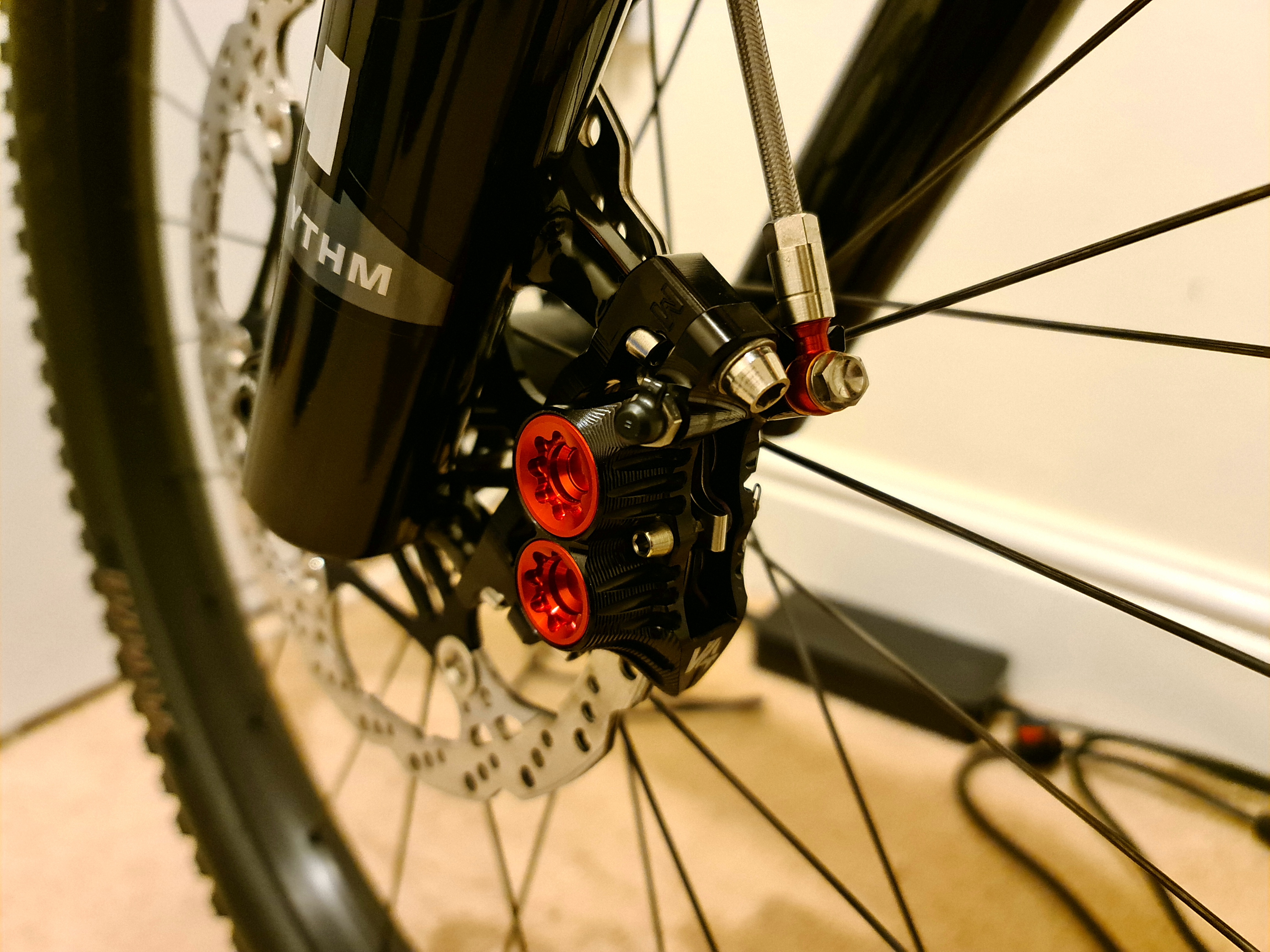

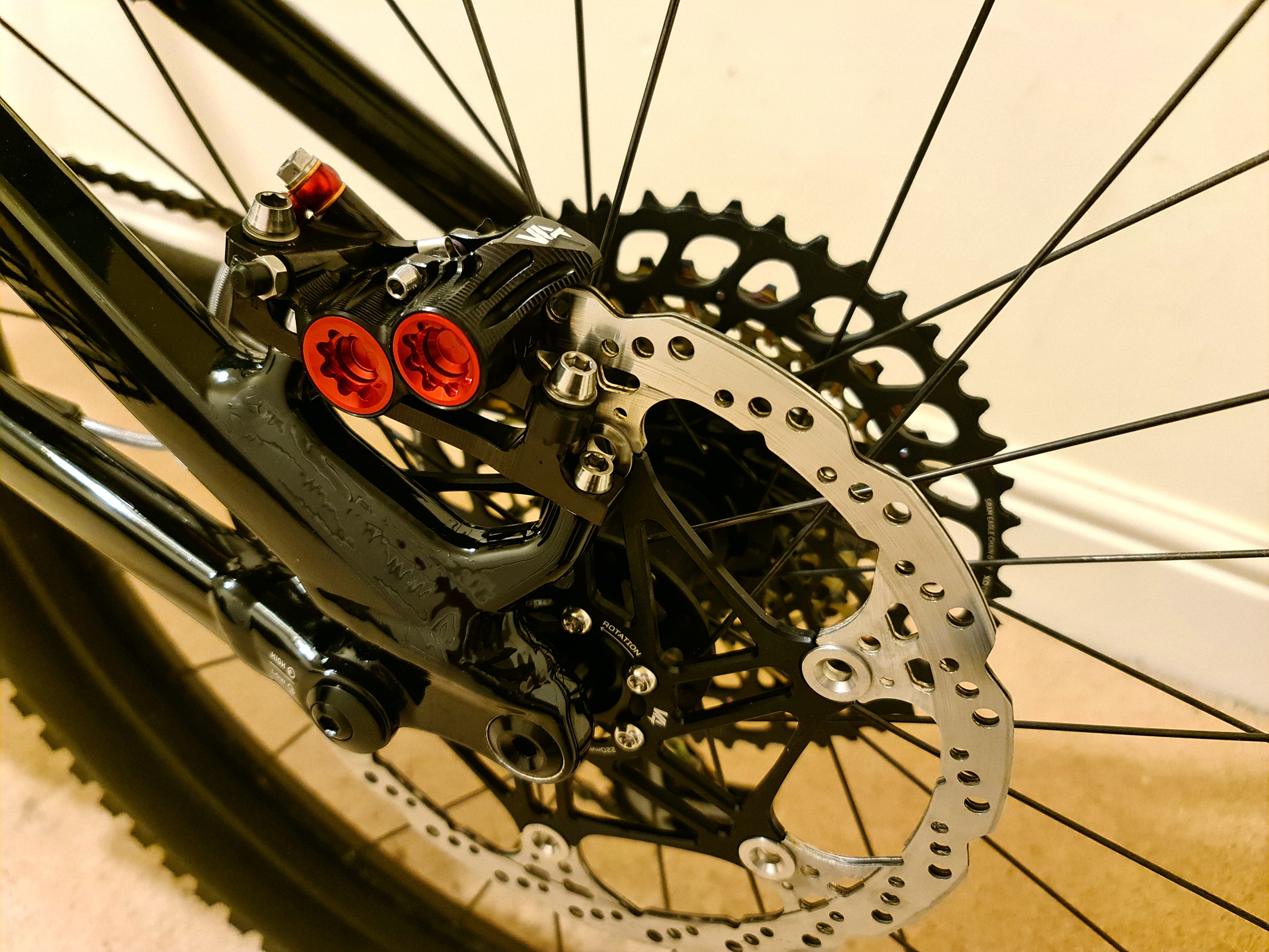

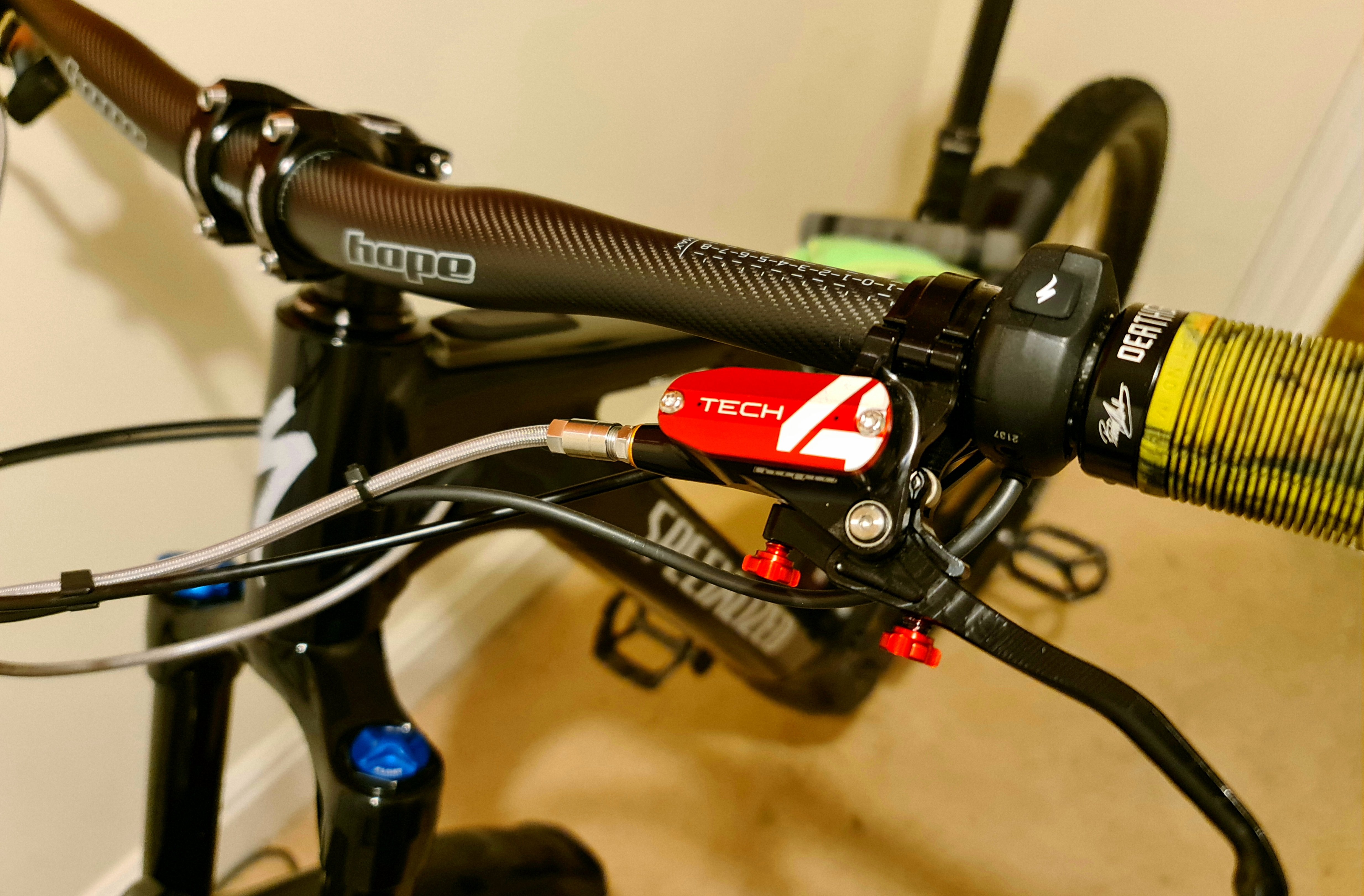

Just a quick update, brakes got fitted with no issues, great service from Slam69 and also picked up some F22 pedals whilst there.
Did a 8 mile ride to get them bedded in, feel night and day compared to the Code R.
