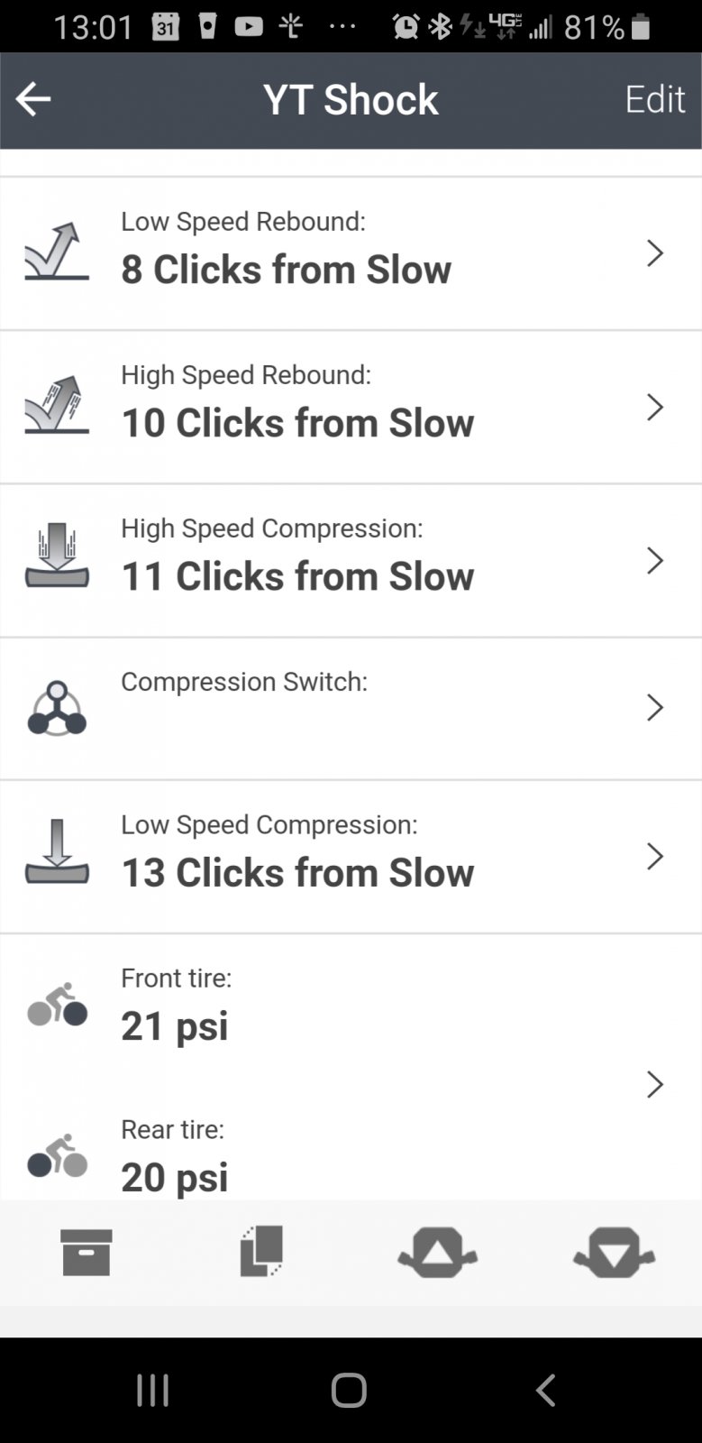

So here's a shot of my clickers are at 255psi (I'm about 220lbs all geared up to ride) with 3 volume spacers. I had 1cm left of travel but the trail had no big hits or flat landings. The trail had a bunch of imbeded rocks and harsh square edges lips and holes. I feel pretty good about shock...a little tweaking left to do but overall it's super nice.
