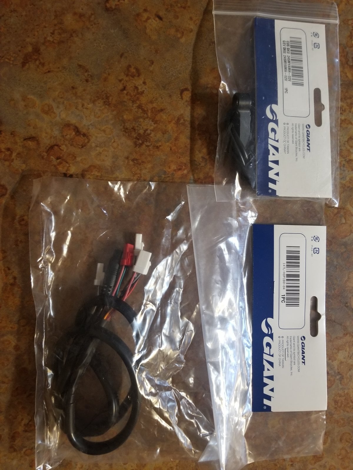

10-4. I've taped up the connectors and use a battery sock to keep things dry. When I told the dealer my sensor was cracked, they filed a warranty claim and Giant sent the harness instead of the sensor. Lol. Is this anecdotal evidence there is problems with the harnesses? IDK.
I bought the actual sensor myself and kept the harness. I'm still riding with the cracked sensor as my bike has not yet had an error.
Here is a picture of the harness FYI
