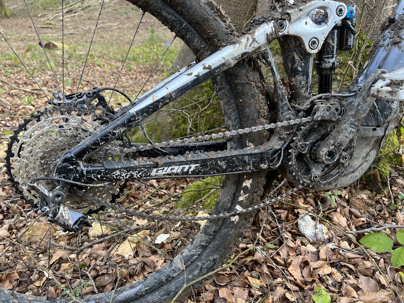

Went out yesterday for the first time in ages. Prepped the bike and set off all excited about getting out again after 3 weeks of feeling knackered after COVID hit following a ski trip to France late Jan.

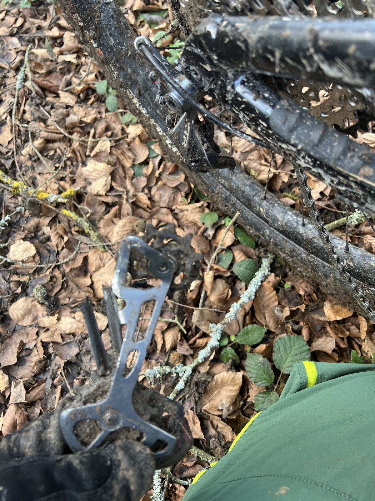

Was having a wail of a time until it hit a muddy trail which needed a lot of pedal effort. There were loads of post storm debris and I heard a big clunk at the back of the bike and then the pedals seized.
This was the problem:
My lovely XTR rear dear silent was toast…..this is the second time I’ve broken it….at £170-ish a pop I will be replacing it with the XT 8100 I paid through the nose for last summer whilst waiting for the XTR to come into stock.

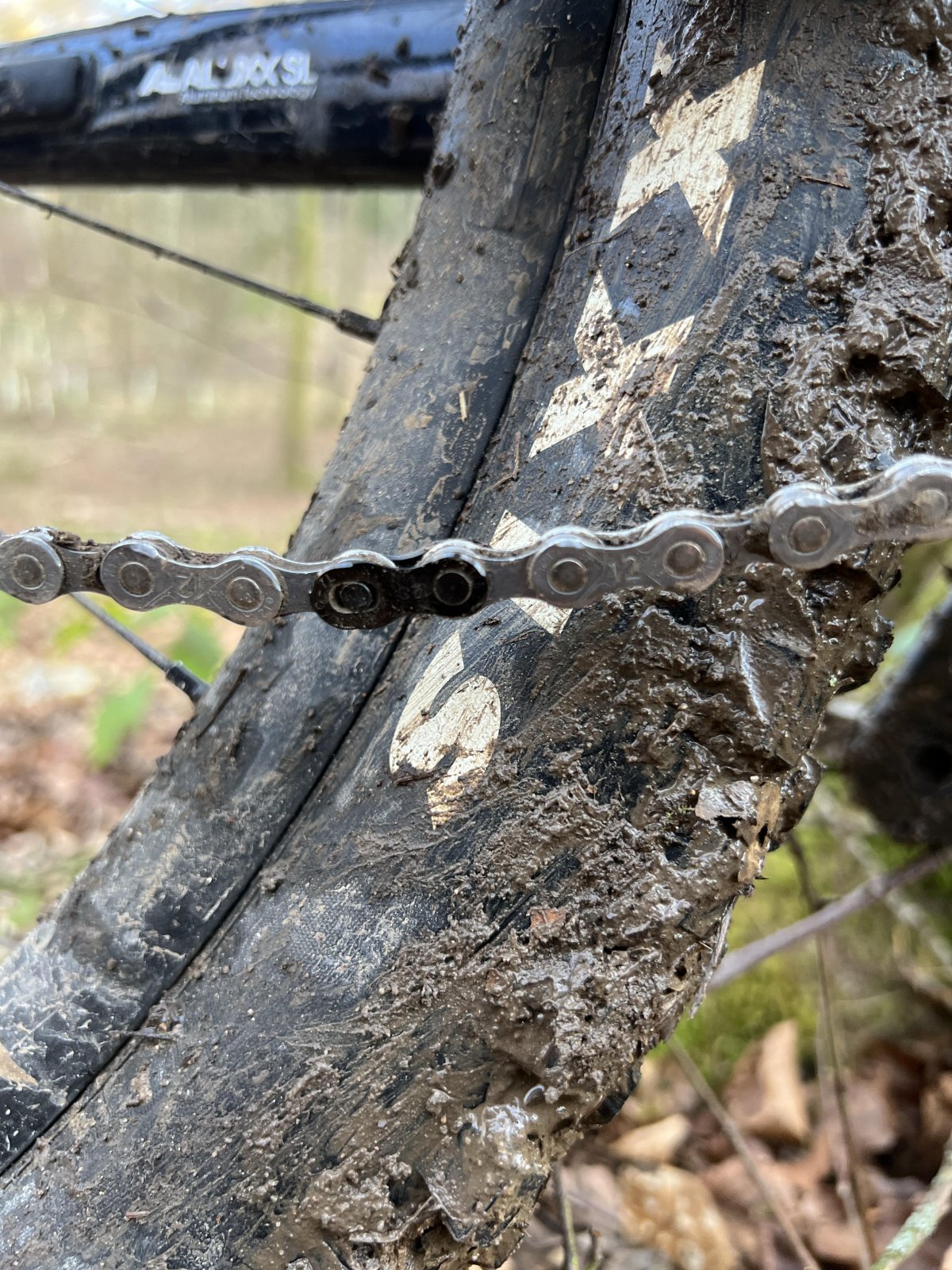

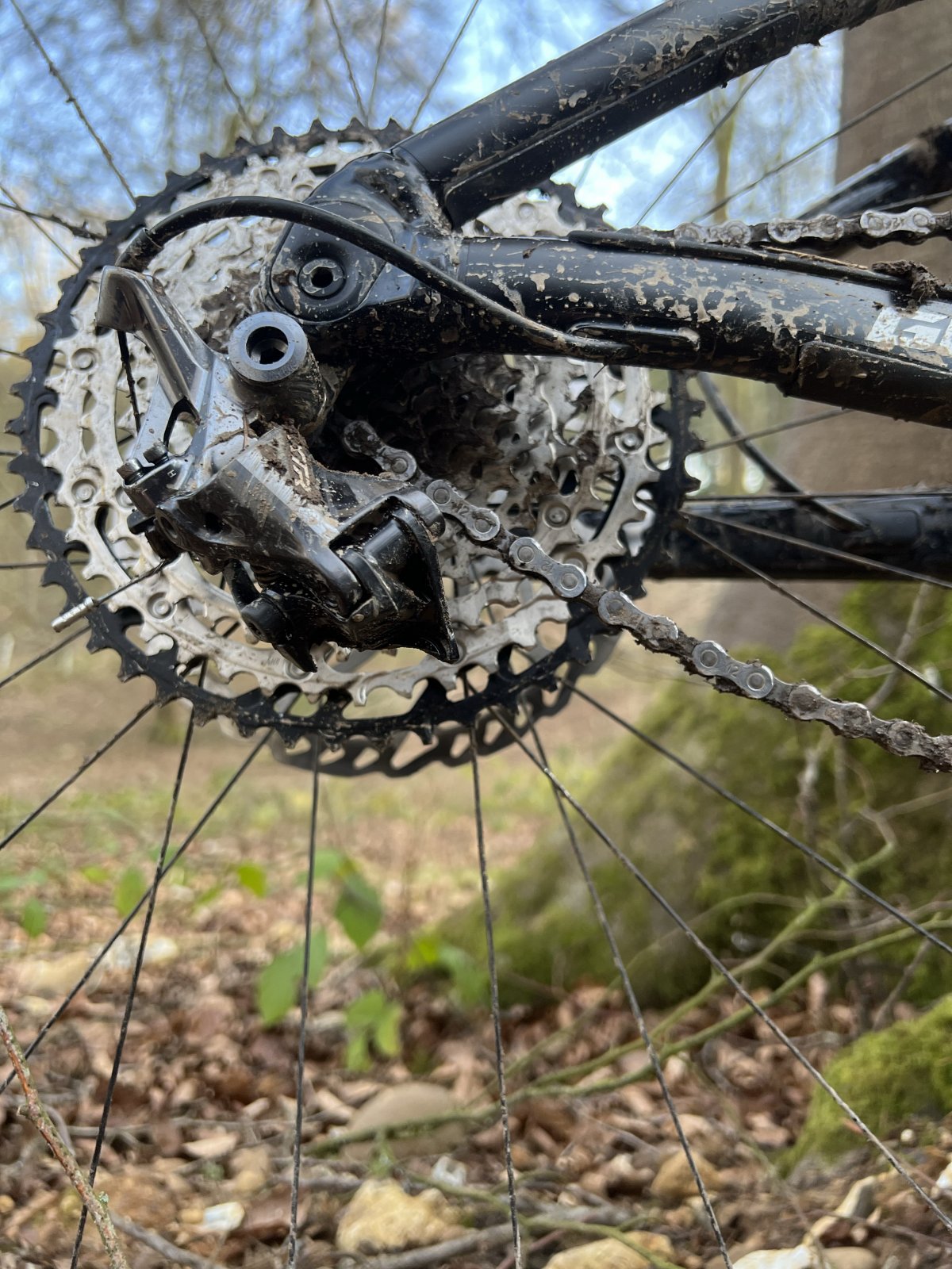

Chain was still intact. Clever me had a spare chain link in my backpack so I proceeded to shorten the chain to become and e-fixxy one speed.
All pleased with my self I started to carefully pedal home. I didn’t last long before it broke…. It at the spare link which I hoped but another link just popped. There was some twist in the chain which must have done it as it wasn’t at all smooth when pedalling.

Broke mine last week not sure what happened to be honest . Sheared lower cage bolt and bolt to hanger. Just got a cheaper one GX instead of X1 and surprisingly the hanger was only 13 quid. I shortened it and got home ok. I always carry a tool for removing split link i cant split a 11 speed chain with bare hands now for some reason.

Not sure if thats for me. But threads stripped in other cage and on hanger , derailier bolt stripped as well.

I would think the chain breaking was caused by the chain being stretched by the suspension? When the suspension is compressed while riding, then the chain would be pulled tighter? Hence why it felt rough when pedaling. Or is this not the case?
Definitely rear suspension stretching the chain. You have to lock out the rear suspension if you have to go single speed.

Woods been bad near me with small bits of wood always getting picked up by the wheels after couple bad storms 6 months ago , some trails still not clear. I broke mine on beach 4 months ago and never seen what did the damage hanger and derailleur. First time ive broken one and been riding since 86 so cant complain. A lot of debri i dont see so not easy to avoid .
